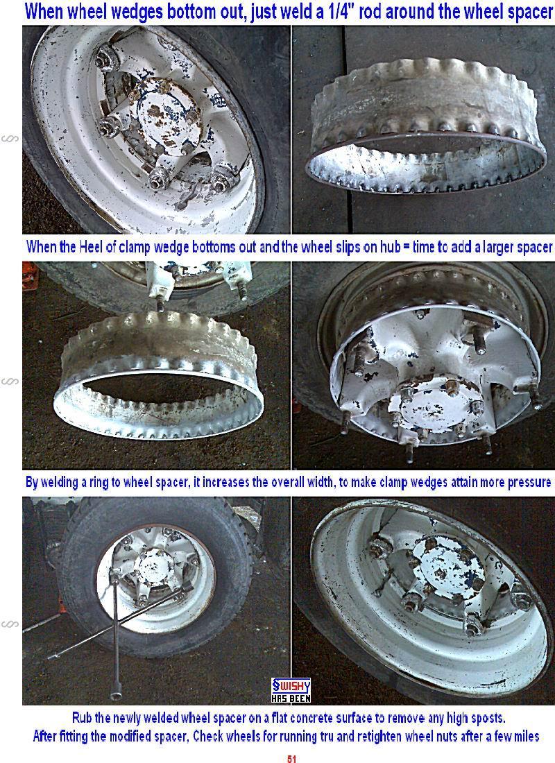

As for torque on the nuts that hold the cleats on, I reckon Swishman has shared the actual Kenworth procedure and it isnt anywhere near as tight as we might think
I've done some searching and so far found some directions on spiders from Swishman
Z2019FS47.thumb.jpg.842437359aea15524e4146d5008401ee.jpg.583c5daebc4410eec73023e71163851c.jpg
2019FS51.jpg.6e9f72b05c347ed53ec391d2db180025.thumb.jpg.b8301a815f4ed3ae05a8c46624ed4043.jpg
Im sure there's more but you get the drift
Tight enough they don't come off and not to tight that they strip the thread
And check every few miles after having a rim off, 3 or 4 times and check they are tight
This isn't exactly rocket science
Paul
