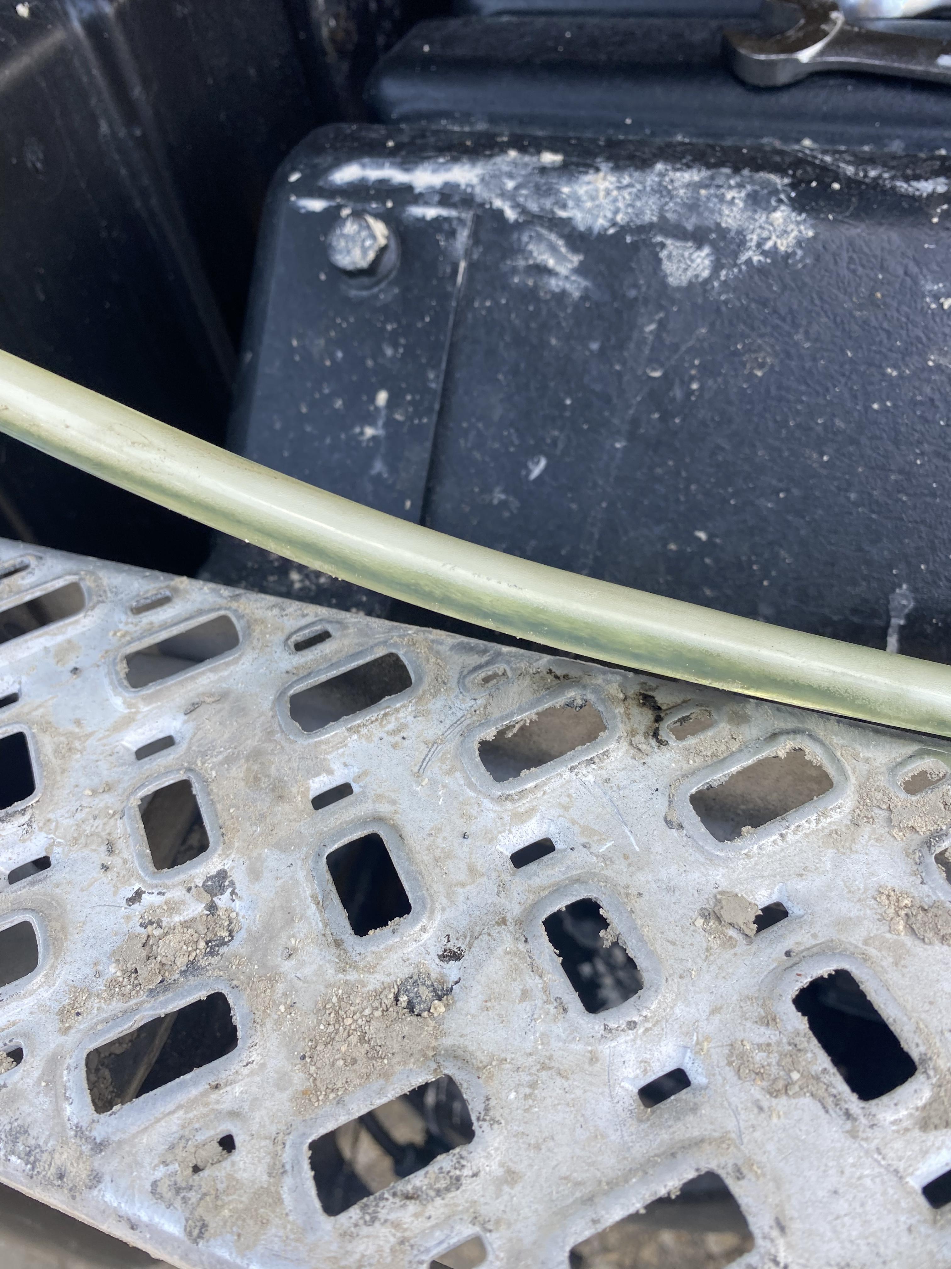

Ok here’s the issue I have a 2014 with the mp8 having problems starting up truck in the mornings . Once it’s on , drives good and if you turn it off it starts right back up . Today I did something different I primed it from the fuel filter housing and it started right up . Also I  do have bubbles coming out passenger tank return line I believe it is the return line . What could be the issue? Cups,  injector , or fuel filter housing . Thanks

Start with a clear hose at the fuel return overflow valve at the head to the return at fuel filter housing. Check for aeration. If you have aeration you have bad cup/cups. If you don’t, which I hope is the answer then we can start to look at things like a fuel filter stand. Do you happen to have a davco filter on the truck?

I don’t know if it’s davco filter housing or not it has the Manuel primer pump that comes out when you twist it . Ok as soon as I get a change I’m going to run that hose from the head and see aeration .

Just an observation when doing that test our guys would also watch for an intermittent large bubble passing down the tube every 6 to twelve inches! The foam is not a firm indicator! when a bubble passed by your assured its cups!  There is always some fine bubbles from what I observed!

My engine starts and runs it’s just when I shut it down has hard time starting back up . Have been getting less response and shake or vibration up hill .
CUPS !  It will only get worse! Mackpro nailed it from the get go in my mind!
