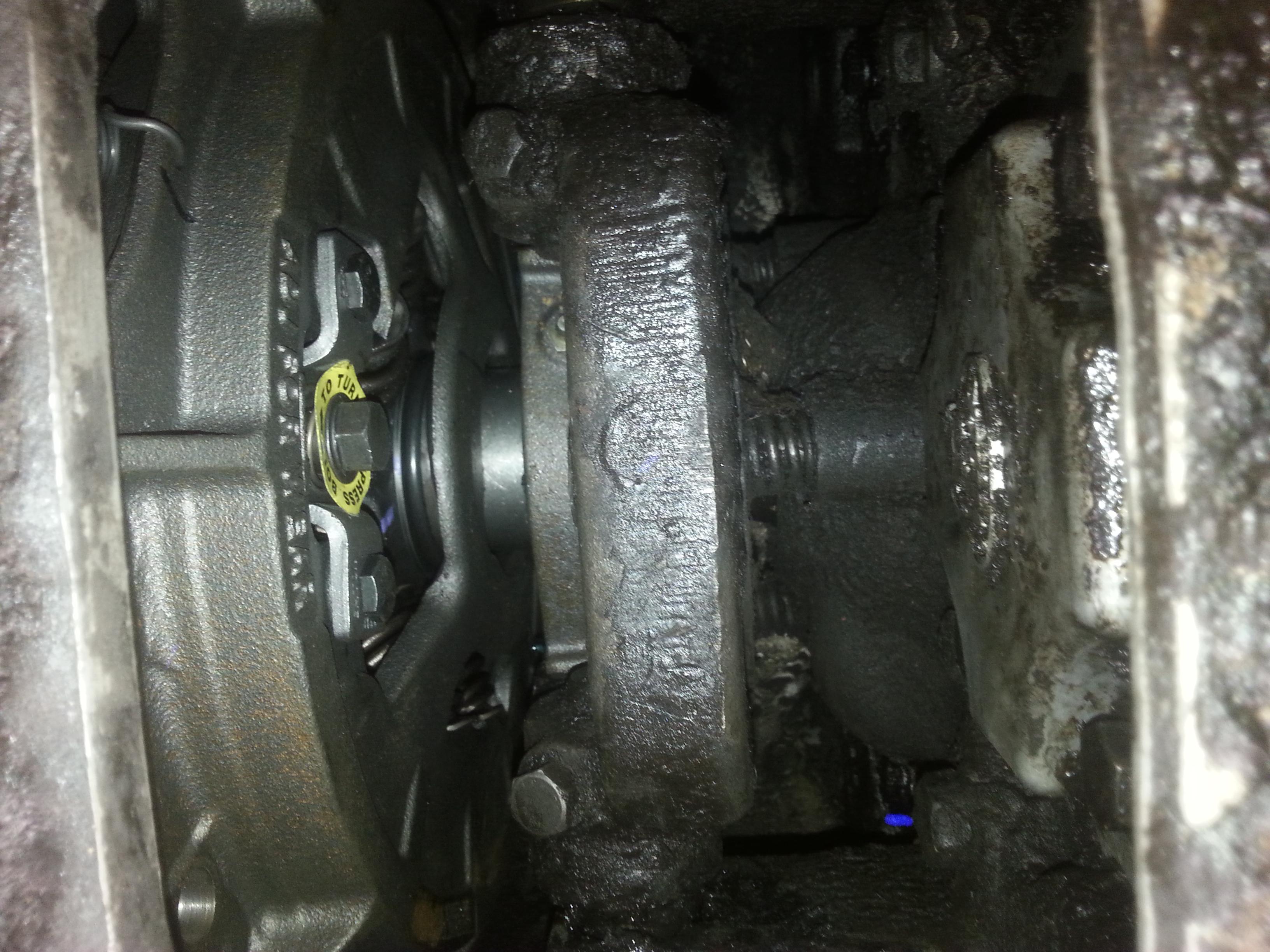

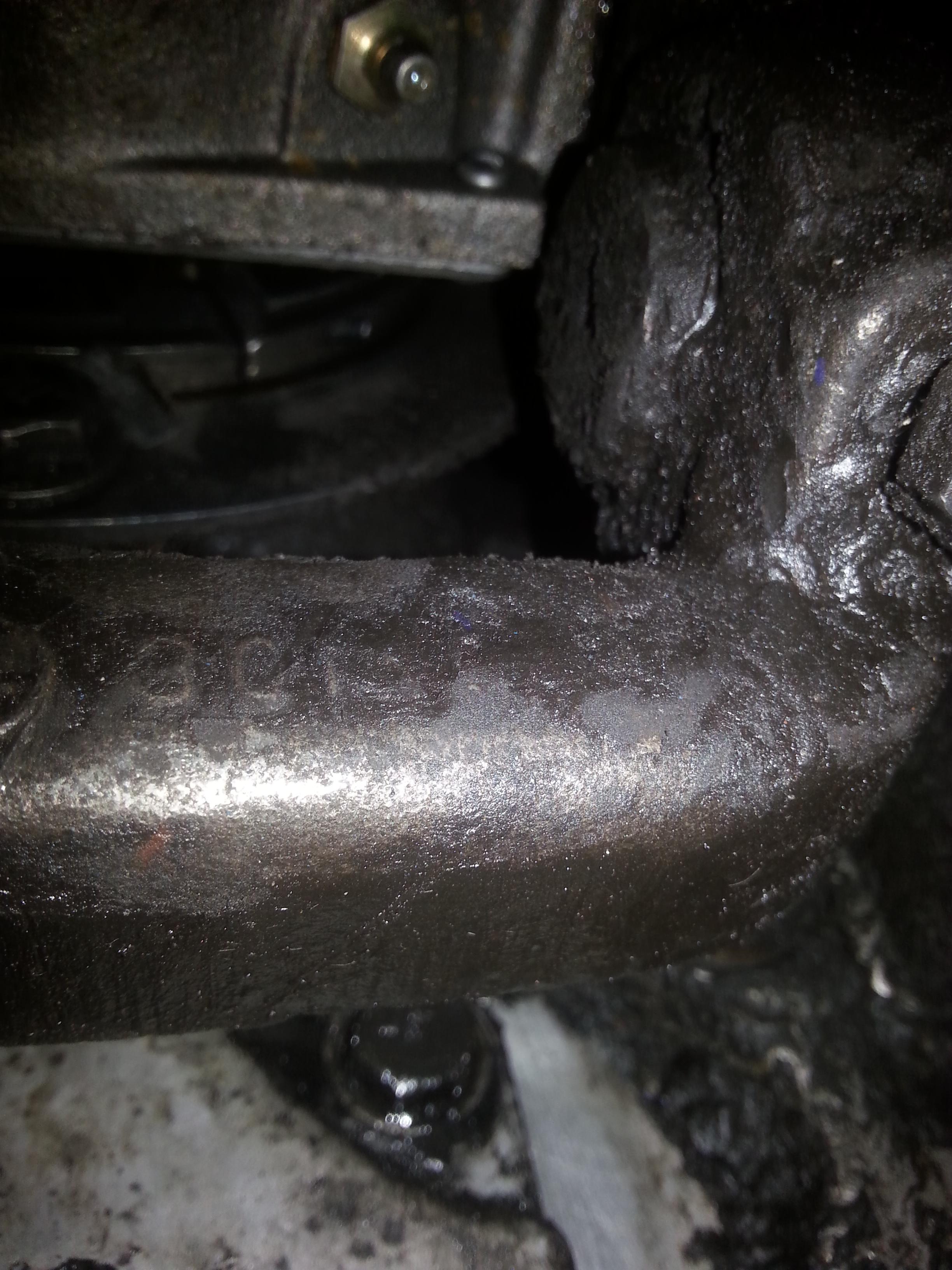

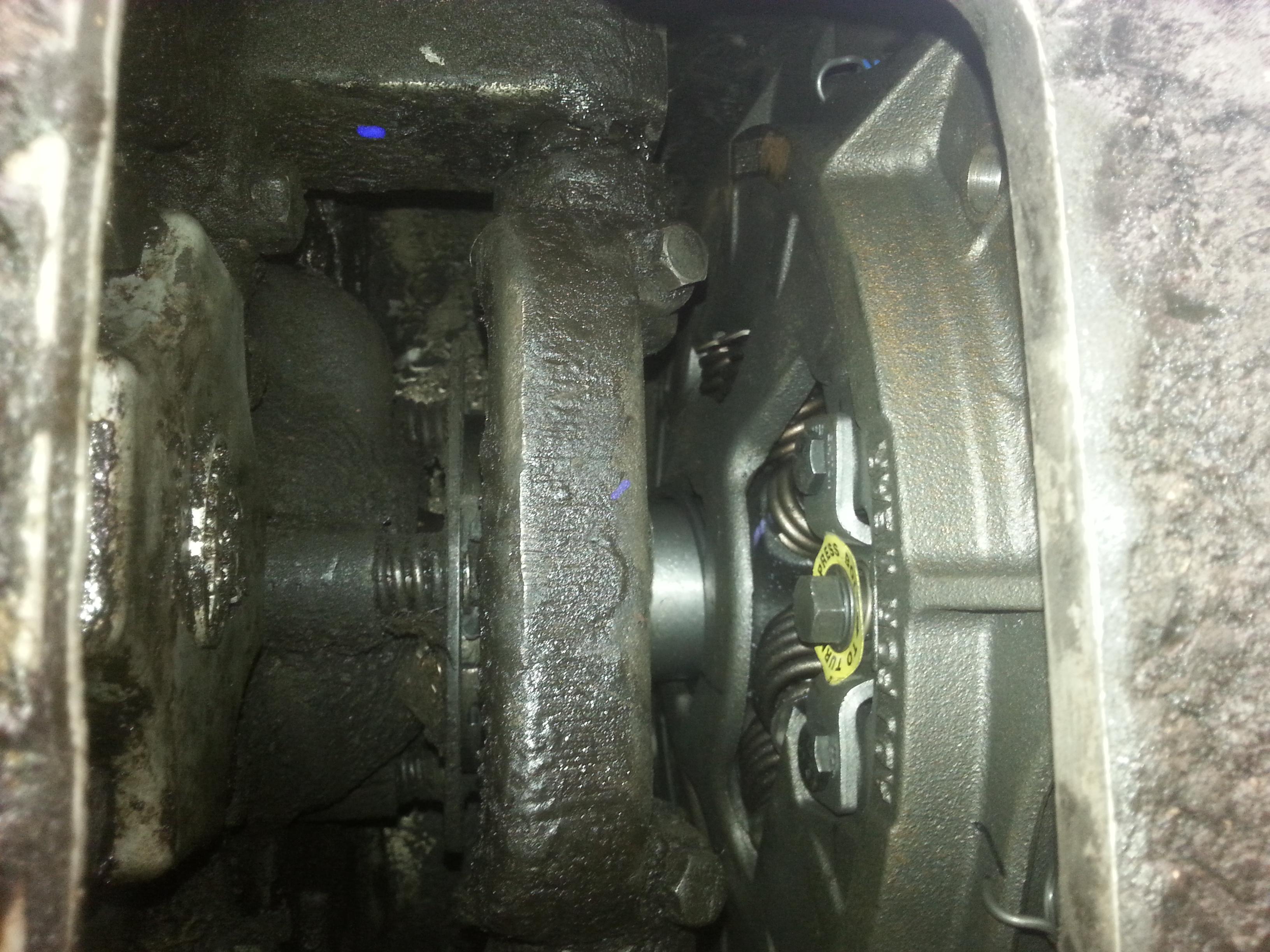

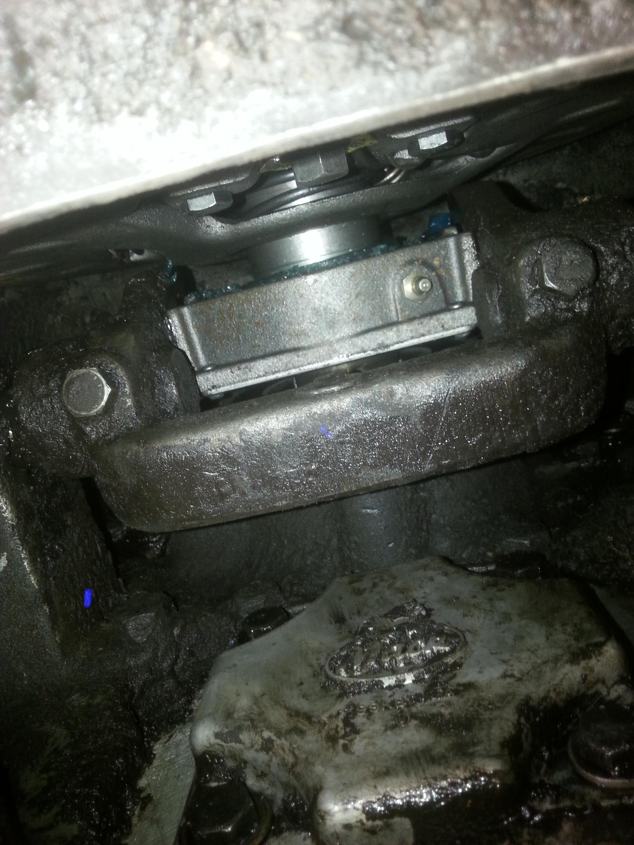

Ok so, I blocked up the rear of the truck, plumbed in my service brake lines.  With the engine running and the transmission in gear and spinning the driveline, I can apply brakes until the truck wants to stall (no clutch slippage occurring), then while maintaining steady pressure on the brake treadle, I step on the clutch and can stop the driveline.  Then release the clutch and start it spinning again.   So there is SOME disengagement however it's not fully disengaging.  There is still some audible load on the engine as it still wanting to spin the driveline but I have the brakes applied.   The instant I release the brakes the driveline is in full swing again.   I rough housed it a bit on and off the brakes with the clutch 2/3 of the way depressed etc.... and im now pretty sure nothing is "seized" from sitting in a damp environment for a few months without use.
Here are some pics with clutch applied, clutch released and linkage disconnected and pulled back in the last 2 pics to view the clutch brake.  You can kind of see it in the last pic.  The back side of the clutch brake (closest to the trans) has got some noticeable meat worn off of it, probably from me trying to get it working over the past couple days.
I adjusted the quick adjust +/- a few times while doing this and no real difference in results.
I don't know, I guess im pulling the damn transmission again......

100 thanks for pictures ; big question is WHERE'S THE CLUTCH BRAKE?  when you say "gave it quick adjust"  = do you mean adjust from outside linkage? thats for clutch brake.  the yellow tag on pressure plate (5/8th socket) is for adjusting clutch.
https://www.bigmacktrucks.com/topic/70511-235-swap/page/4/#findComment-533154
Thanks for clarifying what term is for what when it comes to adjusting.
I adjusted the 5/8 adjusting bolt (w/pedal depressed with a 2x4) to the point of having more then 3'' free travel in the pedal to almost no free travel.  Equating to +/- 1/2'' gap between the TO bearing and the clutch brake.  I use a piece of 1/2'' round stock bent in such a way to fit around the release fork to make that measurement.   I also adjusted the external linkage rod.  Neither of which made a noticeable difference.   I have messed with both adjustments lots over the past couple days, but messed with them again during this test with the wheels off the ground so I can run the driveline.
