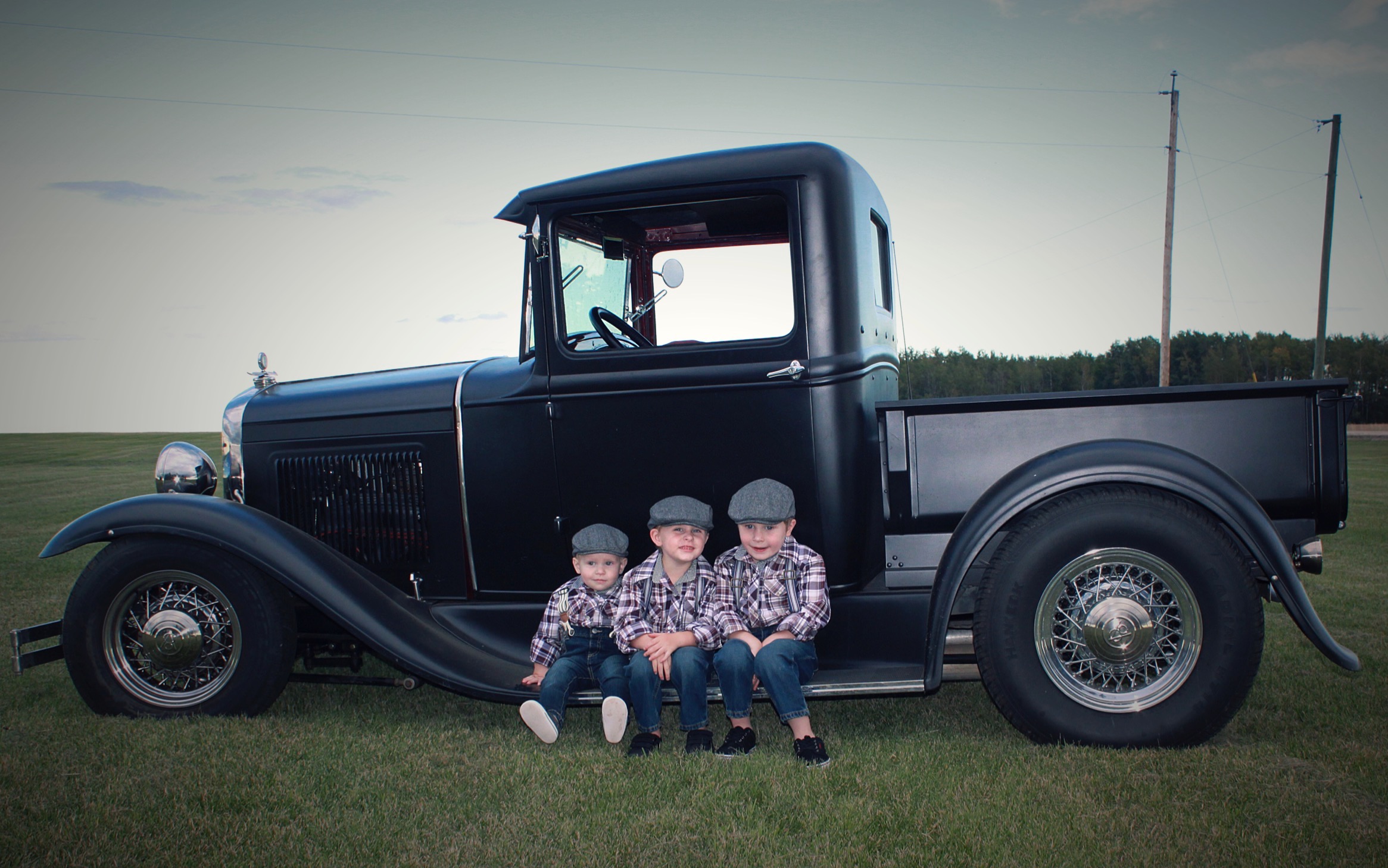

IMO, tire "pressure" is just a convenient way of adjusting the tire for proper squat. With tractor tires, they are specifically aired to a specific squat and only show a MAXIMUM pressure not to exceed. I will be setting my pressures the where the tire LOOKS right and whatever that pressure is, that is where I will run them (I suspect that to be in the 40PSI range but don't know yet). The comments about wheel base is just a fact of life. Short wheel bases will never ride as good as a long one, EVER and a single will never ride as good as a tandem (all other things being equal). In my Model A truck with coil overs in the rear, it was brutal riding with the standard 32PSI in the rear tires. I lowered the pressure for the proper squat (around 18PSI IIRC) and it rides better but with the short wheel base it will always be a lumber wagon for ride. My "B", with it's 156" wheel base will buck but with the b"proper" air pressure in the tires and not much air in the bags it shouldn't be TOO bad. Planing air ride on the steer axle as well. 1E95182A-D781-4BA4-BACB-FC8698E00E10.thumb.jpg.240ee625445ca51230d51459c8f5cc8a.jpg
