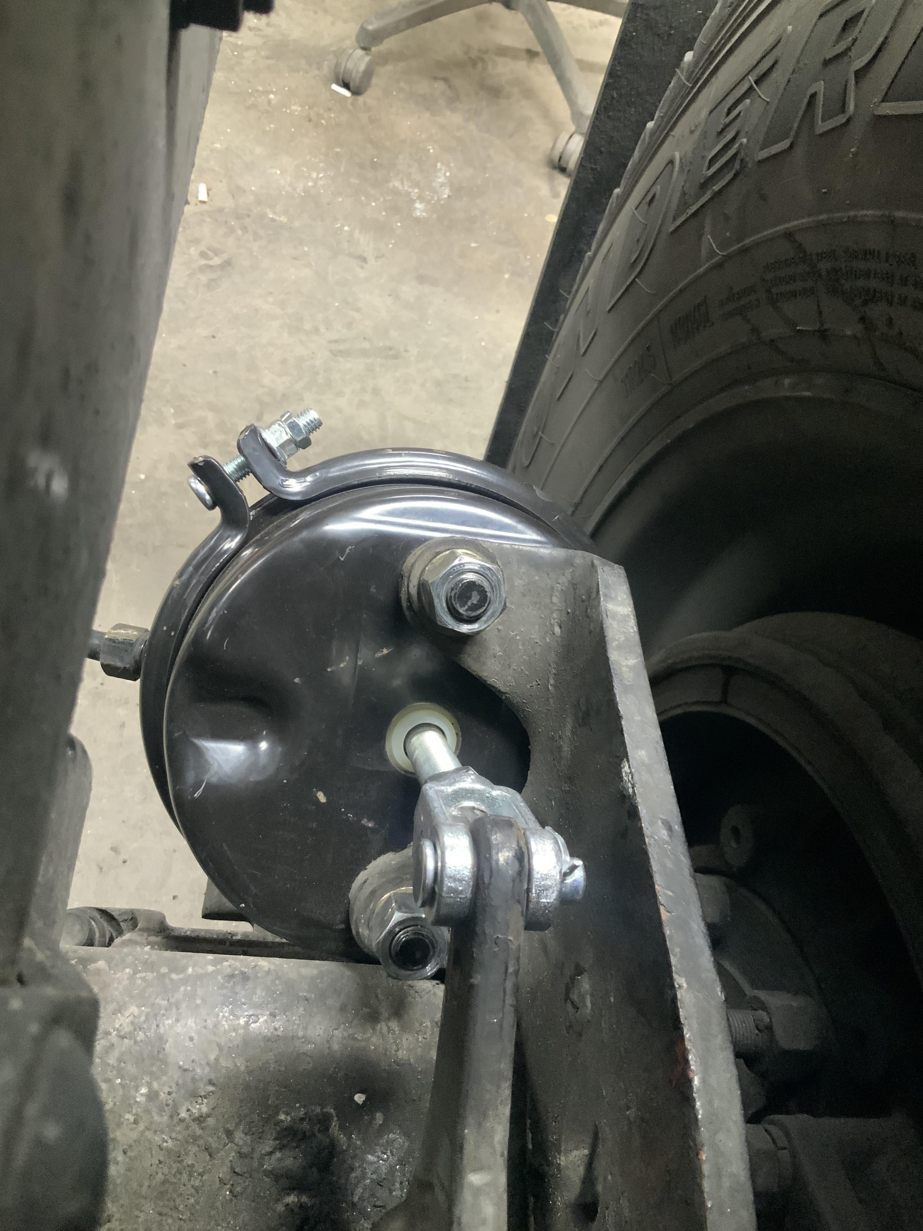

I've noticed the front drive axle is wearing brakes far faster than the rears. The rear chamber's  are 24's?  and the fronts are 30's. I have not seen this before.
Assuming everything is working properly uneven wear makes sense. Bigger chamber more preassure. Truck is an 85' R688st. Is this right or have they been changed out incorrectly? If so which ones are wrong? Any thoughts?

After going to three different parts stores I found a set of 30's with a small wedge built into the housing that clears the axle.
My wife told me the story of her father replacing the front 26/26 chambers with 30/30's because they were cheaper some 15 ish years ago. So now I know why the front tires were cupping and the front brakes were worn out.
Once again thanks for the help.
