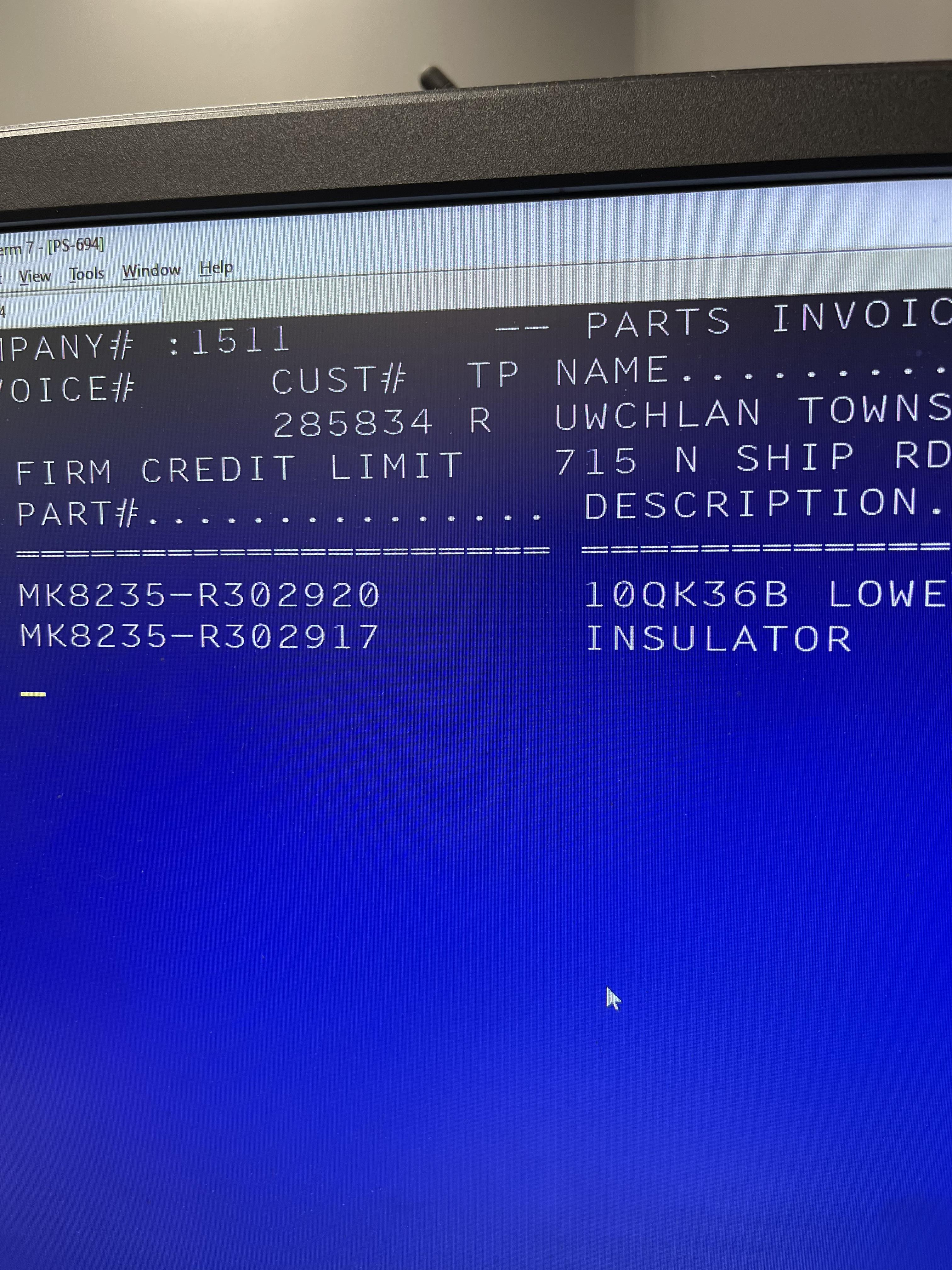

I can look up the part number tomorrow for you. If you decide to get the polys you can just go with getting them for the bottom and you can do the rubbers up top if you wanted too. The bottoms are what get all the weight/movement. Make sure you get all new hardware. I’m sure you will but you would be surprised at how many don’t.  Also when taking a part make sure the round locating “tit” on the spring “T” is still in good shape. If not the springs are trash. A lot of times they get rusted and worn down to nothing.

That would be awesome, thanks! Last 6 is 067250, I can get the whole vin tomorrow if you need it. Was definitely planning on new hardware, nothing comes apart easy on plow trucks, will check those other things as well.

Don’t use the MK when searching also the meritor part number is from the “R” over. Mack uses meritor anyway. But that whole number is a Mack number for YOUR truck.
