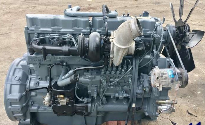

I would change the color to resemble the one pictured below. Something about the maroon and silver (I think the valve cover is gray now) just seems off. I have no clue about the mechanical design or features of the engine as the newest diesel engine I own is a 1994. The one MP8 I did drive ran and pulled like a freight train compared to any Etech, AI, or AC I was ever in with similar specs. Serious question: are the MP8 and Volvo D13 mechanically identical engines? How much different really is the software programming?
Only thing different is the paint and the software programming is pry a little different depending on the truck. Id be curious to how those MP10s and the ones that were compound turbo ran….Even the MP7 was a rocket. That 13 liter MP8 at 505 hp and 1,860 ft/lbs is right up there with those 15 and 16 liter engines. Pretty damn good I think
