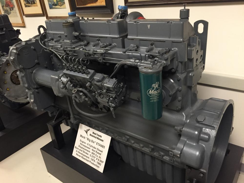

Never made it to production. It was 885 cid. Bore and stroke was 5.375”X 6.5”
Well That's My new thing for Today learnt...Wonder Why It Never Made It to Production..??
Looks like E9 Rocker Covers & maybe Heads Too..
I believe you are correct. I think it used a lot of the E9 components.

The E9 had its issues!  Valve seat issues  / Lifter/ Cam failure, head bolts would break head gaskets leaked.  piss poor engine brake this is a case of failure By design the brake as we all know has always been sort of ho hum on most Mack engines up till the power leash  , water pumps failed a bunch at the begining! As usual Most of the issues resolved Before the end of the run on these ! The other weak point on these was the counter bore ledges would sometimes crack ! In my opinion the head bolts were under sized An really should have been fine thread and or studs! Thinking back on it How ever the 866 had fine bolts and they would leak also! they also had the liner ledge issue!
If the big Six had entered production I would have hoped they would have used the E7 style liner set up but who knows ,it never got off the ground! also notice they left room for the econovance there in that design they were a forward thinking bunch of guys! But they were working with stuff they mostly already had they were working on a budget in my mind! That's likely why it never got finished! Money constraints !

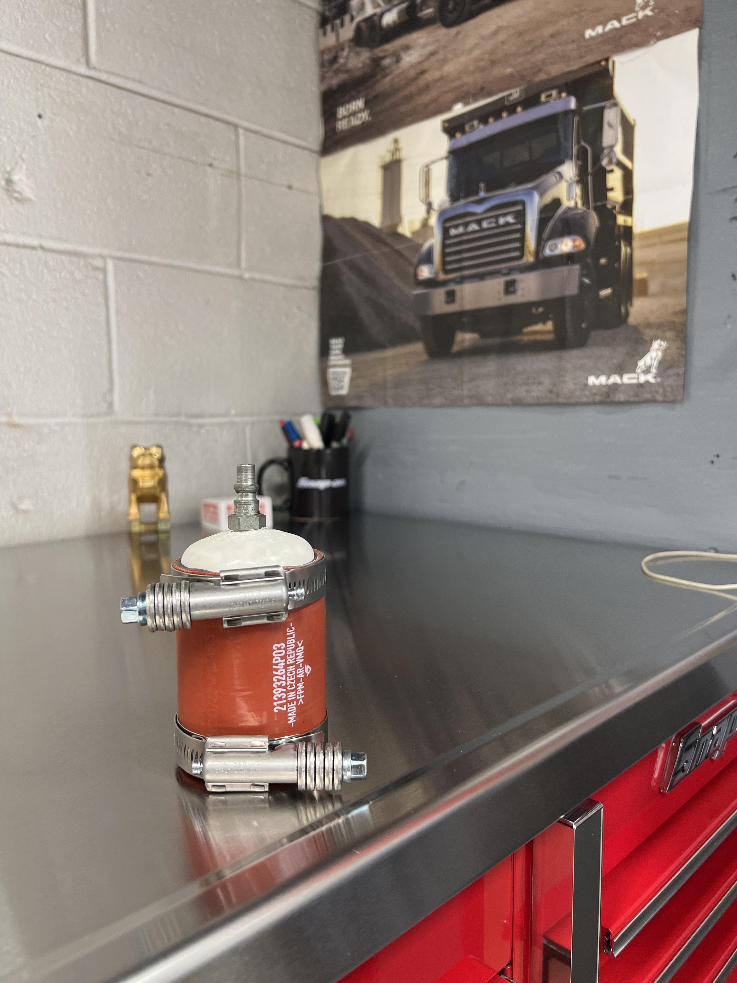

Hopefully I don’t have to use it…..if you know, you know….
Don't know if that fitting will stay in there at 40 psi how ever very innovative on your part Onyx ! which filter did you use?
I drilled it a size smaller than that fitting and wrenched it in and epoxied it in there. If it doesn’t I’ll get a metal cap and cut threads. What do you mean by filter??
I assumed by the look of the top there it was a filter you made the tool from!  Guess I am a dumbass 🙃! Its round it fits the the hose I would go there if I needed to make a quick tool for pressure testing! And Volvo uses some perrty asshole sizes when it comes to most things! What ever fits!

Now that you say it 'F'...   It does look like the bottom of a filter..  :)
Yup I 'm game I would try it If I had nothing else!😬
I would probably use a CAT Hyd./Oil filter..  I think they are thicker,   :)

That looks like a plastic cap off plastic pipe.  They're thick enough to put up with considerable PSIs for testing when you thread a hole drilled through it. Easily can hold enough to check for leaks.....and it's a cheap way to test. Onyx moonlights as a plumber 😃

Mark you are correct, it’s a pvc end cap

Now I see what you mean haha. Yea I guess the picture does make it look that way.

16 minutes ago, james j neiweem said:
Were there ever any Mack big 6's (885's) put in production.
No they never made it that far. Sucks, would have loved to hear one of those.

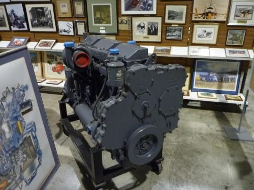

There was also an E9 quad turbo engine, I think they went into tanks.
Edited by Onyx610
More info
Looks like it’s been talked about on here before. Only decent info I could find on the E9 quad.
