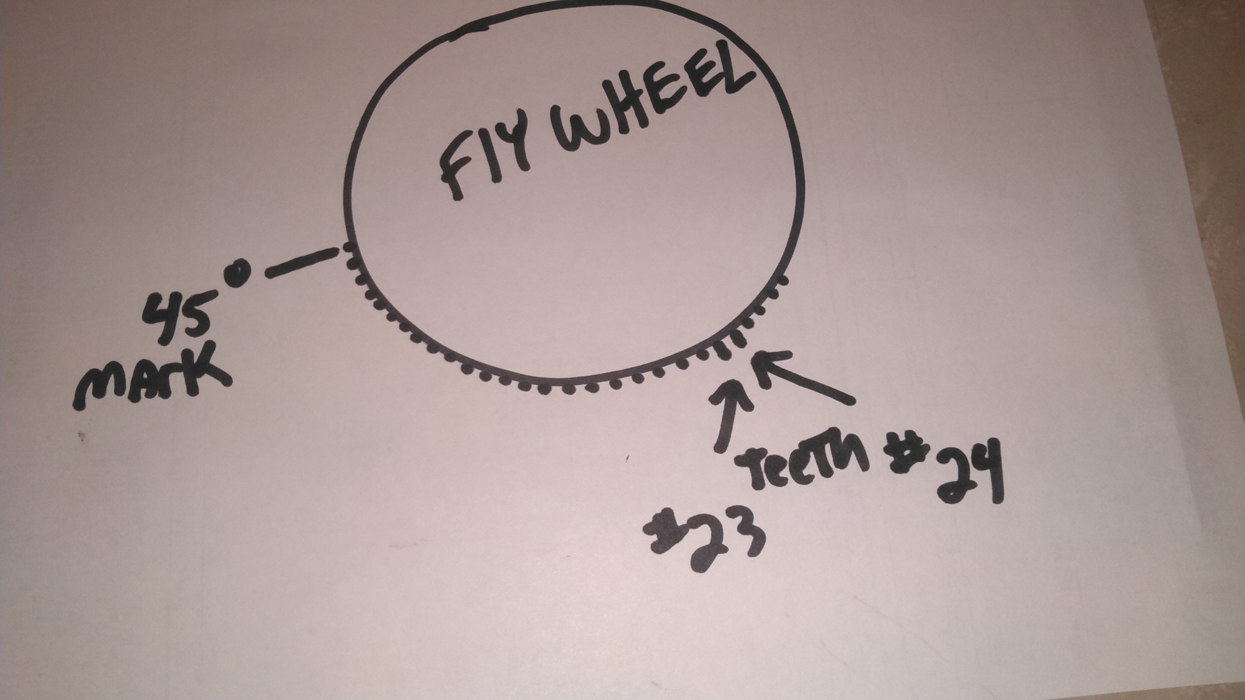

ok,  im going out on a limb...  is the sensor hole in the same spot?  here is a way to check the ring gear position with it all together..  ..... there are 2 half teeth that the sensor reads. if the ring gear is in the right position, those half teeth will be number 23+ 24,  counting from the tooth that is at the 45 degree mark on the flywheel. start counting on that tooth,  mark it with paint.  set the 45 degree mark in the center of the sensor hole, then bar the engine over ( flywheel) will turn clockwise) count the teeth as you go.  when yo see the first half tooth, your count should be at 23..  I hope i was clear enough..  jojo

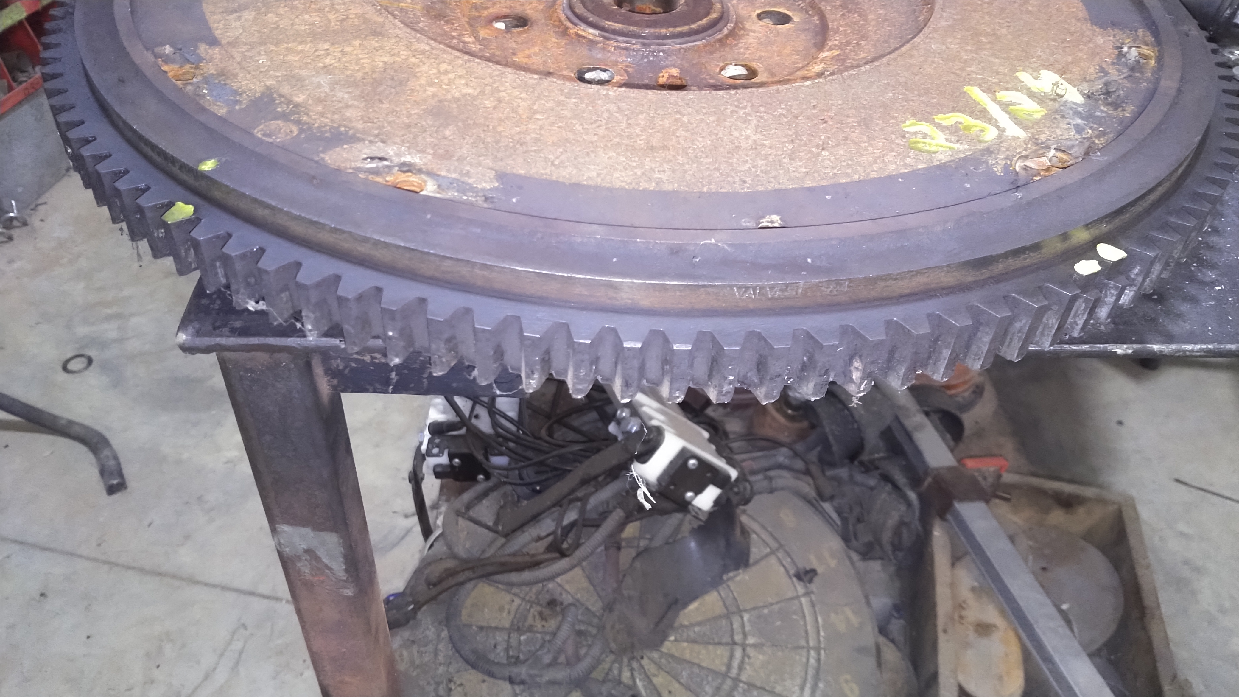

I wasn’t aware that this needed to be timed. When I did the trans/clutch on an etech I just put the flywheel on after it was resurfaced. Well shit…🤔

Wow that’s a lot…so the ring gear might be on the flywheel wrong? Or slipped?
how do I know where the 45 degree mark is?

Like I said... going out on a limb..  there was an issue with flywheel housing and or flywheel..  Im giving you some free tests to do, to ensure it is not something that would be missed, even though it is a far off possibility..  Most guys start throwing 'Laptop reccomended' parts at it spending thousands of dollars for nothing..  I laid out a simple check that can be done in an hour..  then if its good, you rule it out and move to another test..   as far ass the hash marks,,, have you ever seen the edge of an e-tech flywheel?  or done a proper valve adjustment?
We understand that, but how does he find 45 degrees. I didn’t see any marks on the flywheel and randomly threw back on…I wasn’t aware this mattered. Truck does run fine though somehow…
Buddy,  I aint there, so I am trying my best to understand his posts,  and there was more added to the posting, so then I start asking more questions, or think of crazy ideas...  besides, it is running on the cam sensor only, so there is where Im at..  we'll get it, The team will get this fixed for him..   as far as the degree marks,,,, they start at '0' and go to 45 degree's..  its on the same edge that the valve adjustment marks are...right before 1&6 marking..  '0' is true TDC...  jojo
