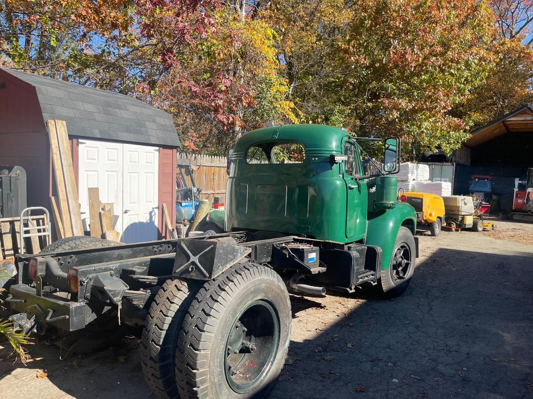

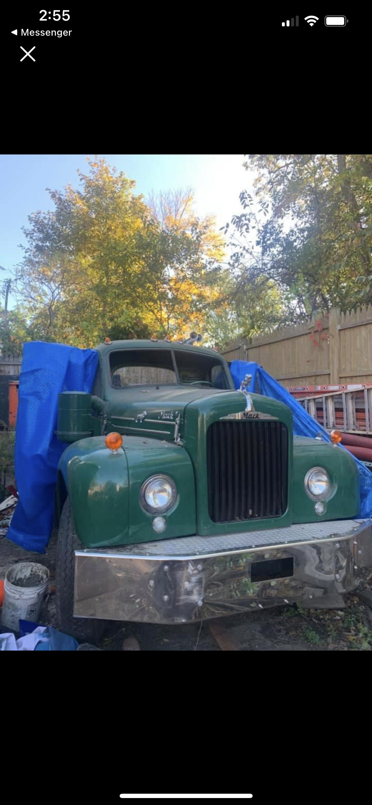

Welcome Craig,  Welcome to BMT and your off to a good start! Interesting post with a picture the first time. lol    .....Hippy
Glad to be here!!  Cool pic, right?  I should have better ones of it tomorrow.

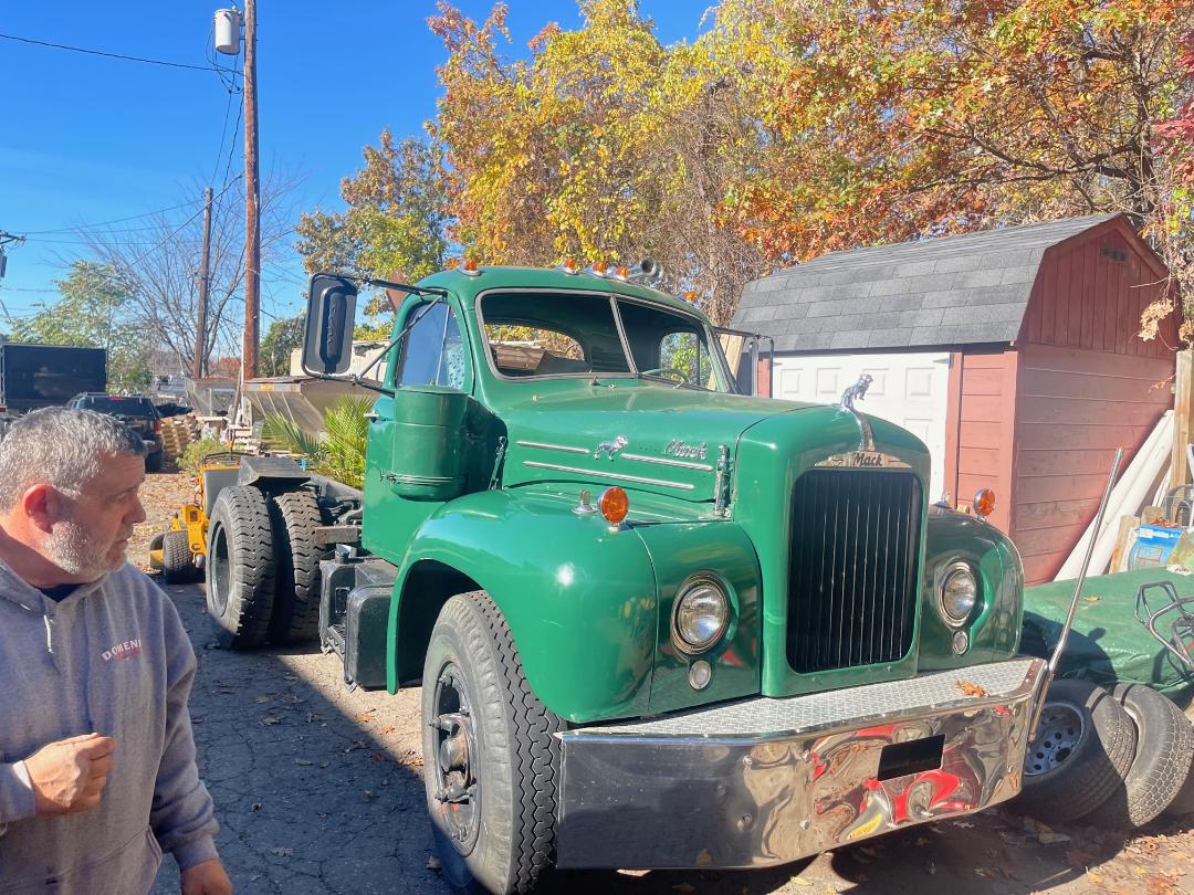

I like the bumper its diffent than a flat one truck looks to be in good shape I also have a b42 was the rear in yours changed to a diesel rear or are they still running a gas rear the ratios are way diffrent in them

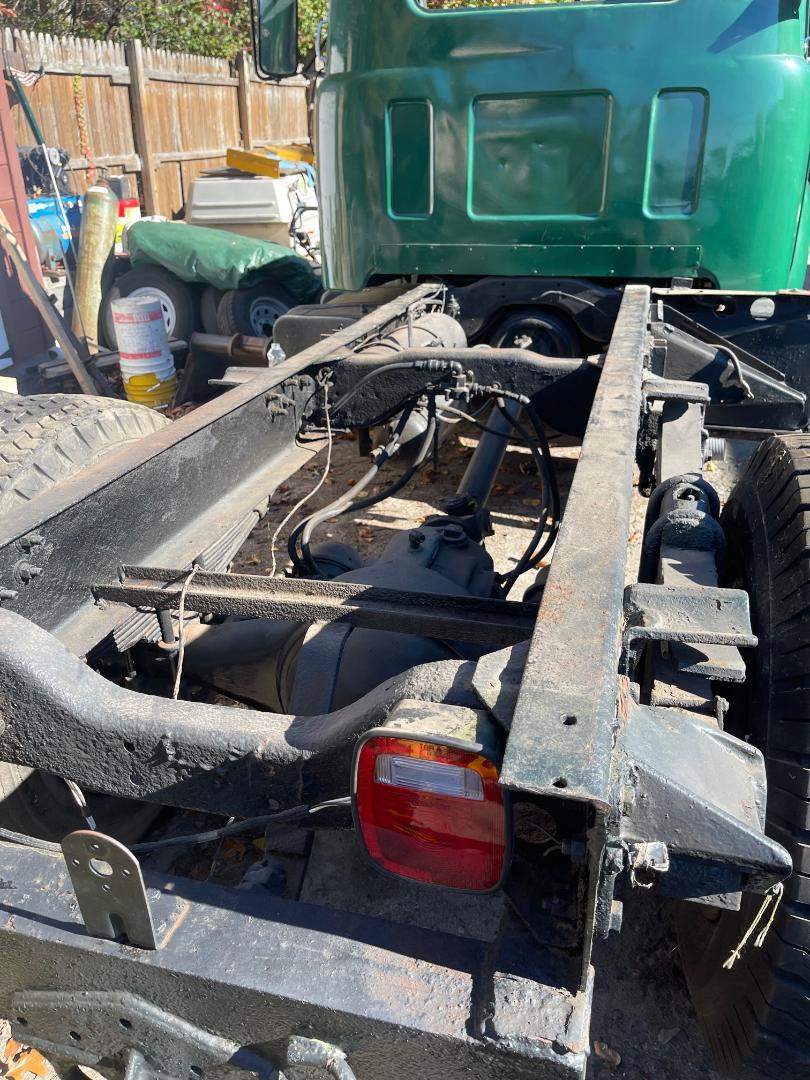

That’s a good question, I have no idea. How would I tell?
Jack one rear wheel up and spin one revolution, count how many times the driveshaft spins and divide by two (such as 9 driveshaft revs would be a 4.50 diff ratio).
is yours a single axle or tandum mine was a single axle with a regular rear there is a flat spot on the carrier that will have your gear ratio stamped it in mine had 6.17 gears they never swapped it out when they but the 673 in it I ended up putting a double reduction 4.61 I think out of a diesel but have since removed it to air ride it
I’ve done that with old Fords before. What’s the gear ration for a gas job or the Thermodyne diesel?
