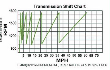

Actually, it looks like the ratios in that box ARE pretty widely spaced, requiring lots of "drop" while upshifting and lots of "rise" while downshifting.
The MPH on this chart will vary with rear gears and tire sizes.  But, the top and bottom of the RPM changes should be constant.  Looks like shifting around 1750 will drop you to about 1000 on most shifts  (43% RPM drop).  Conversely, you would have to pull down to about 1000 before downshifting, double-clutching up to about 1750 to match the gears and let them slide in (75% RPM rise).
I have seen that chart before. You're explanation makes it much clearer.  The text at the bottom of the chart refers to a "1750 RPM Engine".  My headliner has a sticker that says "Working range 2100 to 1200 RPM.  This makes me think that I have a Ecodyne engine.  As I understand the Ecodynes worked at a higher RPM range for fuel economy and the Maxidynes worked at the RPM range refered to in the chart, producing the "famous" Mack low RPM pulling power.   I understand and agree with the logic of your response , it may be that the numbers are just different for my particular engine (as you mentioned). Thank you.
The 1750 engine (I think) were referred to as "limited" or "governed" engines.  But, yes, the PERCENTAGE drop or rise would be the same.  So, if you can go to 2100, then you would drop to about 1200 instead of 1000.  And, you could downshift at 1200, double-clutching up to 2100 to catch the next lower gear.  Sounds a lot like your "1200-2100 operating range", doesn't it?!
