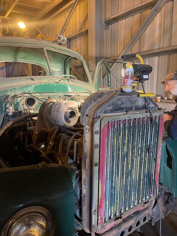

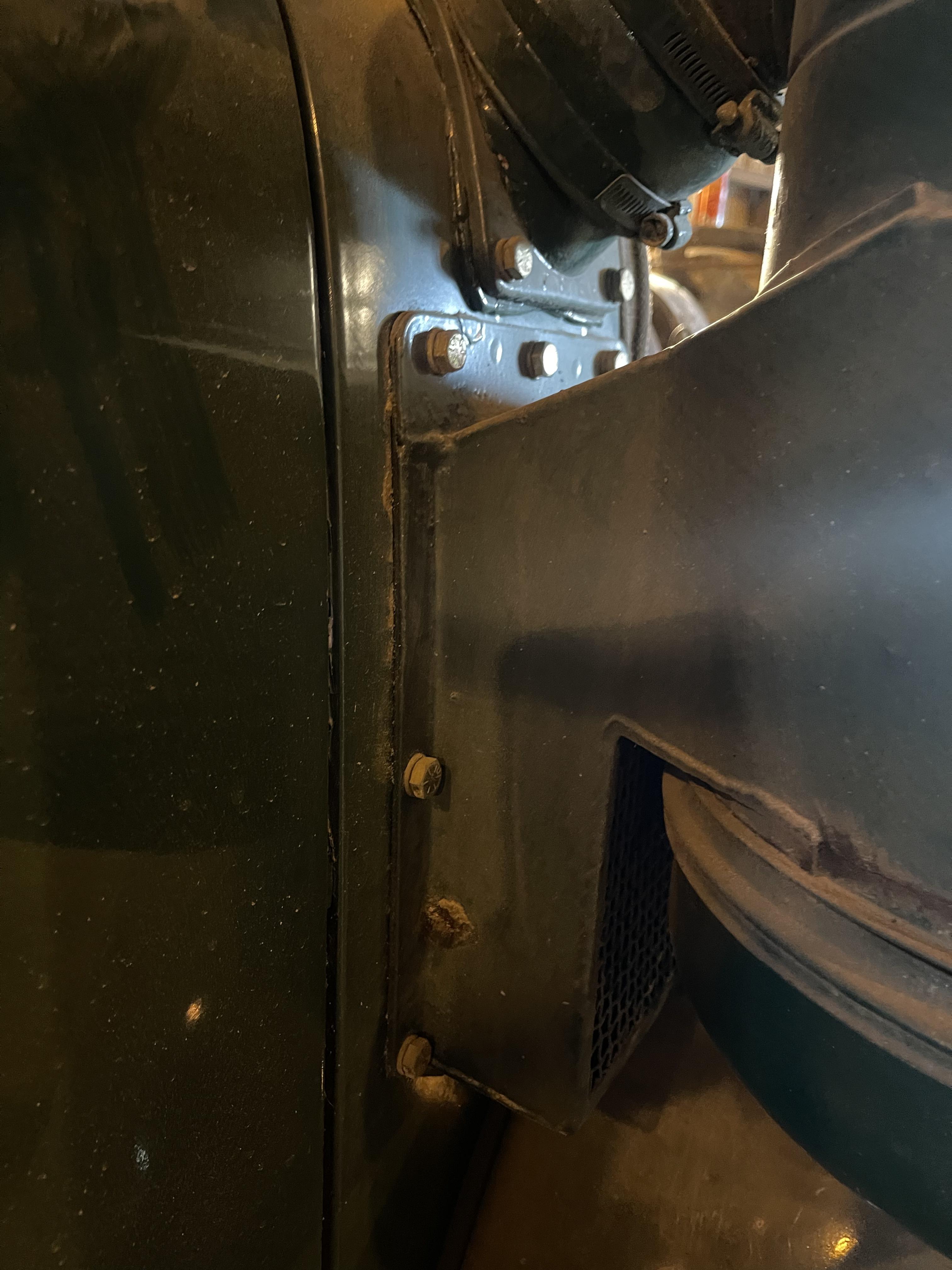

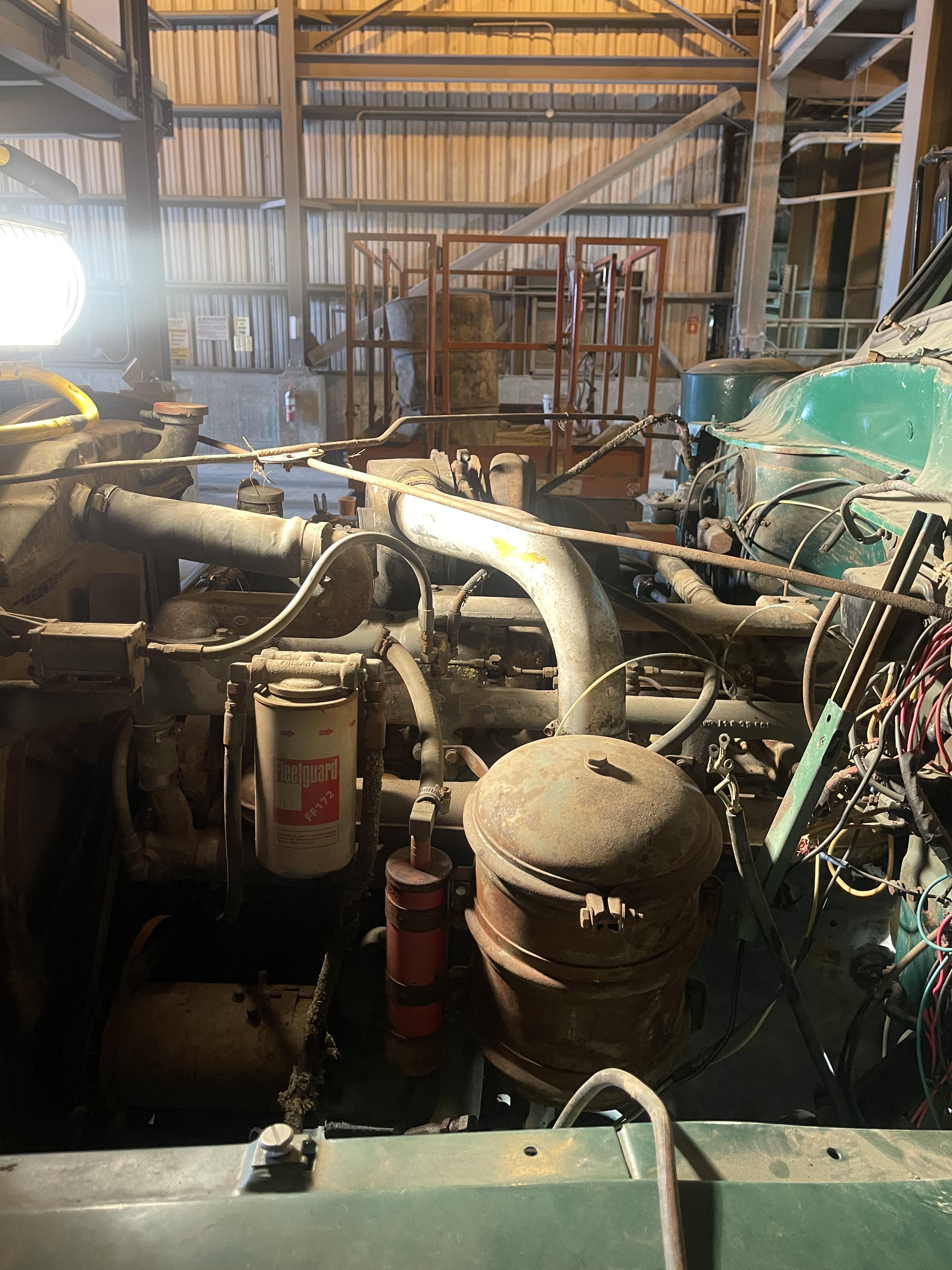

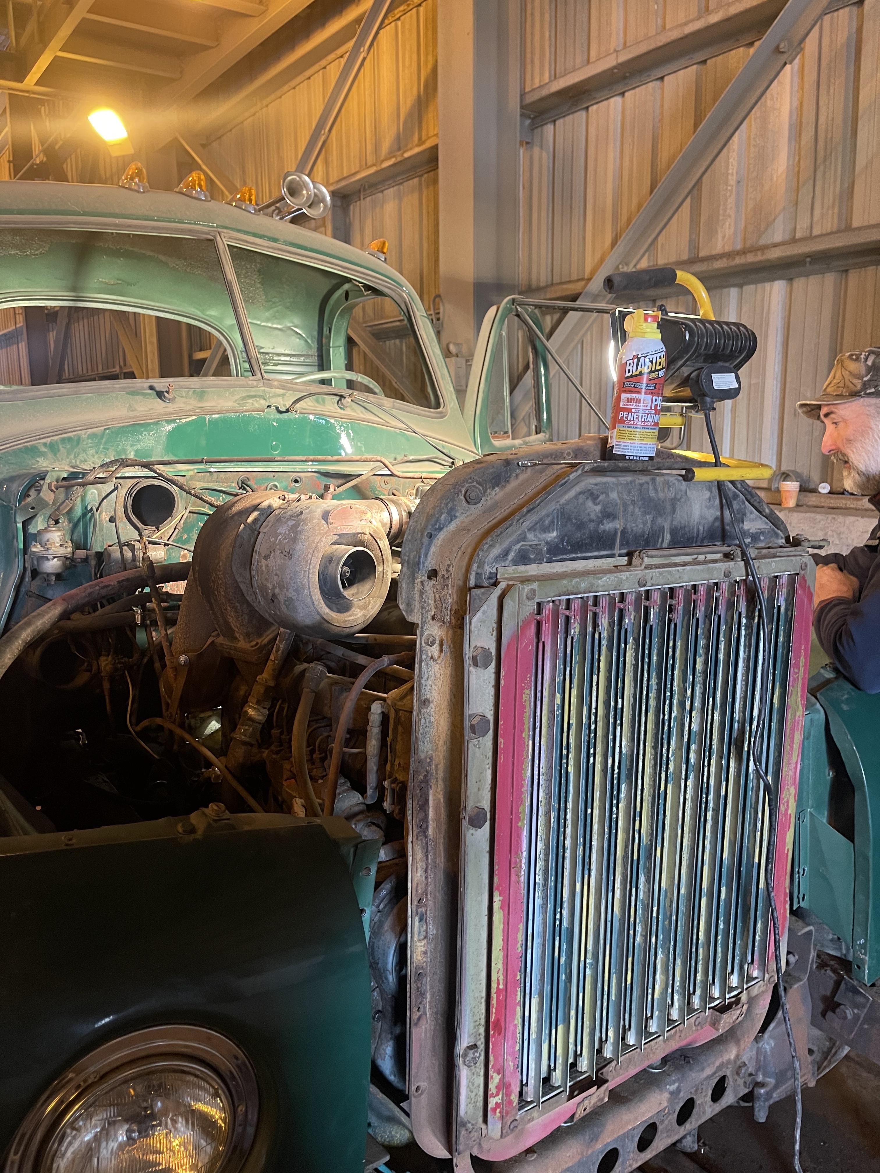

Got some more done today.  Radiator is in. Got all the air lines hooked up except one off of the governor. Think I’m gonna take the governor out of the red one and put it in the green one. Need to switch air cleaners too, as the red one has the turbo and green one didn’t, so they’re a bit different. The red ones air cleaner has a b-81 type with the air coming in from the top, just not the long stack. The green one gets the air from behind the canister, where the cab vent is on the red one.  Still need to figure out how to plumb the fuel filter. Not really sure how it was plumbed on the red one and I didn’t take pics of it before I ripped everything out.

spin- on filter on B-model!!  I'm thinking cartridge filter in canister : remove #4 aeroquipt line (9/16 wrench) then 3/4 ? wrench for housing top removal  to access paper fuel filter.

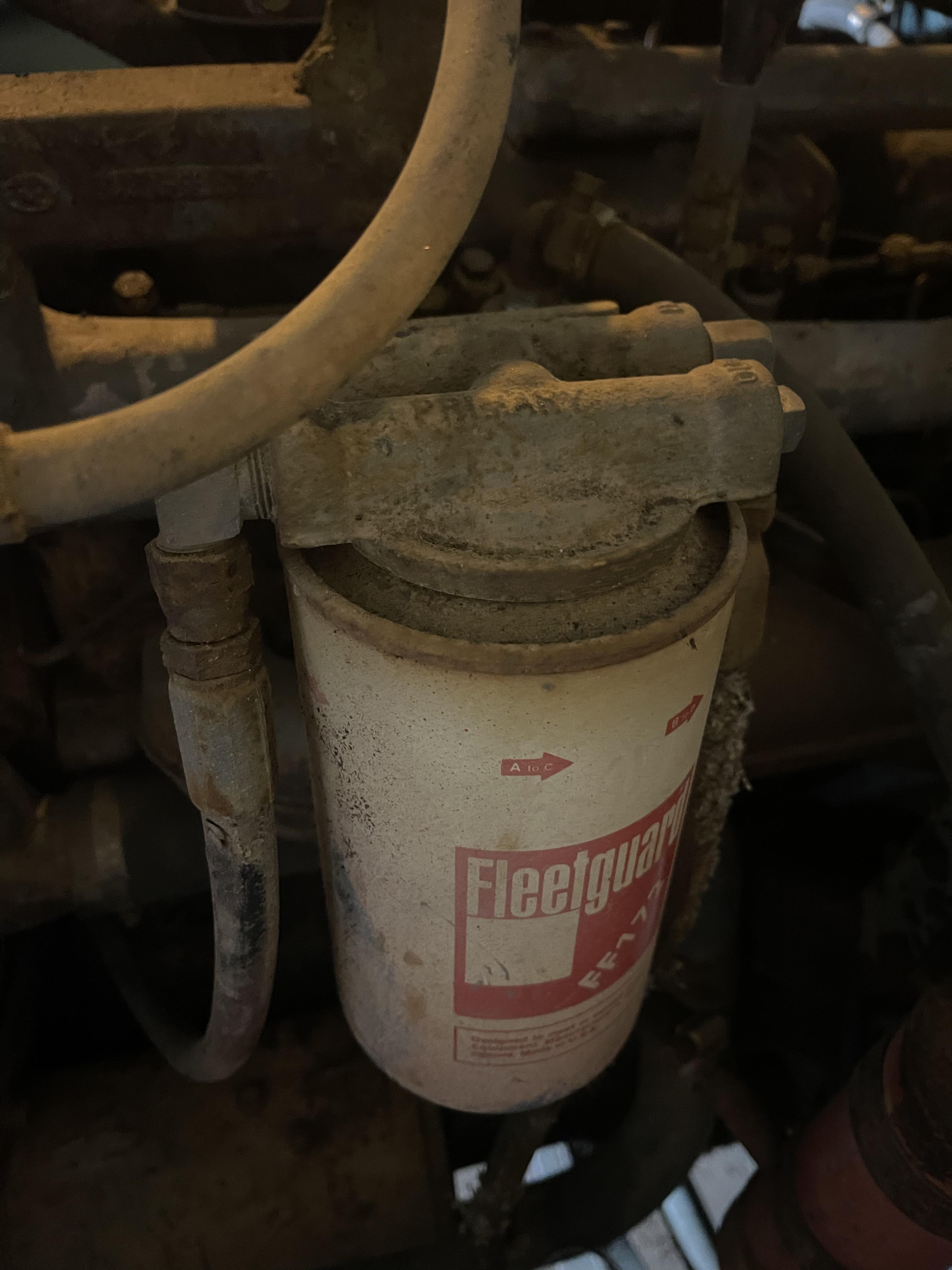

I’ve got two fuel filters on this engine. One canister type right above the injection pump and a spin on filter on the drivers side. The spin on can be seen in the pic.  I do know where one line off of the spin on was plumbed, to the drivers tank on top of the tank, I took the line off the old truck and am letting the elbow fitting soak. Would there be a pickup tube on that elbow fitting on top of the tank if that’s for intake?

1 hour ago, Joey Mack said:
I like the truck and the progress..    The fuel line routing is typically, From the tank, to the Primary filter, then to the lift pump, then to the secondary filter, then to the injection pump..   Just in case that was a question..  Really glad to see the updated pics..  Jojo
Ah, nice. That was definitely a question. Thanks!

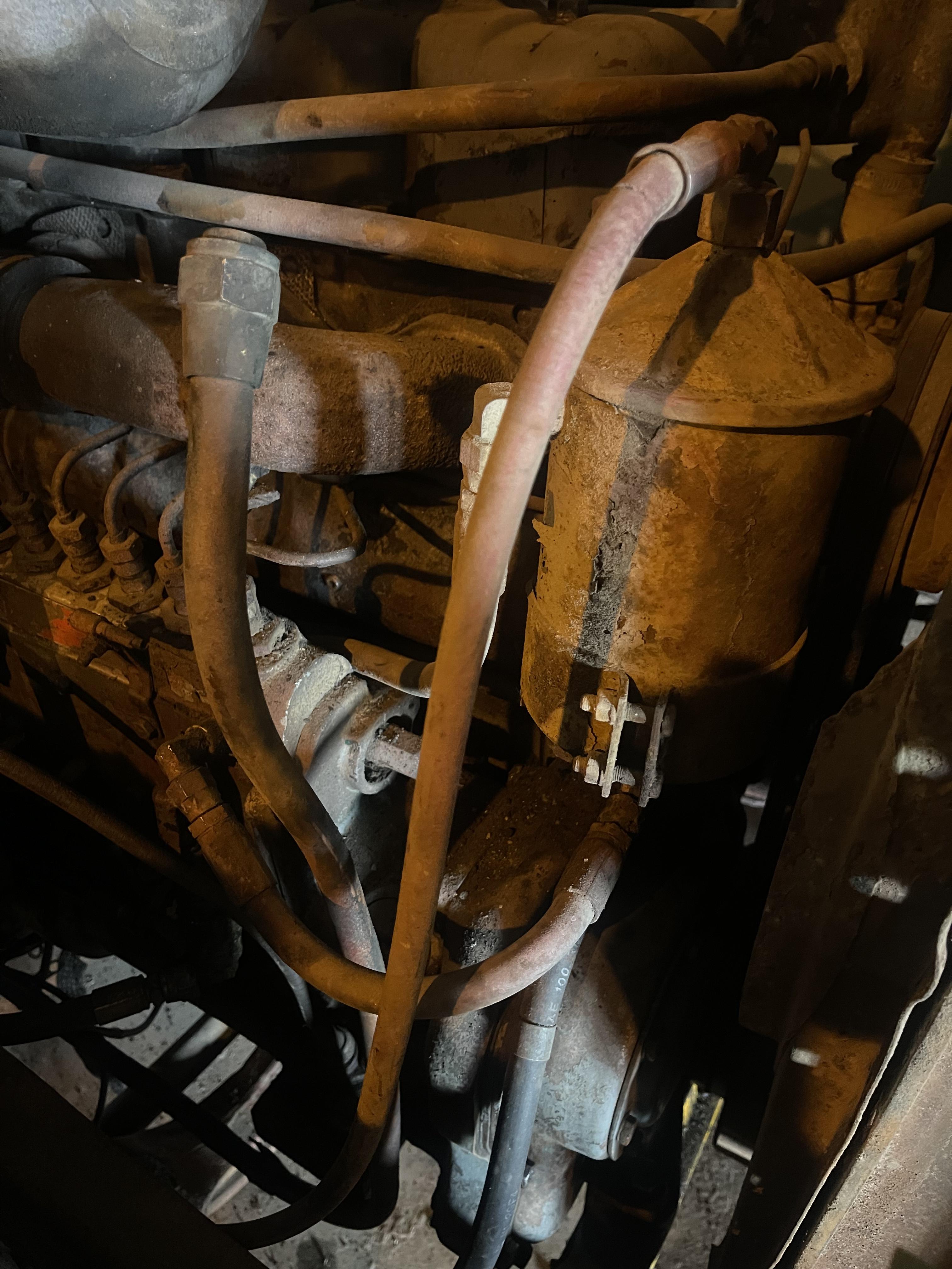

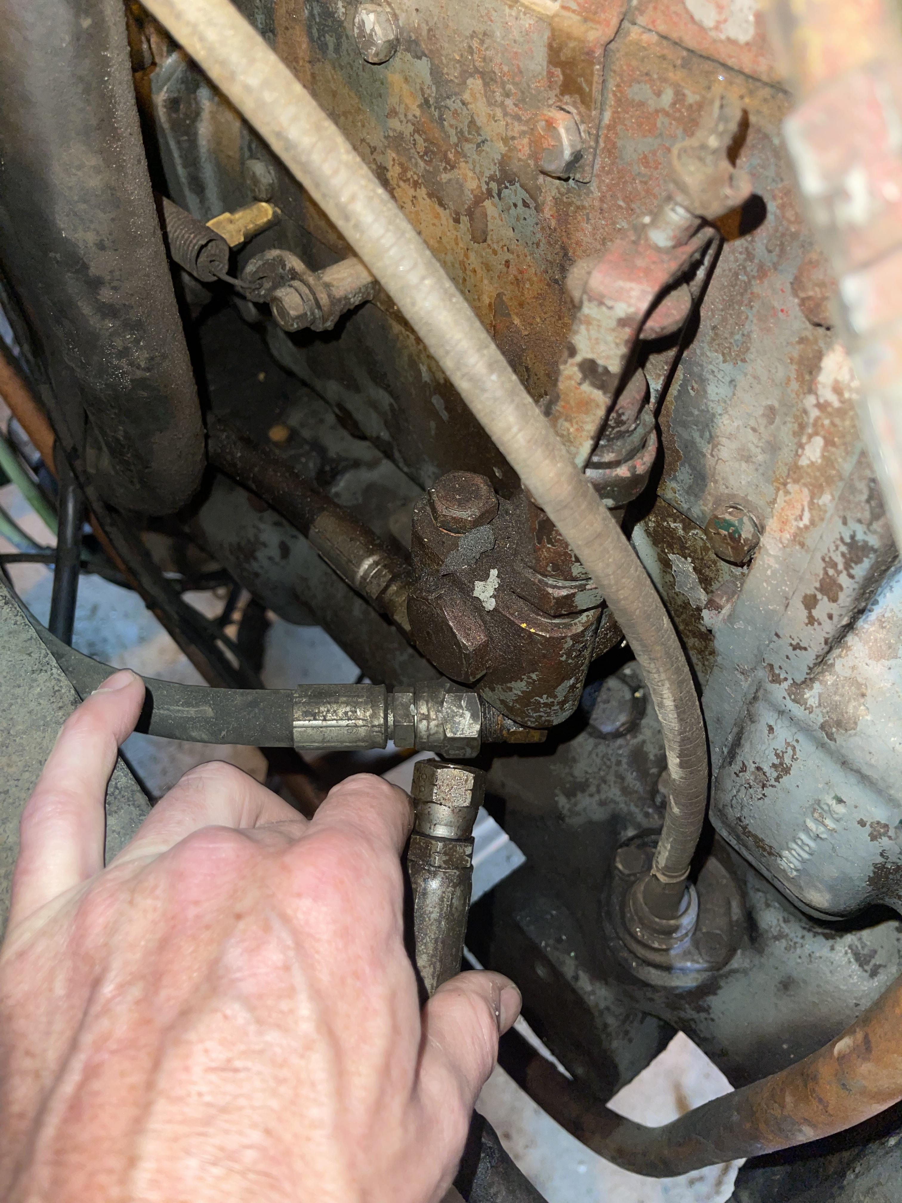

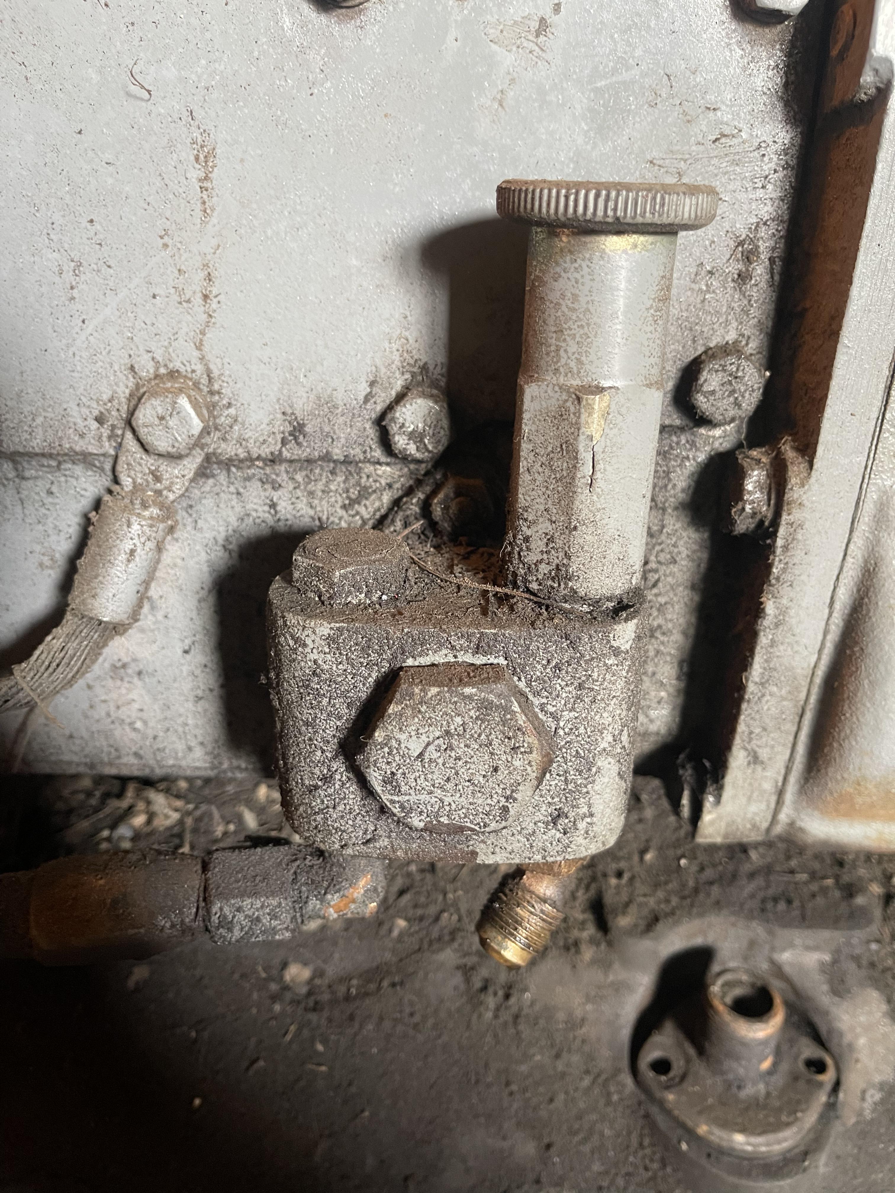

So, it appears I have some fuel lines that aren’t right with the switch between the two trucks.  If I understand right, the fuel line coming out of the spin on filter should go directly into one of the fittings at the bottom of the lift pump. First pic with my hand in it shows the engine thats in the truck.C46F3F83-9280-44D1-9BEB-B1AF046F8FCC.thumb.jpeg.33157a811dff9286965c840bb5ba4746.jpegSecond pic shows the old engine on the ground. F9F80B4C-0D94-4F57-B2F7-AFE49D860268.thumb.jpeg.4d0ba95a10a05212508ba748452ad58a.jpegThe line I have in my hand is coming from the “out” side of the spin on. 92275A22-664F-4BDB-884C-82D94E2DB01C.thumb.jpeg.51b5514a934525732f3fdefc29397267.jpegI’d imagine I need to plug it in to the forward fitting?

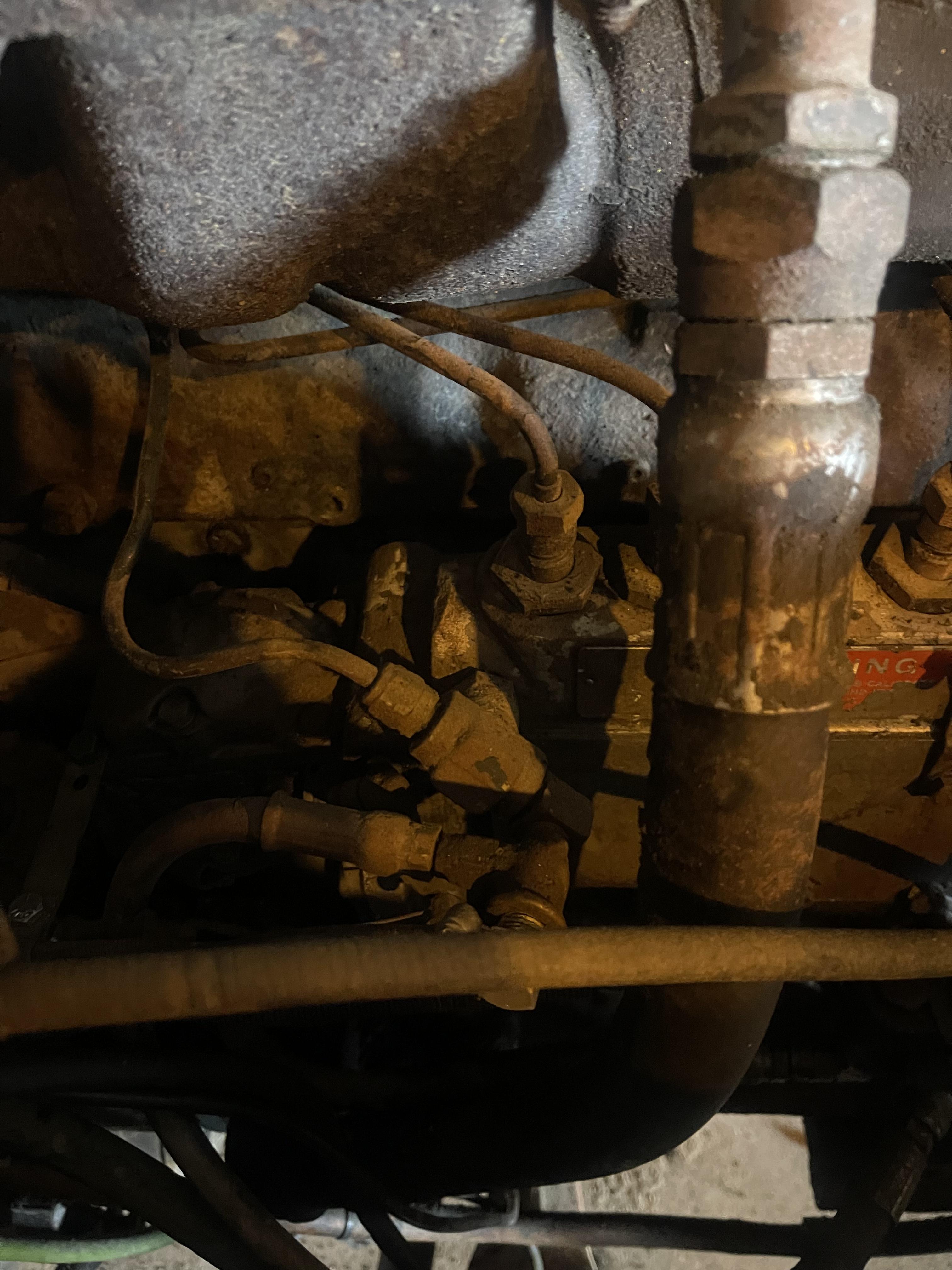

This pic shows the canister (secondary filter?) filter. C5E79ACB-F011-4AAC-8B06-F6C1356BD855.thumb.jpeg.d5a4b9a011665f3a5eaa0963fdfea6bf.jpegLooks like the line coming from the top goes to this point on the injection pump. 5EF71A8C-CBAE-4BFD-BBBC-D2C256F8C3EE.thumb.jpeg.13648d6629ecfa6346fc5be6e5ae3f77.jpeg
Where should everything be routed to?  Thanks for everyone’s help.
