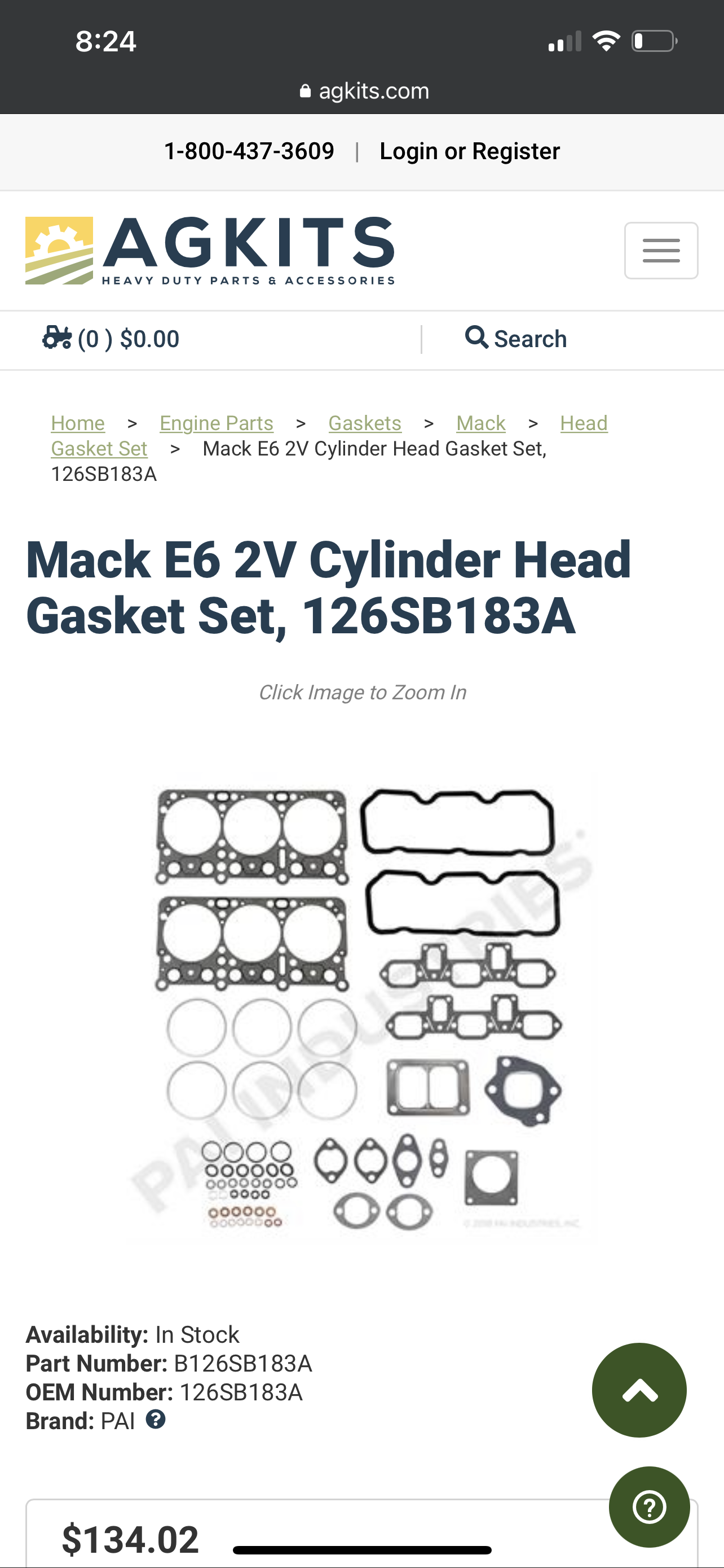

That said, is the 673 considered an “E6”?  Does this gasket set look like it’s for the 673?  Looks as if the head gaskets match up but just wondering about the rest of the manifolds etc
Its an E-6,  or one of them anyway... good call going to Agkits for parts... PAI, has a lot of parts.. As you have seen, there are a few other guys here that are very smart.  They can guide you very well, and I can add a little bit when it comes to buying parts, because of the one that I am building..  jojo

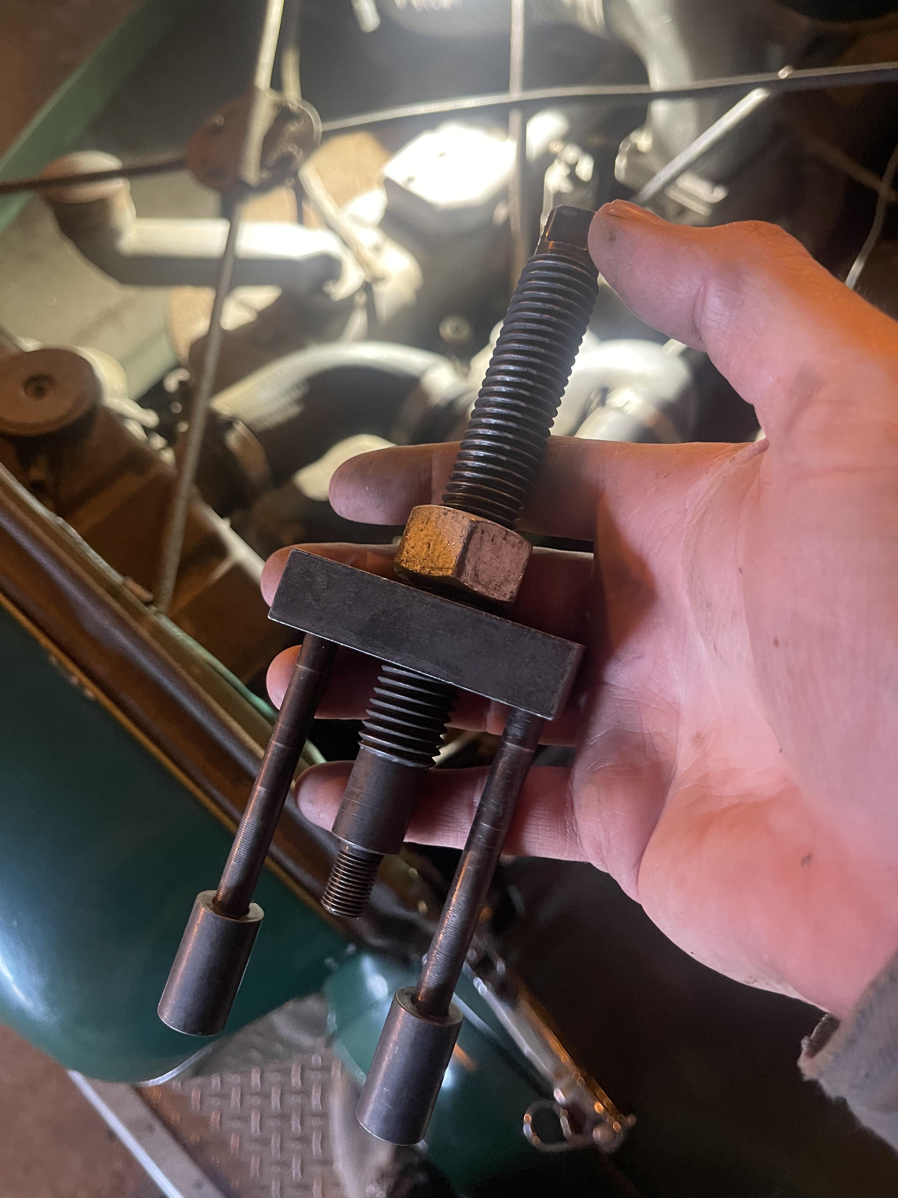

Would you guys recommend using this injector puller to try and break these stuck ones free?  I could use this and pull with the heel bars at the same time. I just worry about the threads that the puller threads into.  About 3/4” of threads though. What do you guys think?  How much should I “crank” the puller down?  I’m not going to put an impact on or anything
Wonder if you just snug that puller lightly them smack it with a hammer on top?  Maybe that would jar the injector loose?

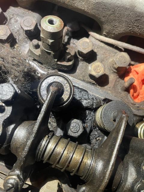

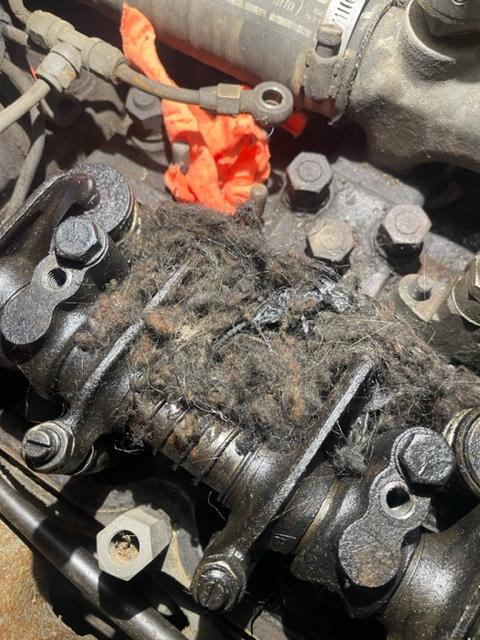

Craig, Buddy...   I almost added to my post about tearing the E-6 down....   I had 2 sweet mouse house's under the valve covers, as well..  this engine was in the woods upstate NY..  too funny...  Your rocker shafts look at lot better then mine..   :) jojo
