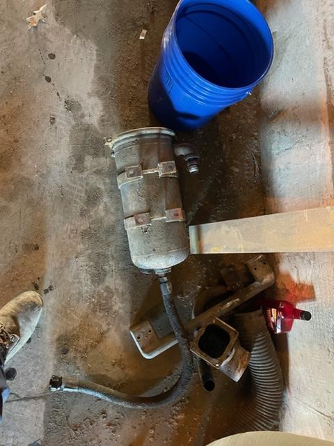

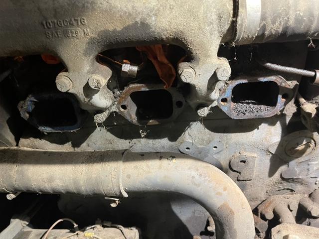

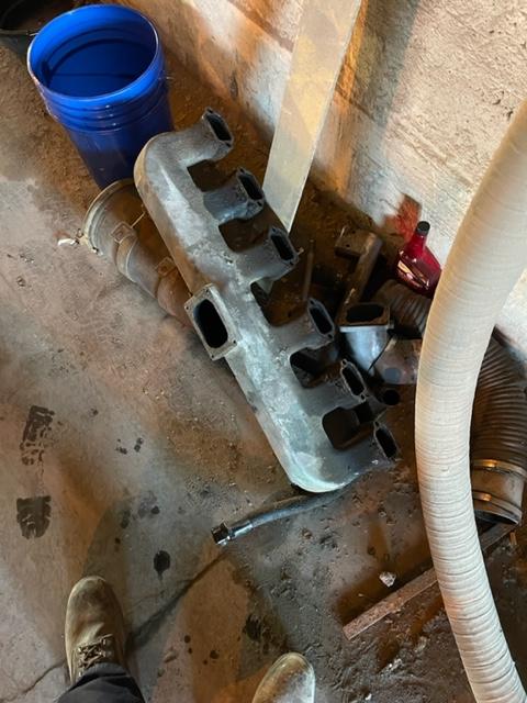

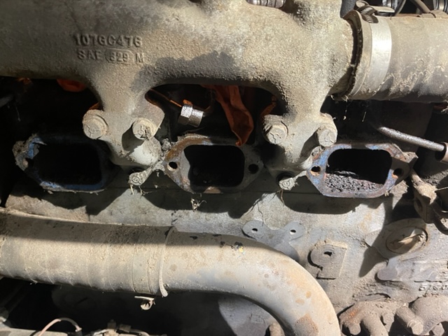

Well, I’ll do my best to not put any bananas in the gear box, but no promises. Man, lots of mouse poop in the intake ports. That intake surprised me being made of aluminum too. Was waiting for a 200 pound intake but was pleasantly surprised lol. Wonder how far the mice got, I can’t imagine they got passed any valves. Could’ve pissed in there a bunch though I guess.  Got cut short but I’ll try and get the water manifolds and exhaust manifolds off Monday. I won’t be able to get there tomorrow

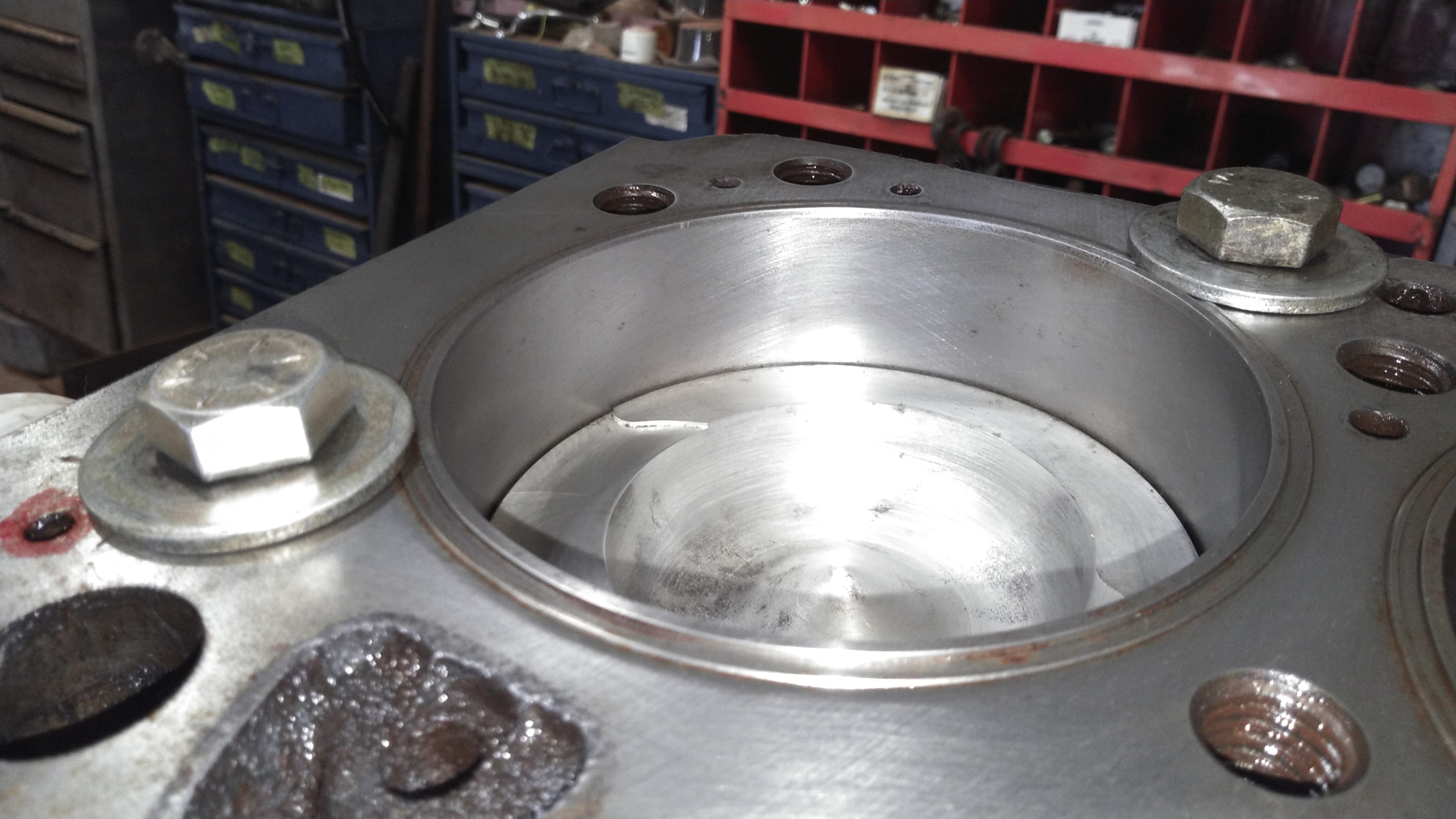

21 minutes ago, Joey Mack said:
Hey Craig,  The funny thing is i'm going to get back on the E-6 that has been in the back of my shop (un-touched) for over a year..  Here is a picture of liner hold down bolts.  be sure to keep the washer off of the raised part of the liner, any dent will cause a compression leak..  If the washer is too big, just put it on the bench grinder and take it down a bit..  jojo
Can still see the cross hatch on those sleeves!! New sleeves and pistons?  Thanks for the pic!
