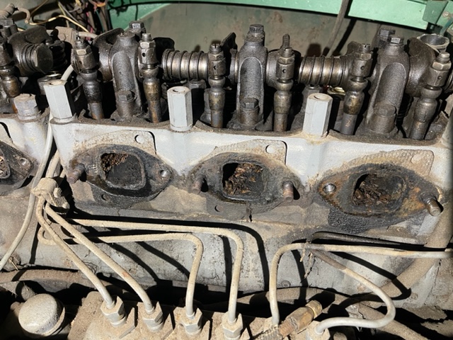

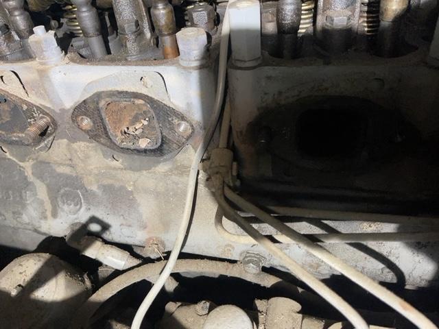

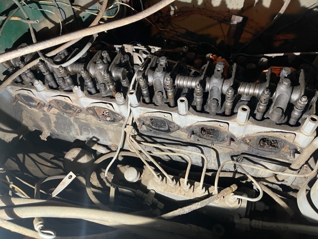

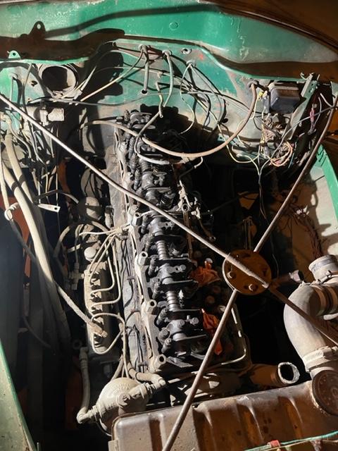

Got some stuff done today, but didn’t get the heads off. Can’t work on it tomorrow after work but hopefully can on Wednesday.
Can see the mice made their way into the exhaust ports as well, little bastards.

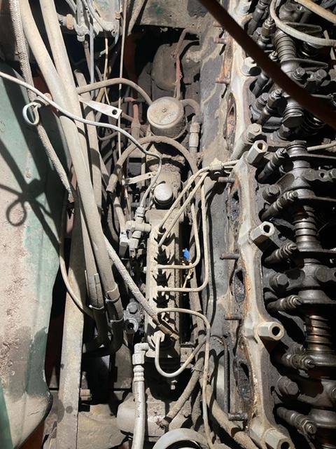

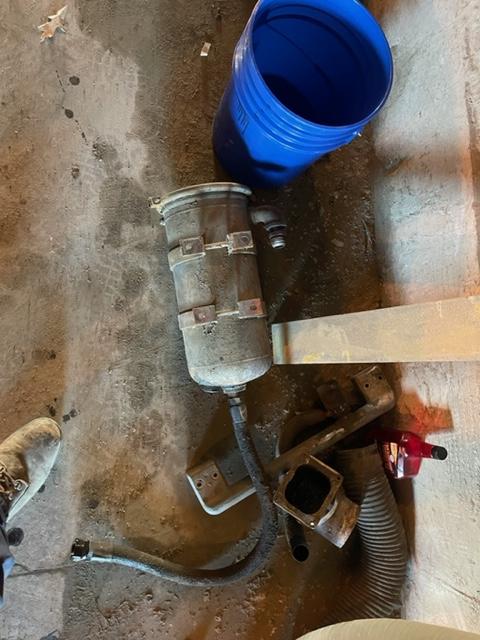

Anyone knowing if I can change this Luberfiner canister set up to a spin on?  Just one line out the bottom, so no bypass I think? If I read it right,  think I read you can’t do it because of the no bypass.
17 minutes ago, theakerstwo said:
That is a full flow made by luber/finer.
Can this get changed out to a spin on set up?  From what I read I don’t think it can but I figured I’d ask the folks who know
8 hours ago, davehummell said:
That is the filter off an earlier engine I did research a few years ago and the info I got was on my engine I had to keep that style filter.
Keeping the filter then I guess. Do you have a part number for the canister by any chance?

From what I hear  used to be able to buy a set up for the side of the engine illuminate labor finder but they are no longer available you might try calling watts… also Larry I think the cable clutch was in the later models my 66 does not have a cable my 87U model did
