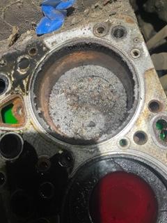

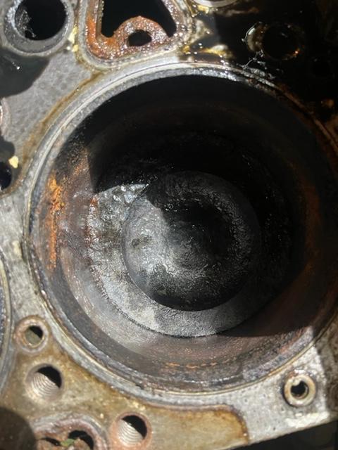

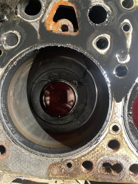

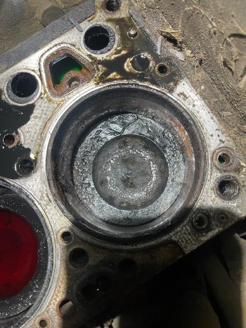

What the hell is that on the piston?  Looks like shavings almost. Wasn’t too coarse when I touched it. Looks like the mice chewed the top of the piston. Gah. Frustrated.
Edited by Craig N
Good thing you didnt force it to turn over..  The liners may still be ok.. any chips on the top of the liner, where the fire ring would go?  Keep it comin'...  jojo
