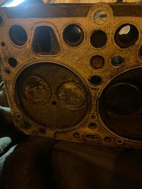

Think it’ll be ok to clean up and try running?  Is mouse piss that strong?  I can clean up the cylinder good enough but the piston looks like it got hit with a hammer. I don’t see any cracks near the liners up top
Really hoping someone on here says something like “yeah, that’ll clean right up” or “it’s ok if piston 3 looks like it’s been hit with a hammer multiple times, that won’t affect much” or “If you can get it unstuck, just re-gasket and run it, it’ll be fine, I’ve seen a ton of these do the same exact thing”
I still think rust is a bigger issue go ahead with soaking with WD and leave it sit original plan still possible according to the photos looks like very little wear continue with lotsa patience… good luck bud… bob

I’m gonna get the rear head off and see what it looks like in there I guess. Then I’ll start with the whack a mole while I’ve got someone putting pressure on the crankshaft. Got some cleaning to do for sure.
I did a little research and I guess dog piss can cause aluminum to rot out, so my thinking is the mouse piss will do the same. Hope the rear cylinders don’t have this going on lol

Did the head feel like it had been off before? Maybe someone before you tried to get it unstuck and that's the reason  for the piston damage. The pistons can be reused if the ring groves are ok, a bit of pitting doesn't hurt too much I've reused some pretty bad pistons on stuff that just needs to run. I'm not sure if these have composite or aluminum pistons but if they're cast iron they are more like able to be reused.
Porta-powers are a good method to remove a stuck piston if you have the right equipment.
Yeah, it’s been off sometime in its life I think. I’m debating on whether or not to disassemble the whole motor and go through it or just buy a donor truck with a running motor and be able to sell some of the parts that I have left over when done

I would go with  the idea of a donor truck ; if numbers are reasonable. total rebuild of this engine is proper way but can end up "snowballing" to an expensive deal. have seen quite a few engines apart  never one with that extensive amount of damage from rodents.   call the mouse back and tell him to clean up his own mess.
I guy who comes in to the garage is a diesel mechanic so I showed him the piston. He said he thought that it looked like it got too hot, that maybe it took on too much fuel. He didn’t seem to think mouse piss could do that to a piston. I know if I were to rebuild this engine properly, it would cost me more than a donor truck and that there’s still the chance that it’ll fail if I don’t put it together right either, as I’m not a diesel mechanic. I’m leaning toward a donor truck right now
