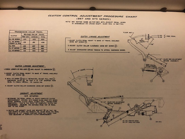

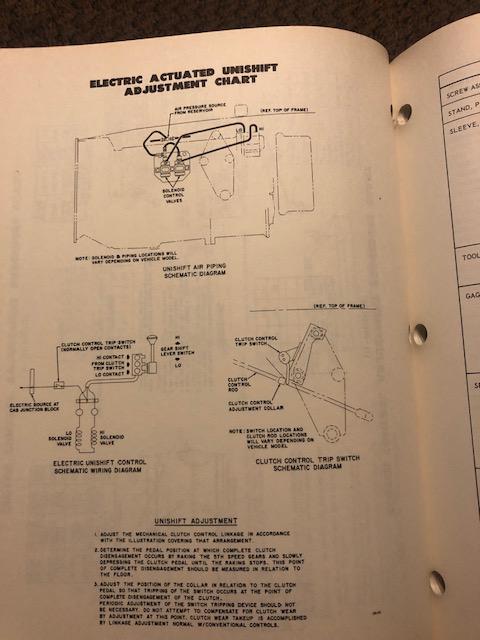

Here are a couple of pictures from 2 different pages in a service manual.  I think one is for air operated and one is for electric.  See if any of the notes help with anything.  I think B1 and B2 are from the same page, and B3 and B4 are from the other page.
B2.jpg.2f80fc3520734a95f2b6e0932d06016e.jpgB1.jpg.7044a49ac51a274eb4a682ef16ee3f53.jpgB3.jpg.0ddcad830976232ad6e66086b840d1d6.jpgB4.jpg.ee4ec161afe161dfef19e3536b159ade.jpg
