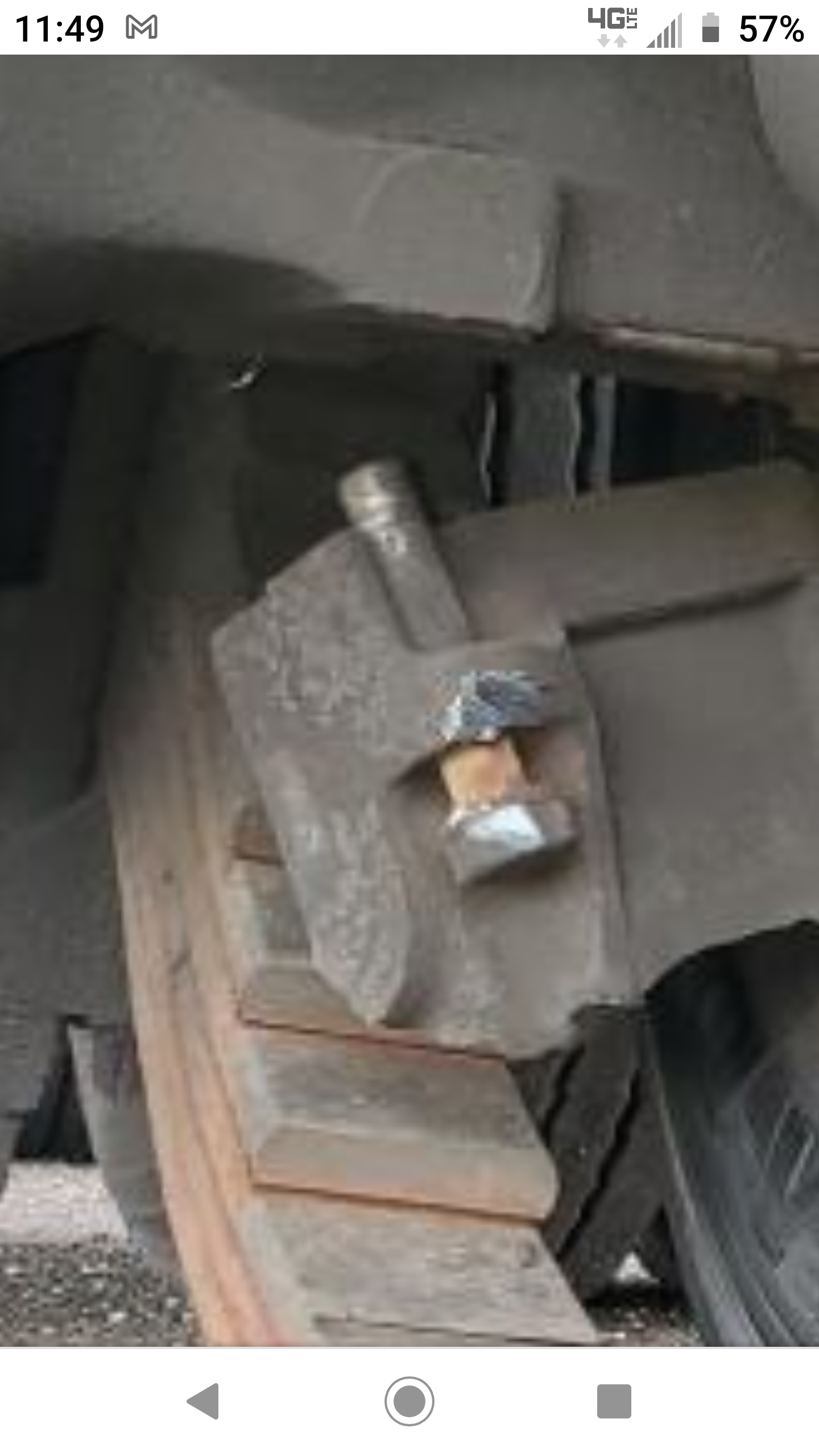

I don't think this dude's ride is all that bad. Look at the saddle, it's not up too bad out of center on the trunion . It looks to have some grease residue around it too. I've seen lots of camel backs worn out and this isn't a typical failure.  I'm curious why that one bolt is unscrewed ?  Even if the bucket failed, that one bolt shouldn't be unscrewed and still fast into the housing ( if this picture isn't after removing it )  I still think Paul was on to something earlier in this thread.
Just recently had a local outfit have a tandem dump flip over from a broken mack camelback spring.  Props to you for keeping it under control 👍🏼.
Were your buckets welded? It almost looks like discoloration from welding.

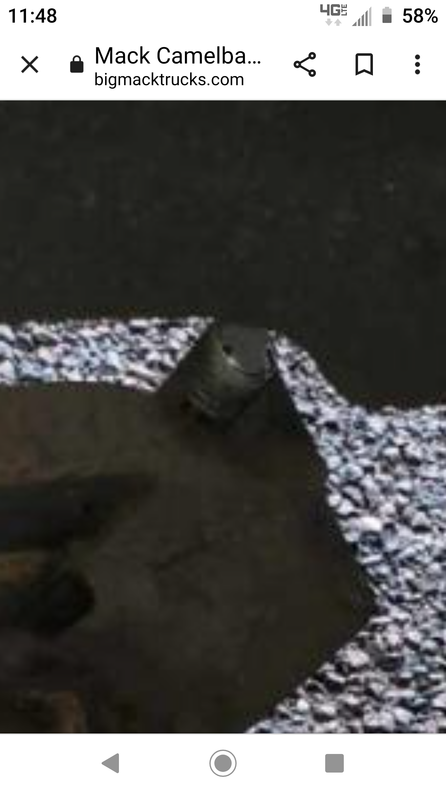

14 hours ago, Joey Mack said:
dammit Onyx...  I cant see what that symbol is.. :)
Buddy you need to see the eye doctor!😂  That looks like it  was basically a clean break ! I NEVER SEEN ONE OF THESE Break like That ! looks like the coarse  bolt let go that threads into the housing and stressed the rest! I wouldn't jump to the blame game on this other than the buffalo pads needed replacing! The T leaves hitting the box heavy usually the indicator!  that said as indicated the welding is a possibility of a crack welding! !
20 minutes ago, MACKS said:
Has any one else seen one of the buckets brake like that because in never even heard of one breaking, something was very wrong there..
No !  I suspect the bolt broke my self As I stated! That said!  Its an opinion! When redoing the load cushions We Always the REPLACED THE BOLTS! unless instructed by the customer not to! Lot of weight hanging off of them bolts at times! Imagine if it were the front one let go WTF ,Excitement X4 New Underwear Required !
That bolt in the picture should still be tight no matter.  There's lots of it there too and shiny. End of the treaded part looks like any end of a bolt ??  Pad's pretty well past needing attention, but I've never seen something quite like this (lol)   These mysteries are more addicting than crack
I just got new glasses 6 months ago.. :) . Too funny..  I decided to delete my opinionated posts, so as not to offend or look like an A$$..  those boxes are worn thin, and that suspension has been bad for years..  I have never seen a box brake like that on a truck that wasn't wrecked..  The best part is that no one was hurt by an out of control truck.. hats off the the driver for keeping it upright...  Jojo

Yes C4   don't be offended, but that truck staying upright was more luck than skill. That's no reflection on you either.  I've seen springs sheer off, trunions break , never saw anything like that though.  All same effect as far as driving it when it happens and it usually doesn't end well.
