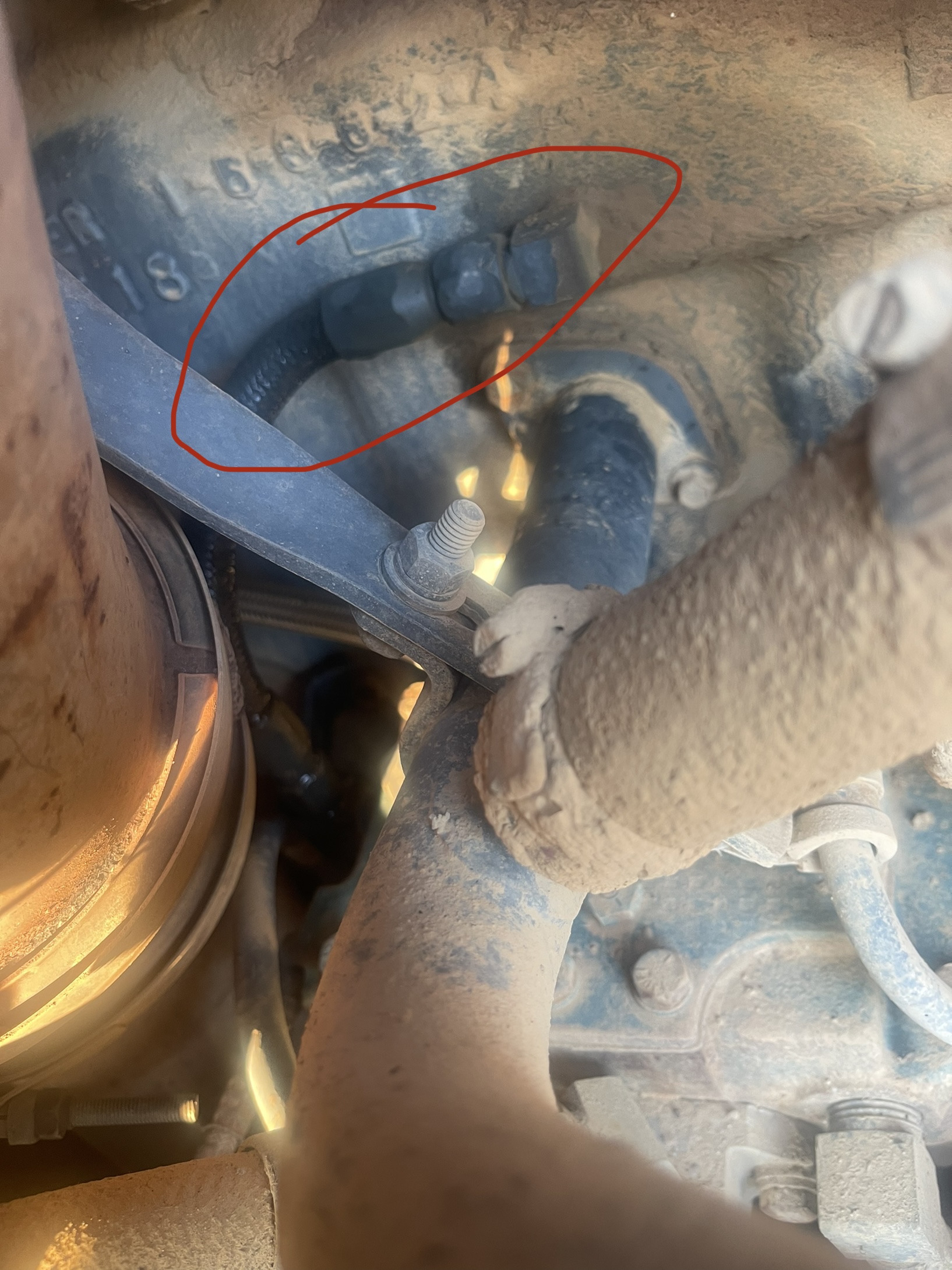

5 hours ago, msbulldog601 said:
Thank you is this a part I can get from Mack or will need to get one made?
Take that one off bring it with u an get one made,with that type of end fitting u can make your own,just buy the right size hose,easier to get one made tho..
  • 0
Okay thanks will I loose a lot of coolant when I take it off?
  • 0
I think when I did mine I just disconnected that line from the compressor first and aimed it into a large catch pan and let it drain out that way until it stopped. Then disconnected the hose from the side of the block. It took a few minutes but this way I didn't have to drain out any more than I needed to. This was on a 94 RD. If I remember right the radiator drain / lower hose is still a good bit lower than where that hose runs into the block. Either way will work though.
  • 0
Yep, there is a port on the compressor head, top right outer side, on a Bendix. Some of them have a 90 degree drain spout, takes a 9/16" deep socket to open it..  I think about 3-4 gallons is all that will drain.  Easy to do..
  • 0
thanks!
  • 0
Thanks!
