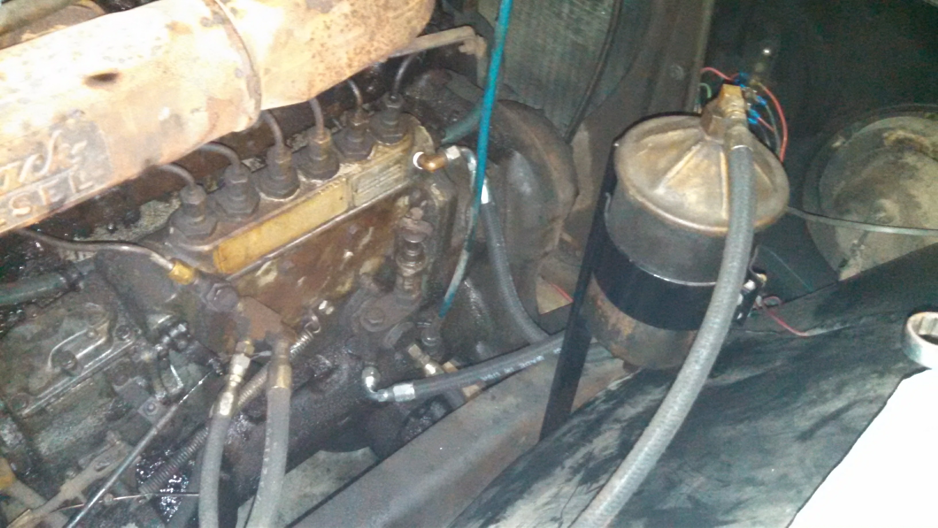

On 1/5/2023 at 9:57 AM, Lozzatron said:
The problem was a couple for fuel leaks, one under the cab in a fitting in the main fuel line and another on the injector return.  Fuel was draining back and it was taking about 5 attempts to start.  Runs great now.
