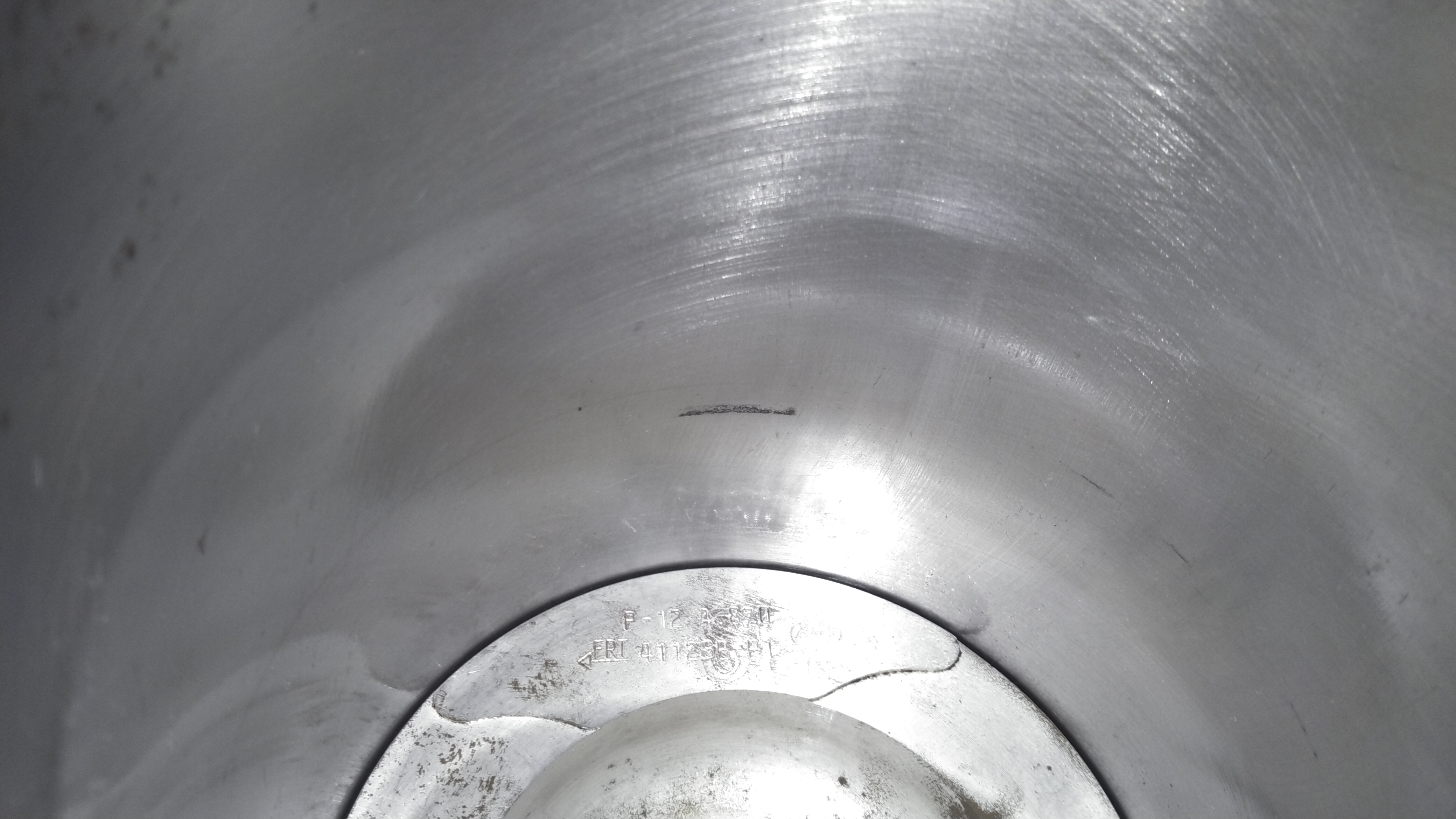

Hey guy's..  I had this E-6 machined and new liners installed 2 years ago.  I installed the cam and pistons a year and a half ago, then had to stop to do other engines for this customer.  I had the engine on its stand, I kept it covered and lubed and every once in a while I would wipe it down and spray lube all over it and inside of it.. sometimes I would roll it over a bit..  So today I am back on it, and was cleaning the deck, and cylinders, when I found this....
I know I need to replace the liner, what gets me is how this happened, since I have kept up with it, and kept it clean an free of moisture..
I used 320 emery cloth to clean it up, and it is actually a recess, pitted, somehow..  I'm afraid it will brake a ring..  I guess, my question is more about has this been seen before, and is it possible the counter bore has an issue?  I did NOT install the liners, so I have no idea about counter bore condition..  I guess I will pull the piston out and check the rings..   Good to hear from you Bob...   jojo
It looks like a chunk missing to me according to the photograph just like you said I would be afraid to use it If the counterbore  is warped the liner will not come out without a huge fight … bob

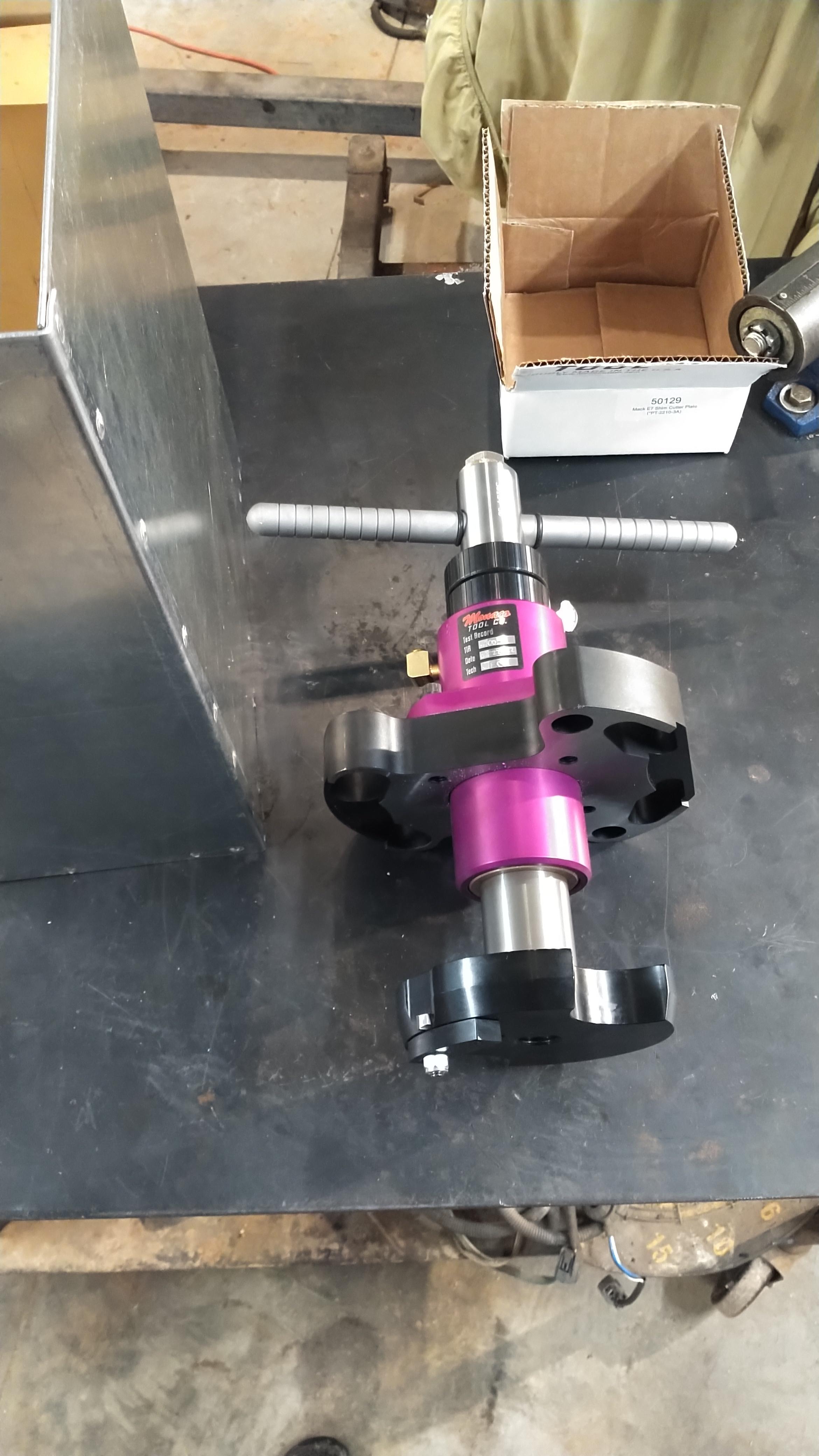

I have a great liner puller, and I can always run a few beads of weld inOTCPT6400-C__55259.1655912308.jpg?c=2 it to shrink it..   The other 5 are fine,   Phewwww....

I forgot the darn picture
it kicks butt !!! It's the only style I have ever used at the Mack dealership, so when I started building engines in my Road service, I bought one..  They are $1000.00, and worth every penny to me..  jojo
No keep going, I like tools. God for bid anyone every robbed your garage. But most people would walk buy all that stuff in there and be like nothing but junk in here! Little do they know how much money is in there.  As for the pitting. Not sure bud, just oxidation made the imperfections show through?

I dont know Mark...   When I had the block done I asked them to press the liners in.  They bought the liners...  I would assume PAI,  But I don't know, and I can't find out..  However, when I pull this liner, I may be able to see a stamping on it..
Truth is.... I have never been in this spot before..  I buffed it really good, and the pitting is below where the rings will ride, but I have no idea how long it will run with this small amount of pitting.  It may run great for a long time..   and because it is an E-6....  I do not have real skills for installing the liner..  I heard about dry ice, but never done it.  I was raised on E-7's...  I have a liner press for those engines....  when you deep freeze the liner in dry ice, will it just drop in?  I bet I would have to move quickly?  of course i will have the block clean and ready to go..   jojo
