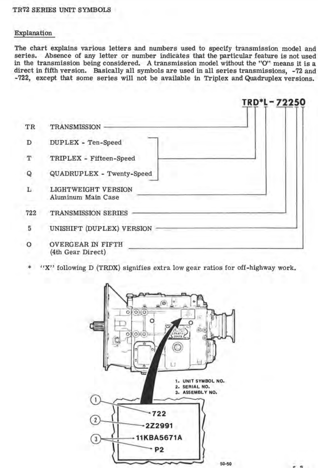

Here is two of the transmission identification charts floating around out there.  There are others.  The second one is more appropriate to your "107" number.  Lots of guys here can help you with the engine codes.
