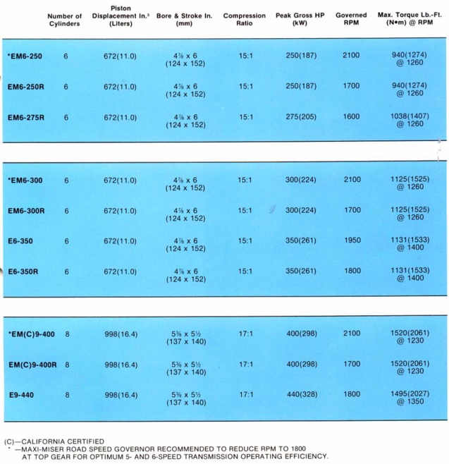

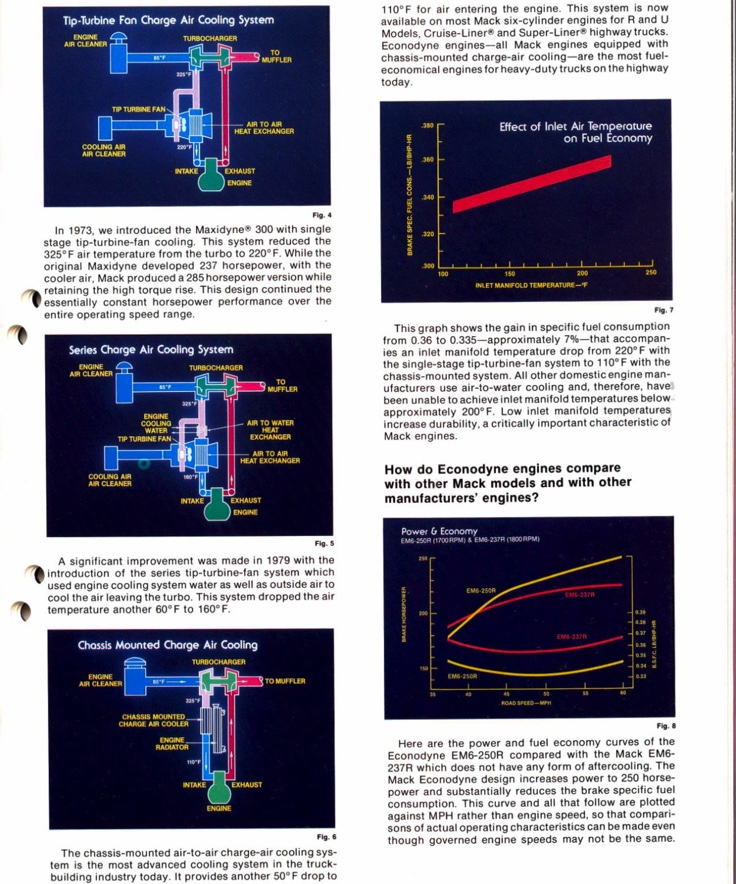

1 hour ago, BOBWhite said:
Heres stuff from a 1980 brochure:
 14FAC8F9-392D-4C30-AC09-B2424877DE9D.thumb.jpeg.e81964563a9dc0a2d723b93fc01a17b5.jpegA5338858-9564-4F52-9D95-5ECD5691D3B8.jpeg.4942d125d181ab8470b600c30aceeb07.jpeg
I think the tip turbine and the charge air cooler motors were produced at the same time then. Doesn't show a tip turbine 350 but I think you could get a rough idea.
This part of your picture show a coolpowered 350
Series intercooled tip turbine motor
Thats a good page of information you sharex there Bob, thank you
Paul

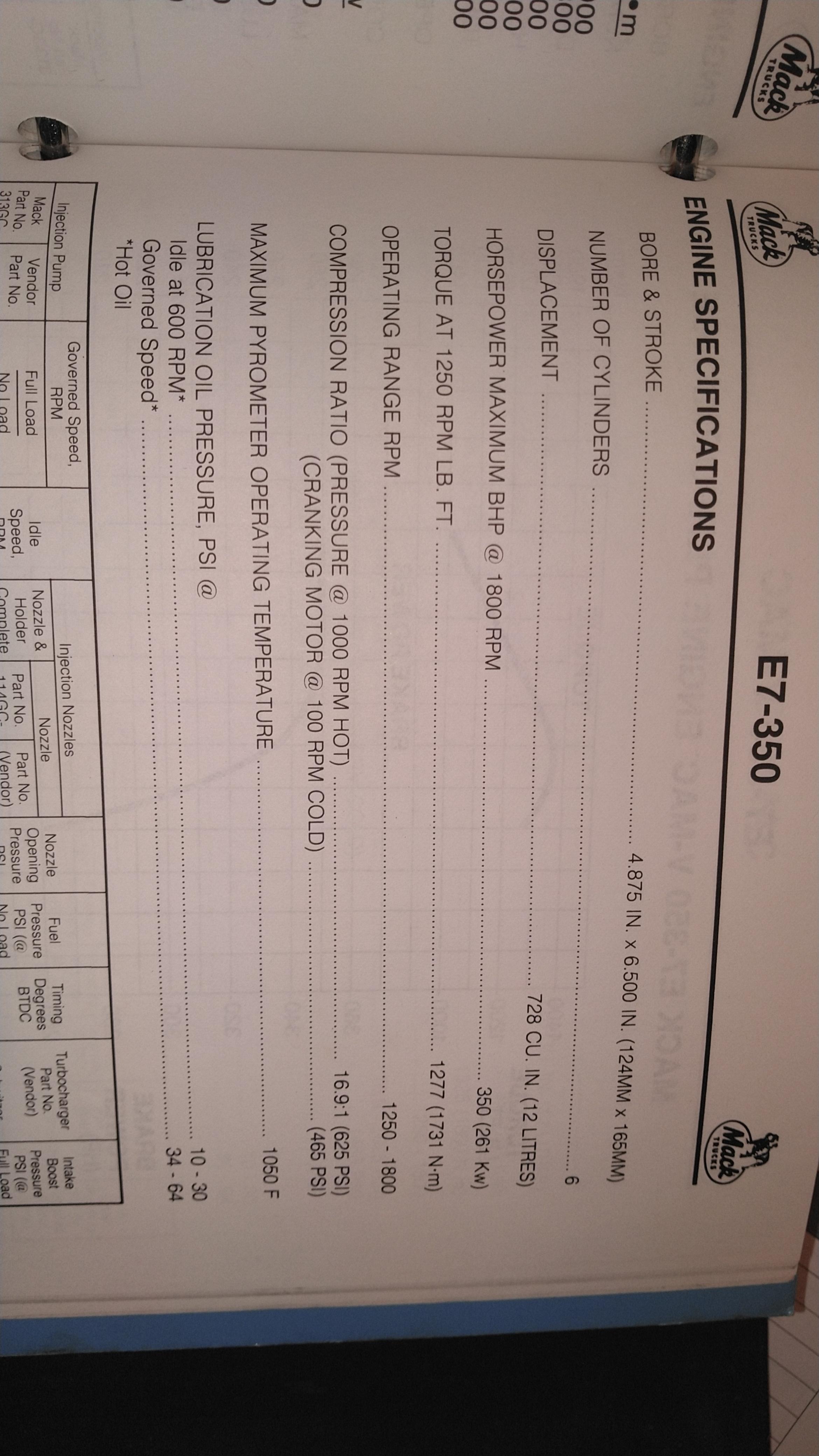

I certainly was WAY off.. I do not have the answer for the E-6...  sorry... but this picture is from my 1994 book, non-V-Mac specs. It seems to me that it is probably close to that of the E-6 that you have.  I dont know if I helped, but,,,,   anyway... post the answer when you get it, just curious... jojo

and a 2 valve at that..  the 4 valve was out 2 -3 years before..  or so i thought..  the last 2 '87 RW's I worked on were 4 valves..  Like I said,, I am bout to learn more stuff,,,,  👍jojo
