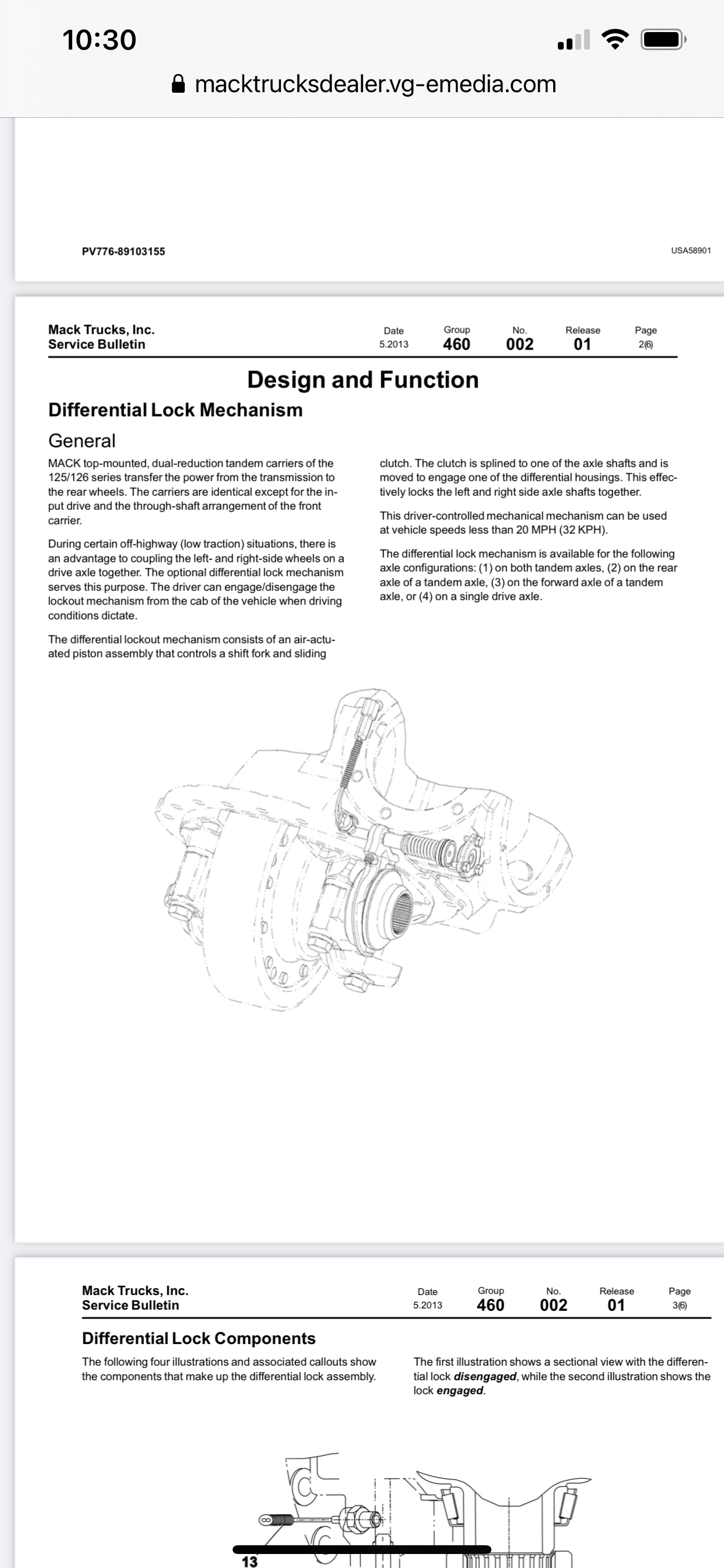

I have a 2022 Granite that also has intermittent diff lock alarm.
Mack recall service was done, and still get the alarm coming on intermittently.  When this happens, the diff lock was on earlier in the day, then turned off, then the alarm comes on itself shortly thereafter (anywhere from 10-45 minutes later).  Driver quickly pulls over, engages and disengages the diff lock, and continues on.
Checked the solenoid (both electrically and pneumatically) to confirm that air was not inadvertently actuating the diff lock to due an electrical short or failed valve and found no issues.
I have considered changing the spring that retracts the plunger (and unlocks the diff) once the air pressure is turned off, and am very curious about Mackpro's comment on the spring.
Mackpro, is there a stronger spring available?  Is this a common issue?
