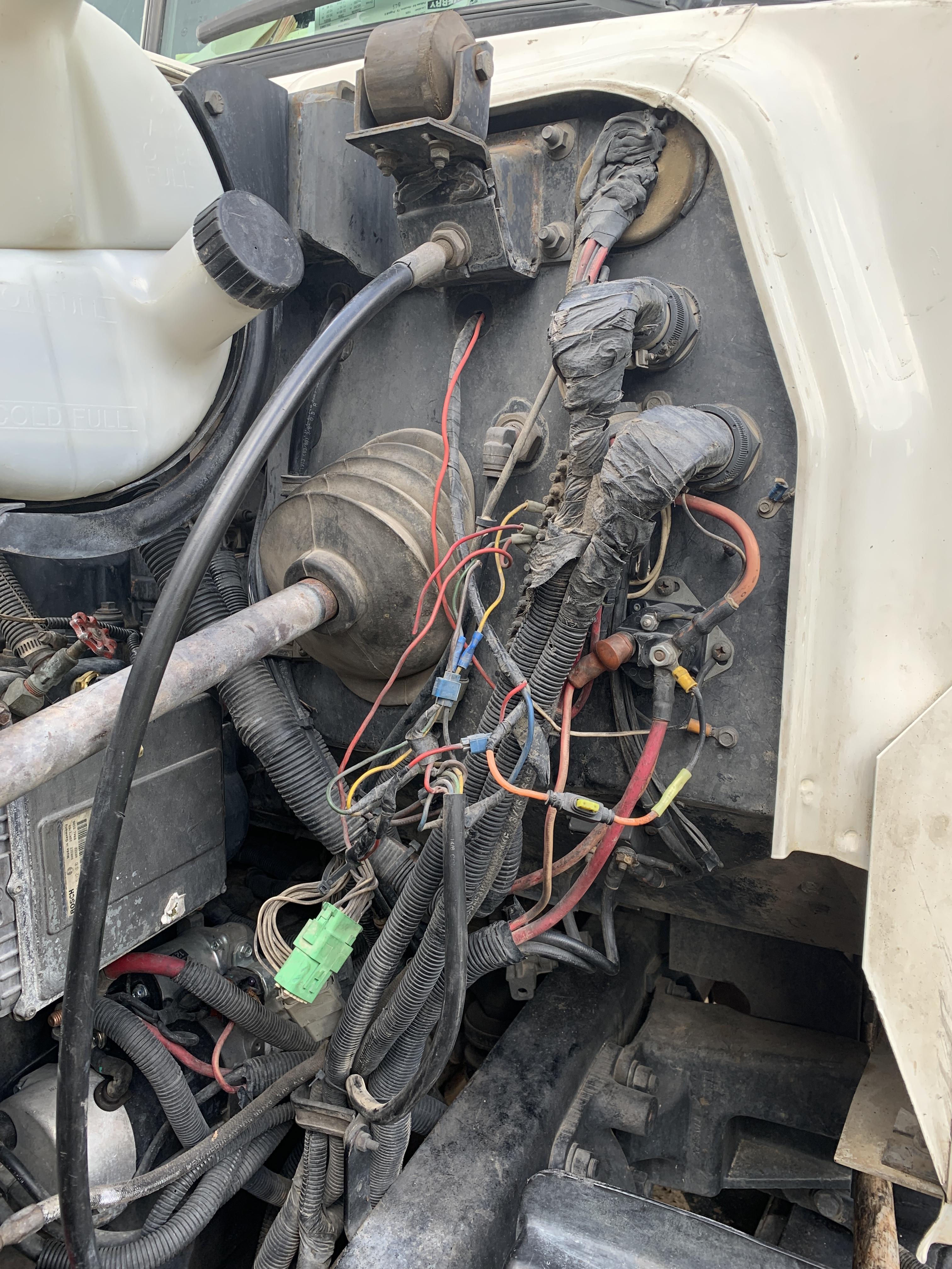

What is the oil pressure gauge showing..?   That model has a sensor and an oil line to the gauge..  DO NOT....  load the ECM parts cannon!!!  I bet this issue is simple...  Check the grounds behind the dash behind the gauges and near the fuse panel,,,  the ground bolt on the block in front of the starter, the ground on the frame behind the left steer tire,, the ground breaker on the firewall next to the starter relay...  there may be an accessory relay under the ashtray, that needs it connections checked..   None of these checks require's you to open your wallet...   Jojo

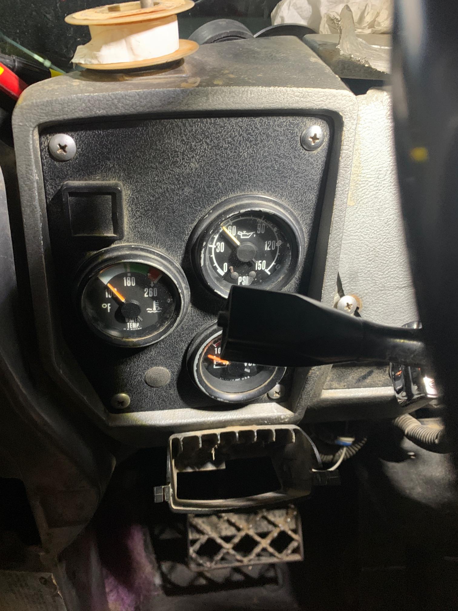

The oil gauge does respond and this is what it shows when I turn it on and shutdowns shortly after.

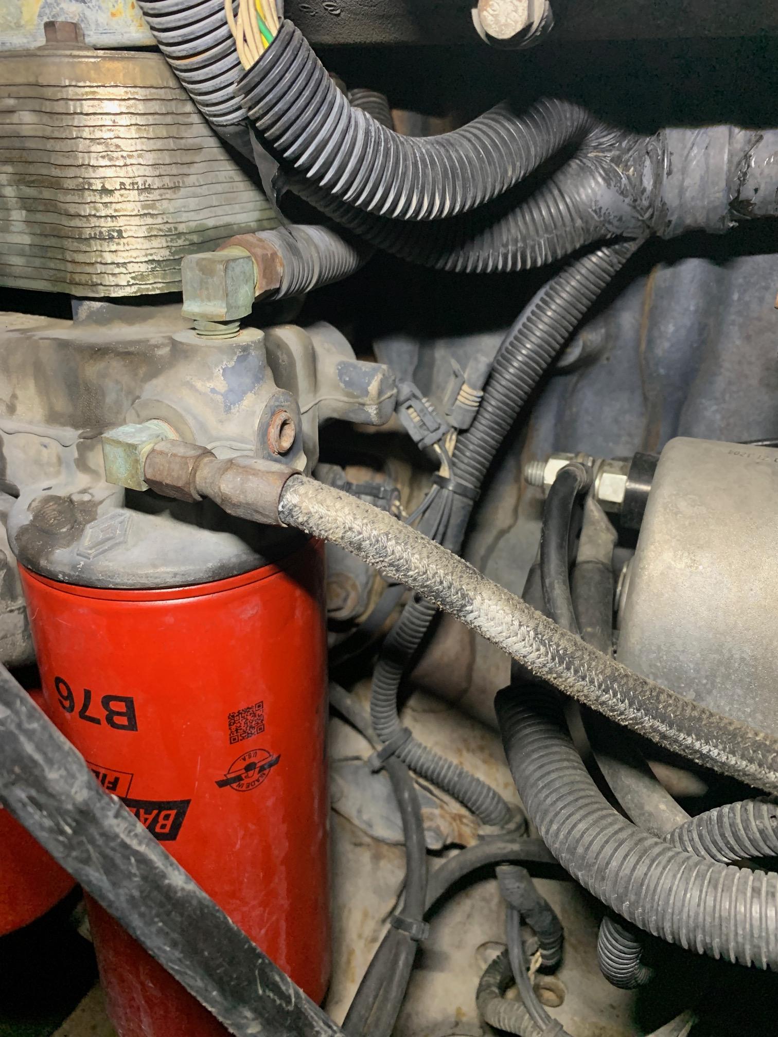

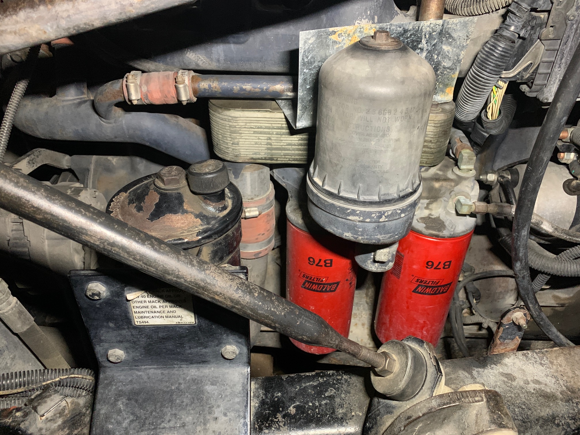

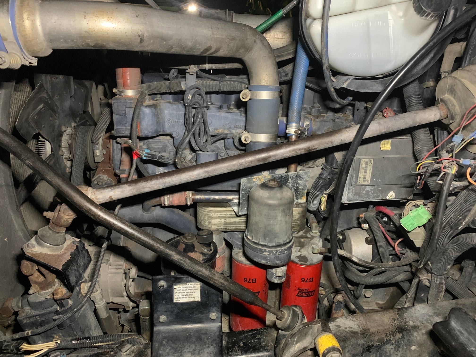

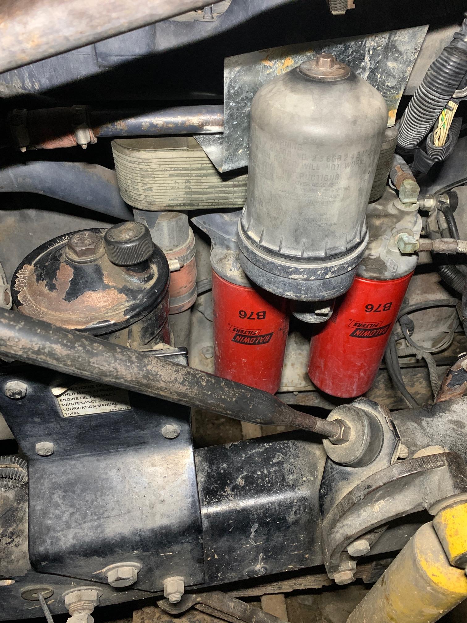

that gauge is hydraulic,  GOOD..  there is a sensor on top of the oil filter pad above the centrifugal filter..  If it is bad, it will tell the EECU that oil pressure is 10 PSI or less, then 10 seconds later , the engine shuts down..   jojo
top of the oil filter pad above the centrifugal filter...Difficult understanding where.
And is the water level sensor on the external water tank
Edited by htx-em7-2000

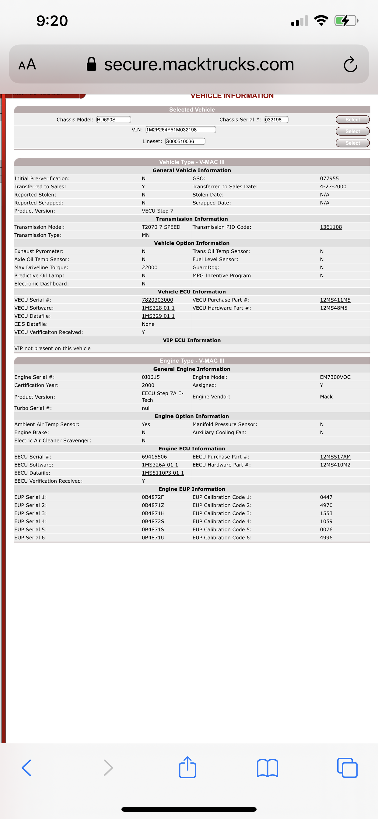

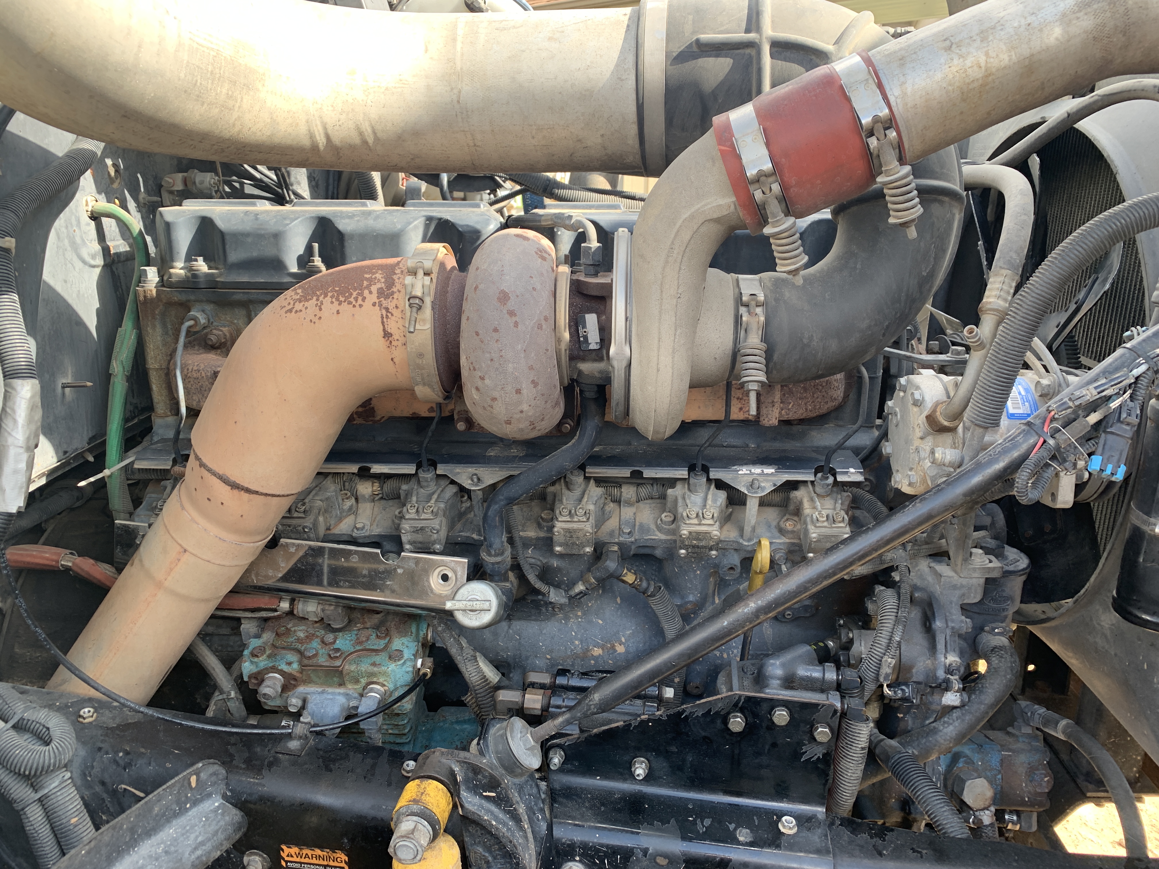

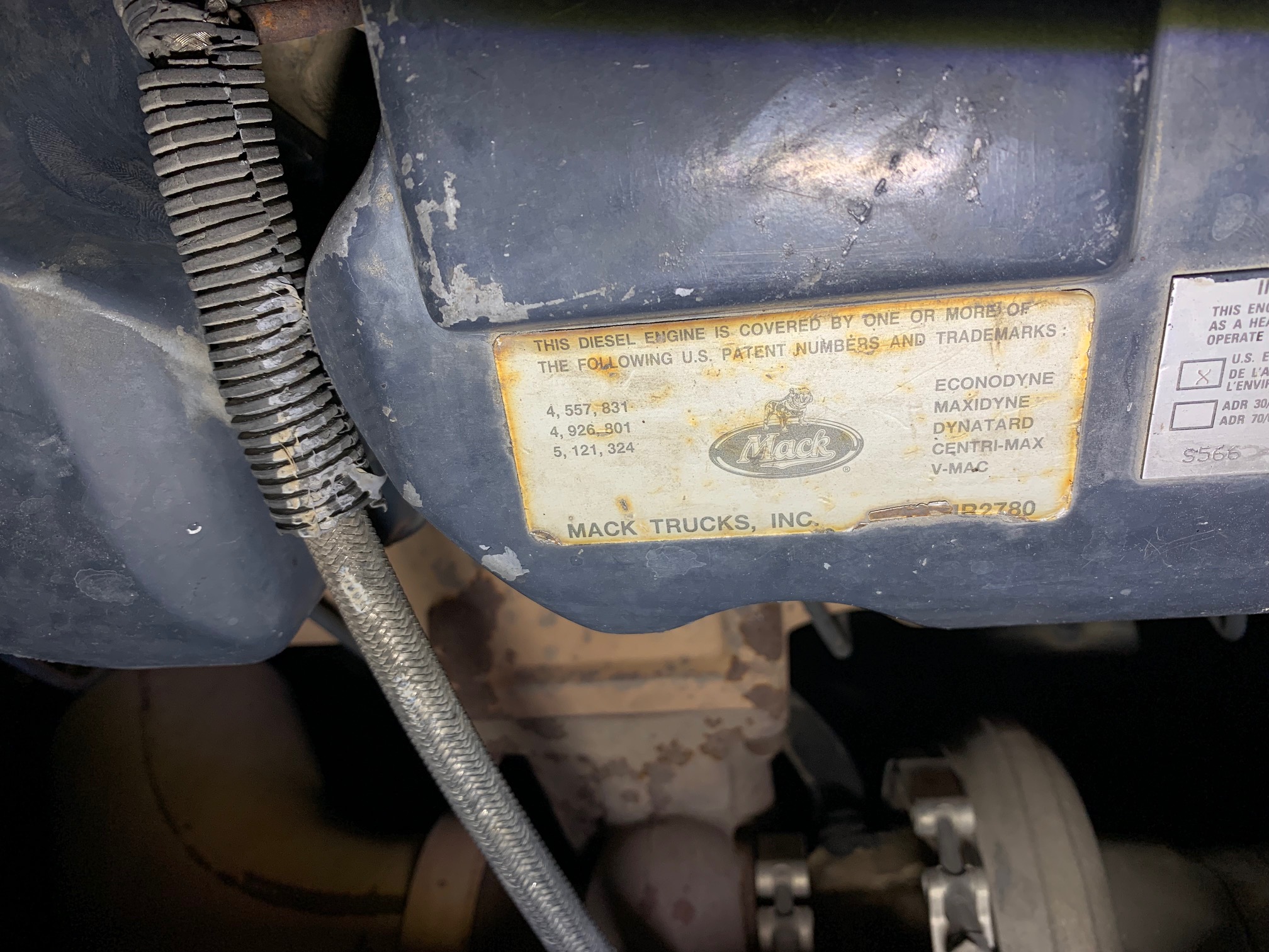

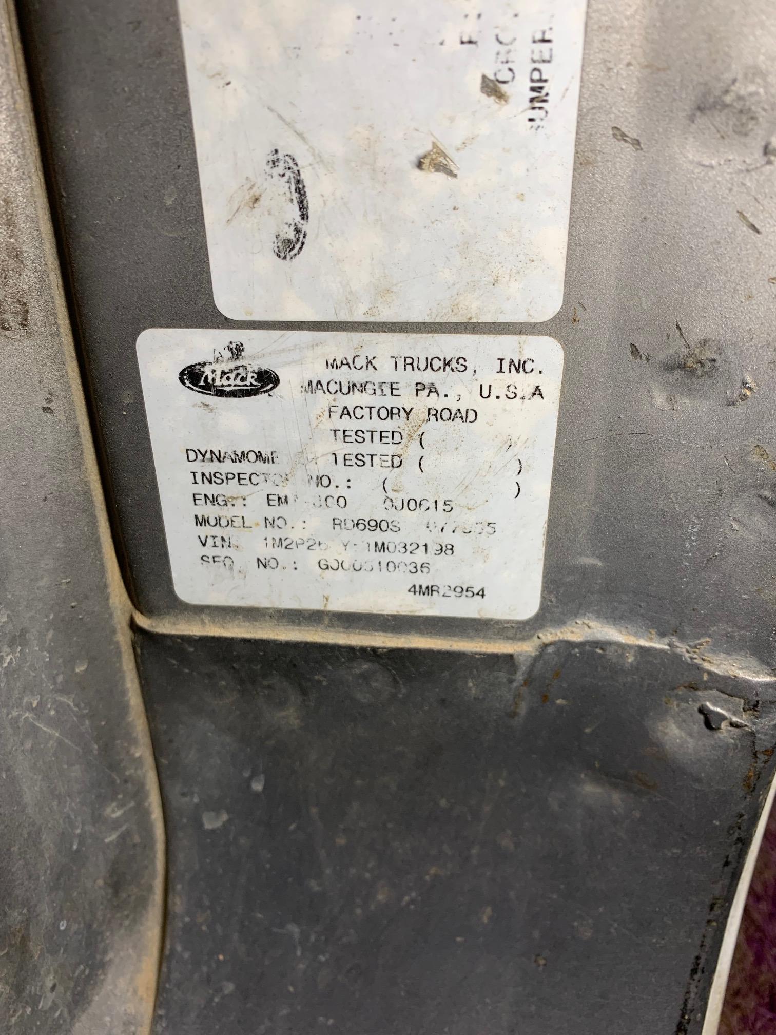

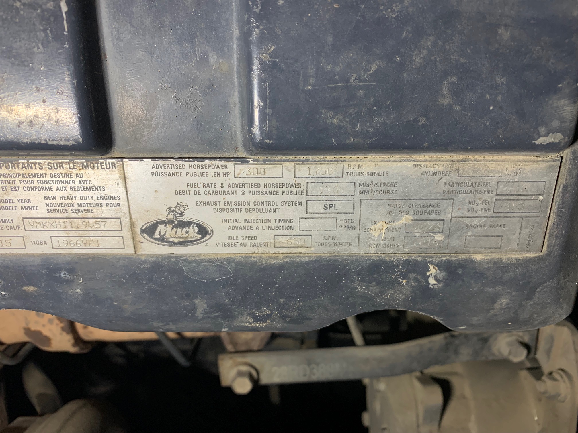

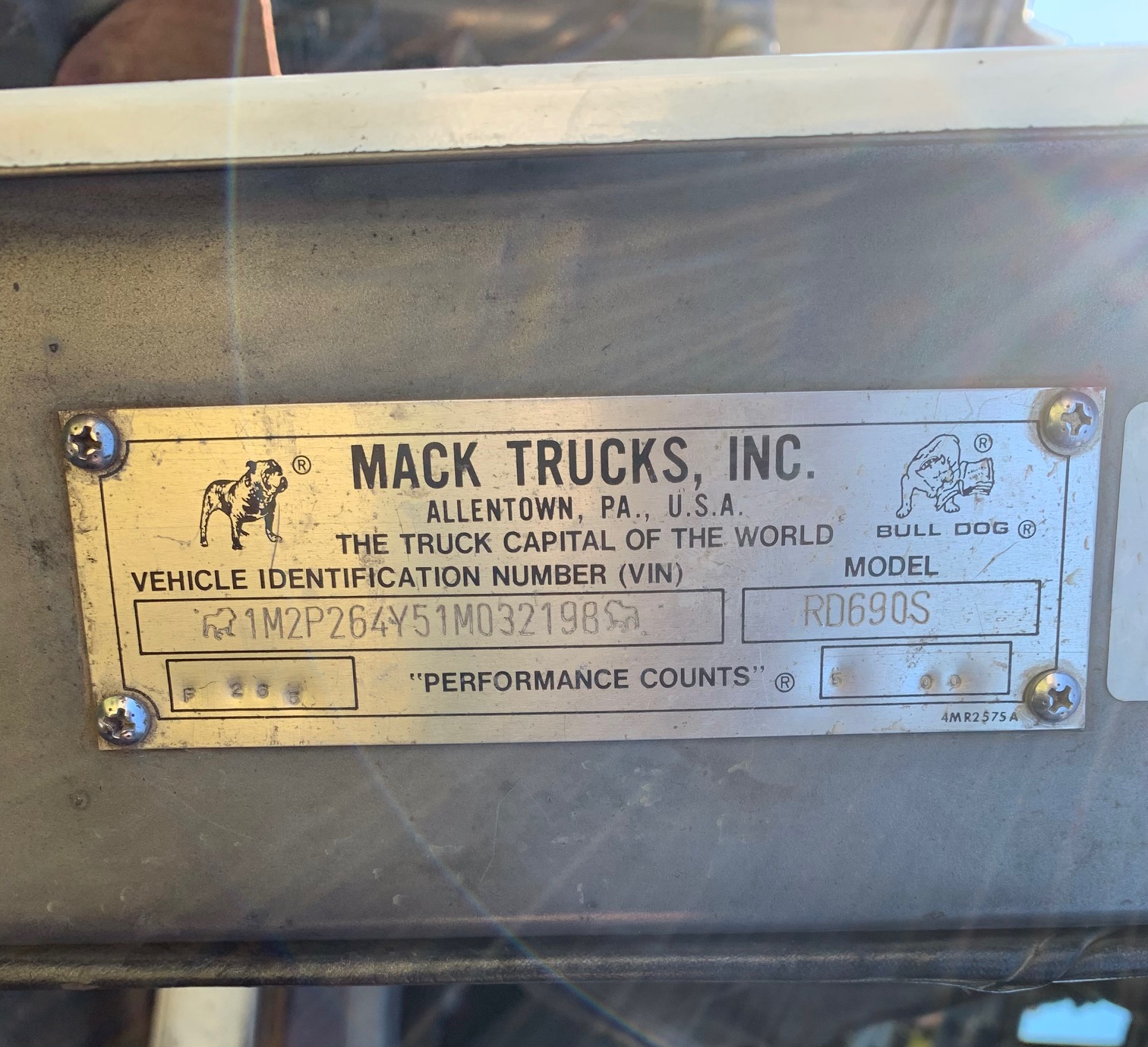

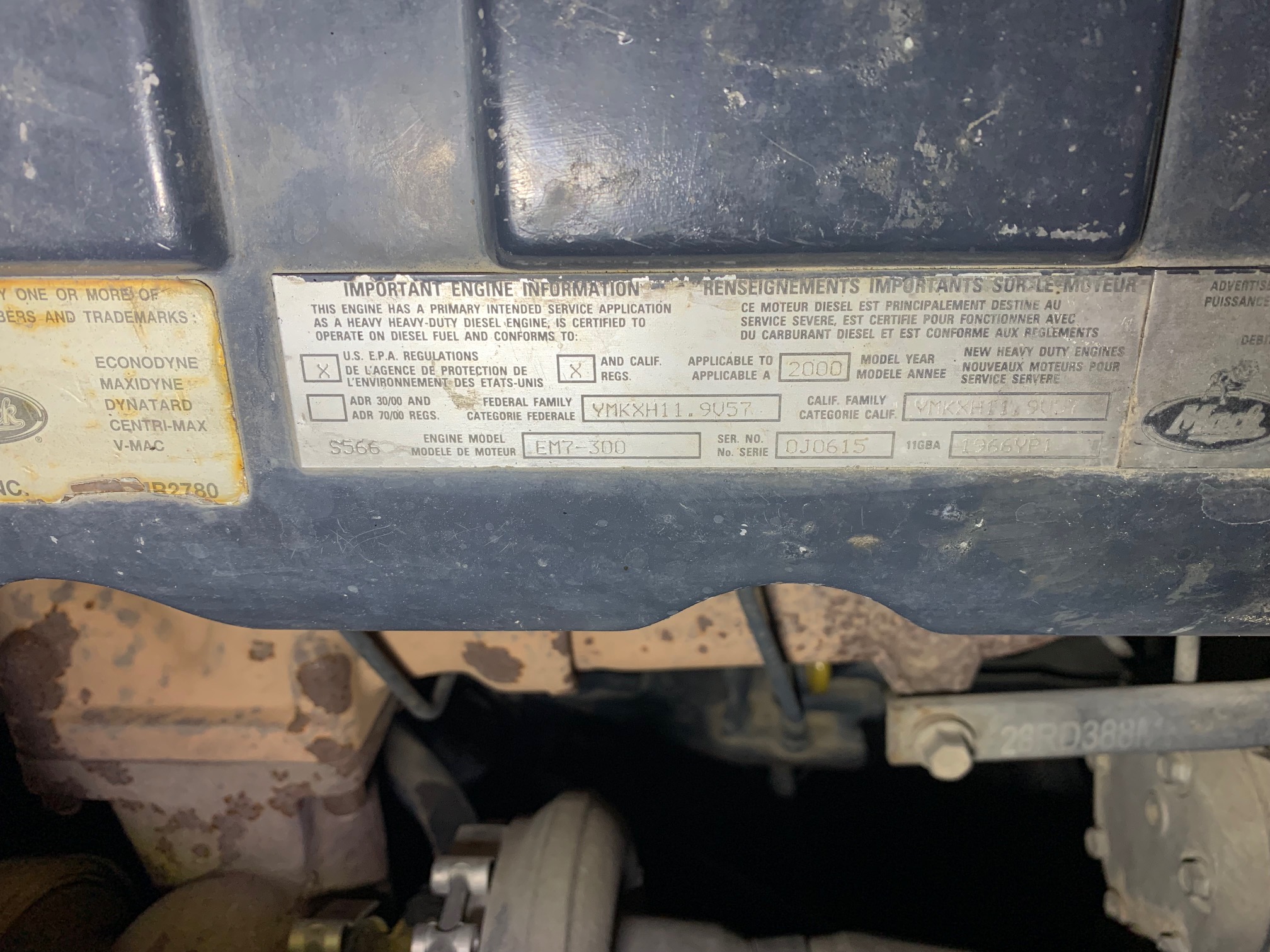

Thats not a 2000 E-Tech...  Thats a CCRS...  what does the door tag look like?
Hmmmm..   Something doesnt match up here..   I have to admit,,,,  I don't recall that engine arrangement in a 2000 model..  Maybe you have a late build for that year..  I'm sorry, but I will wait for some other post's, to see where this goes.  I thought that series came out in 2002...  jojo

1 hour ago, 880joe said:

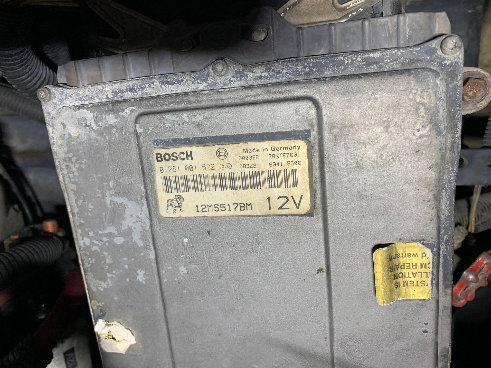

Joey are you sure that's not an etech with left side ecm? That ecm number is the newest number my dealer said would fit my early etechs

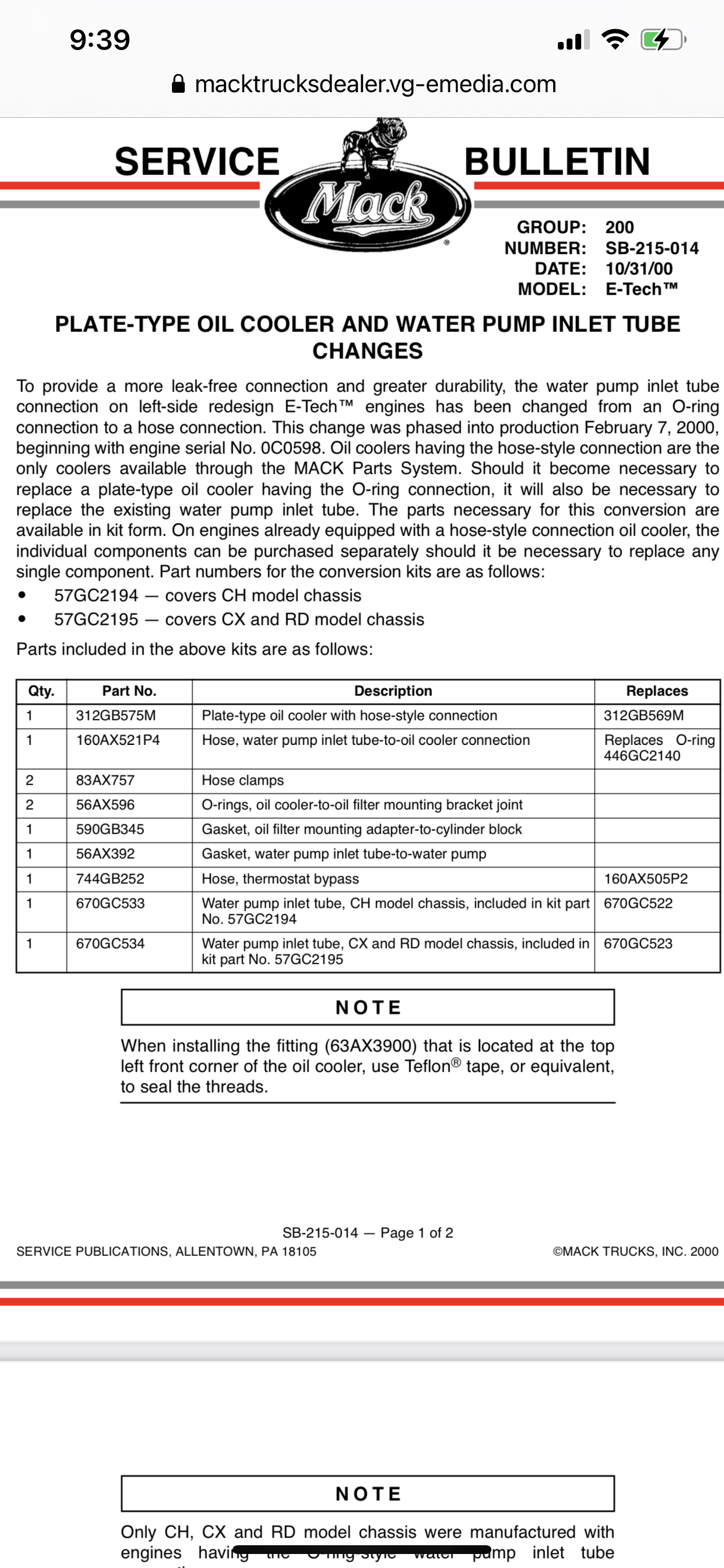

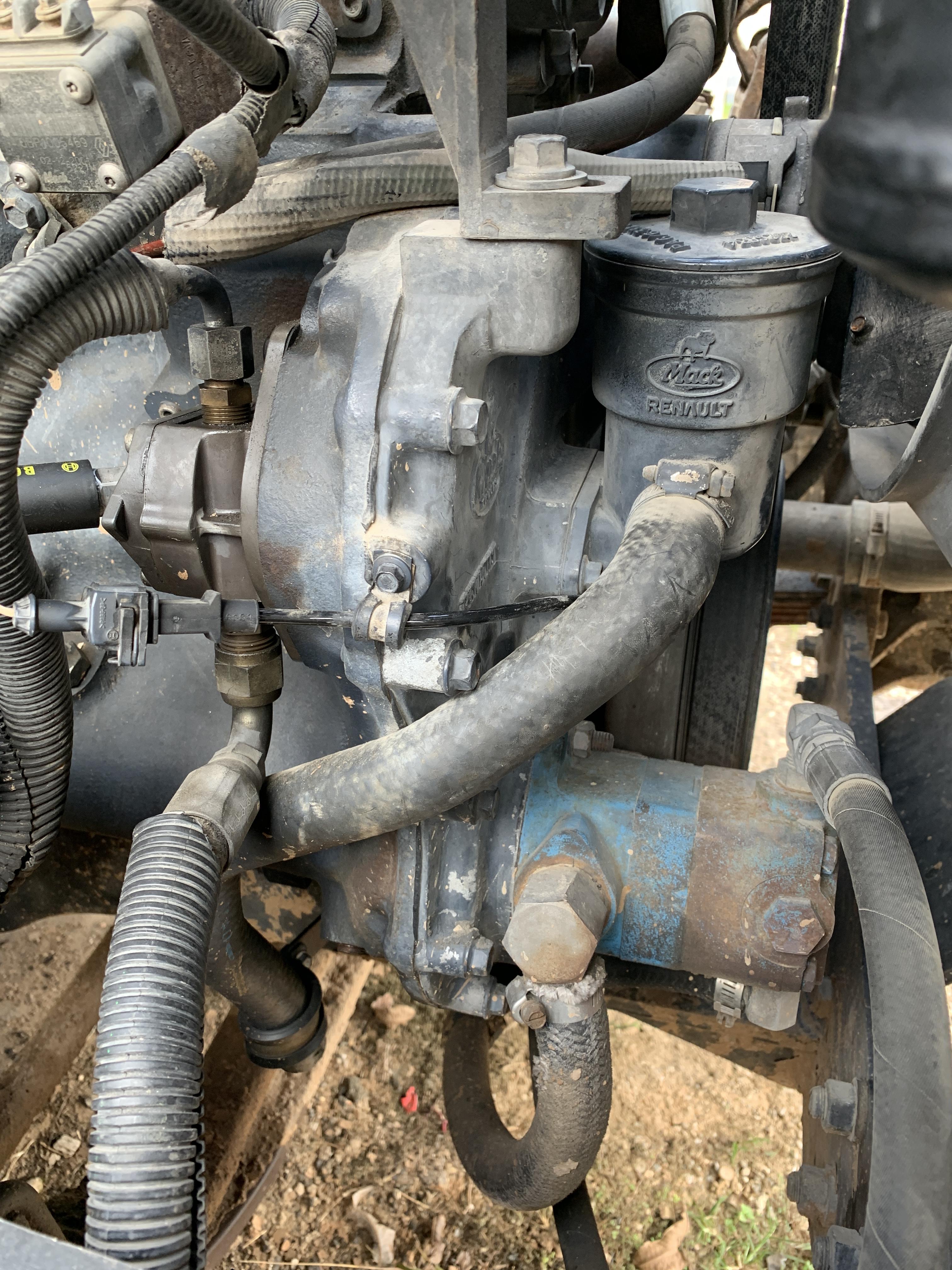

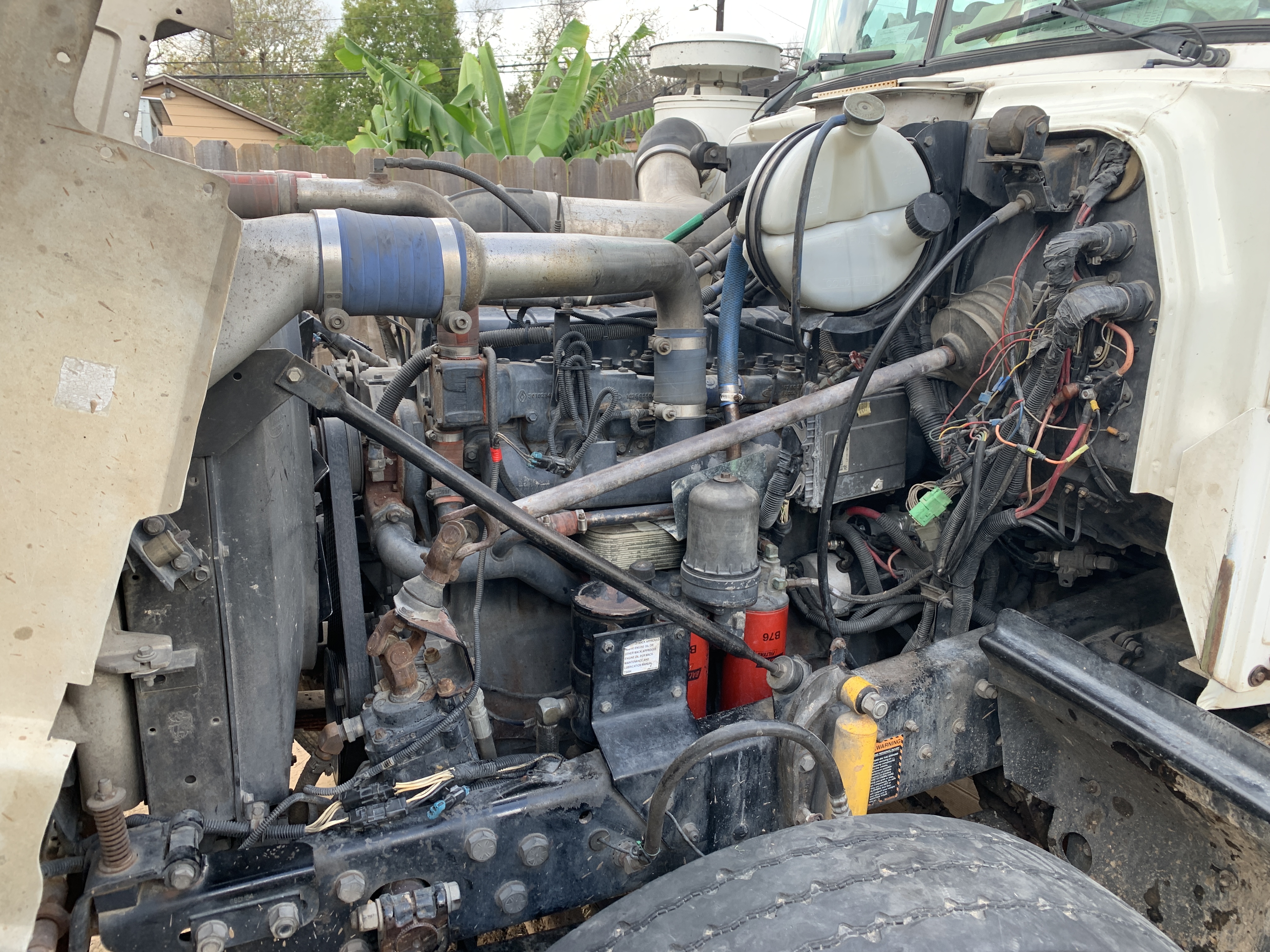

I'm not sure at times..  What has my attention is the centrimax filter style and the plate type oil cooler..  I would have expected the hanging filter,  and a bundle type oil cooler..  I also dont see the oil pressure sensor, installed into the filter pad... as far as the ECM,,  I thought they were on the right under the heat shield below the turbo, and got moved to the left side due to heat off the exhaust?  I guess i'm getting rusty fast, since I have been away from them for a few months..   :)  Jojo
Remember that 1 you built for me was a early etech with plate type oil cooler and left side ecm then we changed it to bundle type cooler and right side ecm
Edited by 880joe
yes, but it was a 2002 engine..  I guess i missed those days at school..  :)   Thanks for clearing that up.  I really thought it was a CCRS...  I have been confused before, when it comes to what year a change was made..  Jojo
2001 saw the changeover to the left side ecm I believe. With info provided initially I'm thinking this is a simple power issue. He said engine dies, as well as battery voltage.  This tells me there's a power supply fault. Do these use the relay under the ash tray for power like the pre-Etech R models?
