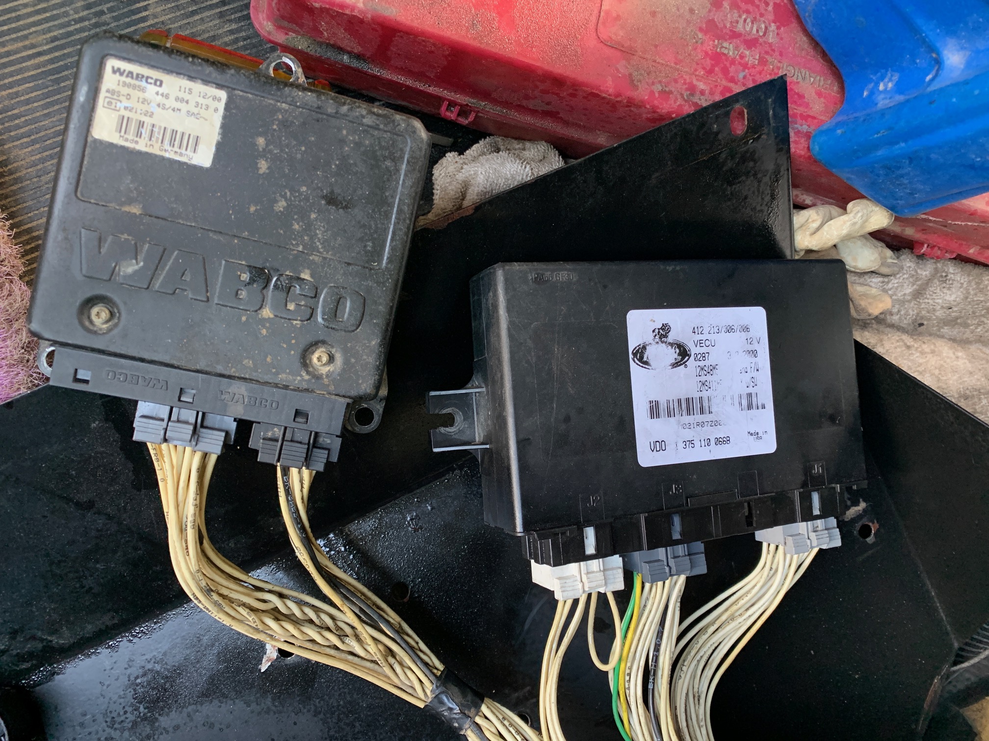

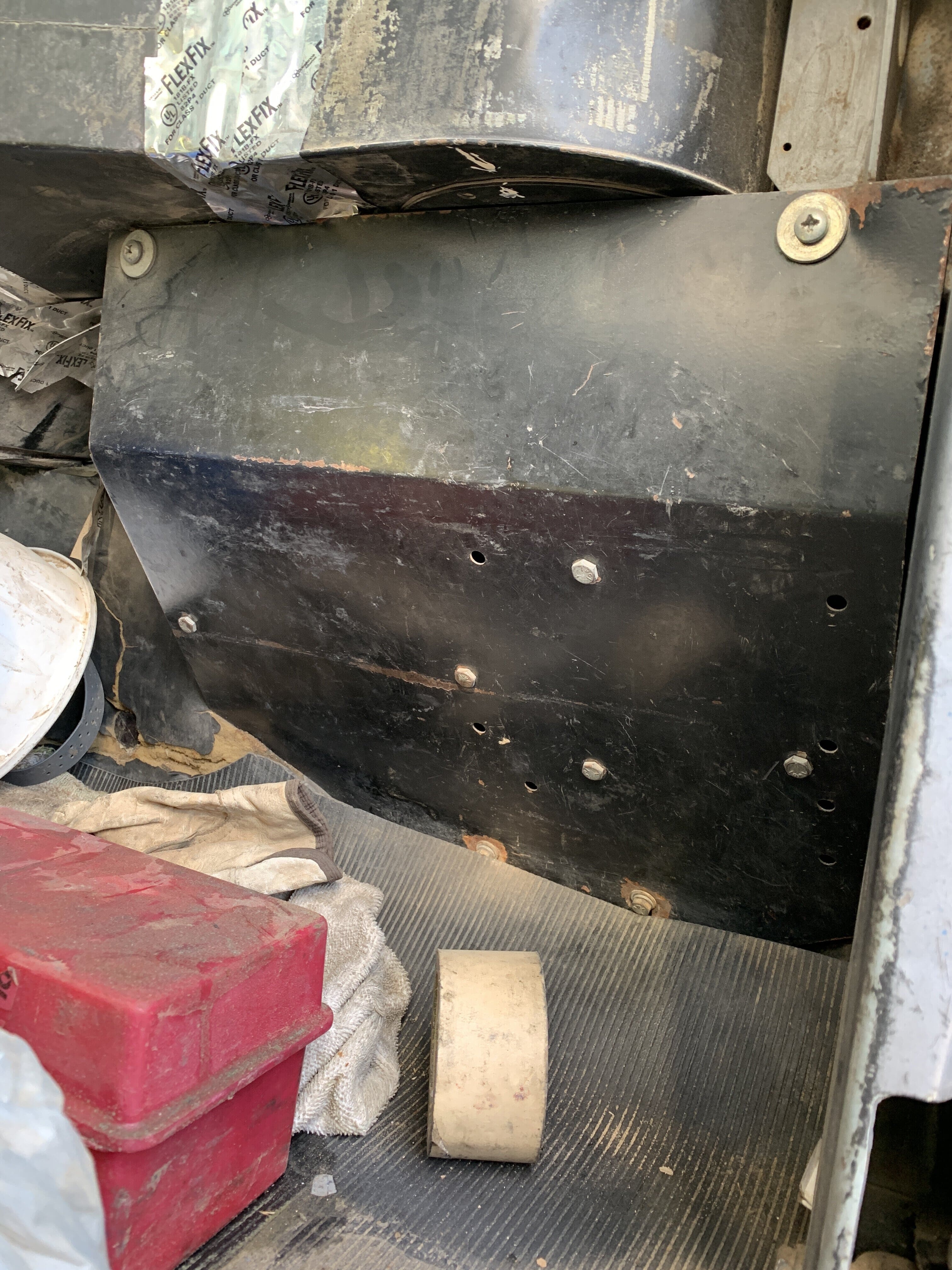

I don’t know if I mentioned this. Common problem with R series trucks with ETECH engines. The VECU ( vechicle electronic control unit) is mounted on the kick panel in front of the passenger seat down by the floor. The factory mounts it to the kick panel with the electrical connectors facing up . The windshields are bad about leaking and when the RH side does it drips right down onto the VECU. I have found the VECU’s to actually have water in them. This causes all kinds of crazy problems. Issues include having to crank engine 8-10 seconds before it will start, various guages not working, engine won’t die when you turn the key off until 8-10 seconds pass, low power/ sluggish response. This is because the high speed J-1939 data  link is down and it’s running off the slow/low speed data link J-1587 so everything is responding super slow.
Expand
Would i remove that black panel to locate VECU
Edited by htx-em7-2000
Disconnected all the terminals and found that J3 terminal of the VECU when plugged back in 1 by 1 was responsible for the red shutdown light to function.
Now when we turn the key the red shutdown light doesnt stop ringing. It lets us turn it on but shuts down seconds after.
What did yall want us to do with VECU
  • Solution
one thing you can do is use your DVOM, and find a good ground on the cab, and check for continuity on all the pins in the J-3 plug..  that may point you towards a short to ground..  are you familiar with how to read the wire codes on the white wires?   It is actually easy to do, and really helps when you are checking the wires at a distance from the VECU..   jojo
Edited by Joey Mack
poor sperring..
Was the VECU with the connectors facing up or down? Was there any green or white corrosion in any of the 3 connectors of the VECU? Inspect the green and yellow twisted wires that go between the VECU and the ABS module beside it . The green and yellow wires are the high speed data links .
Edited by Mackpro
