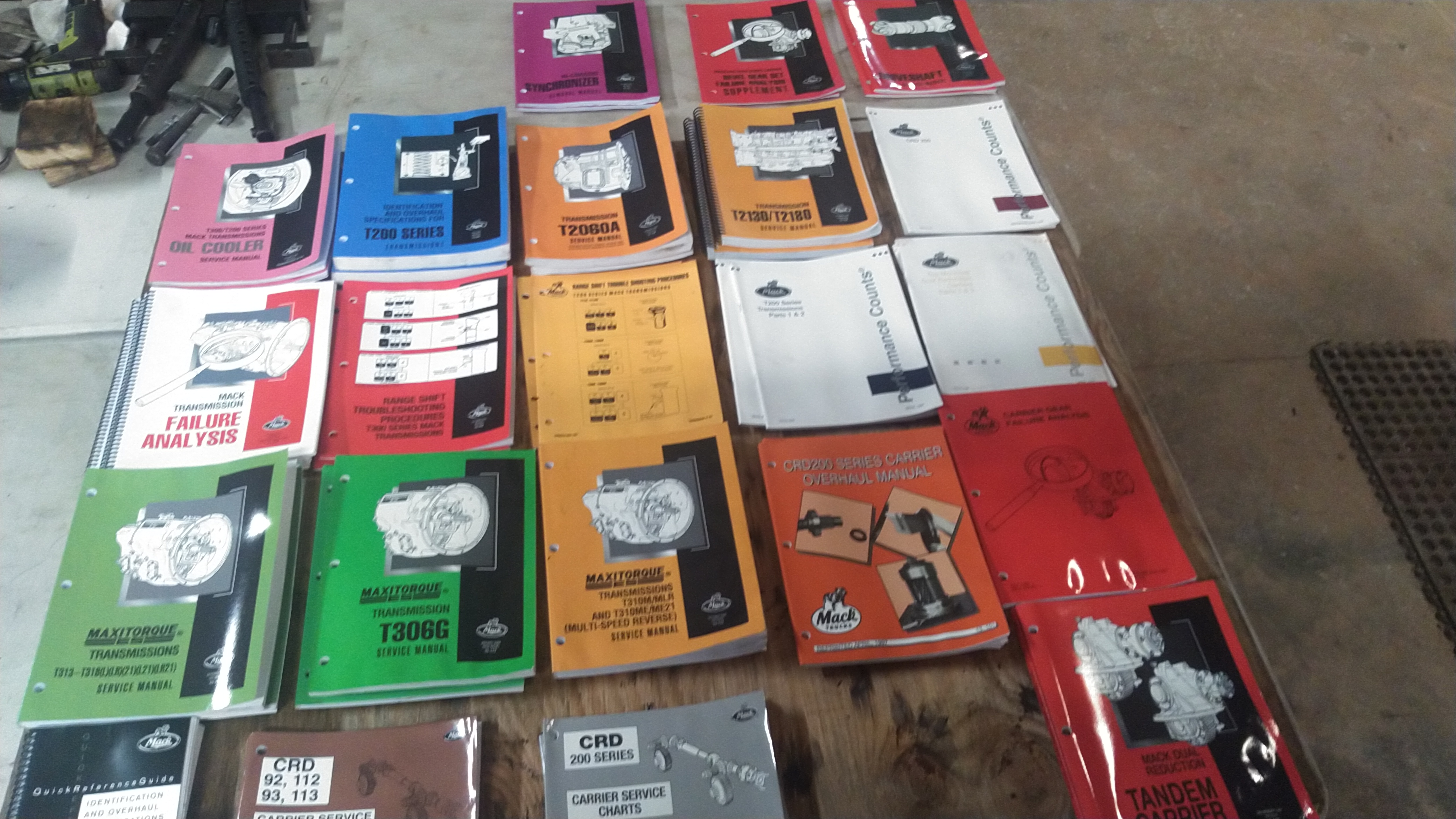

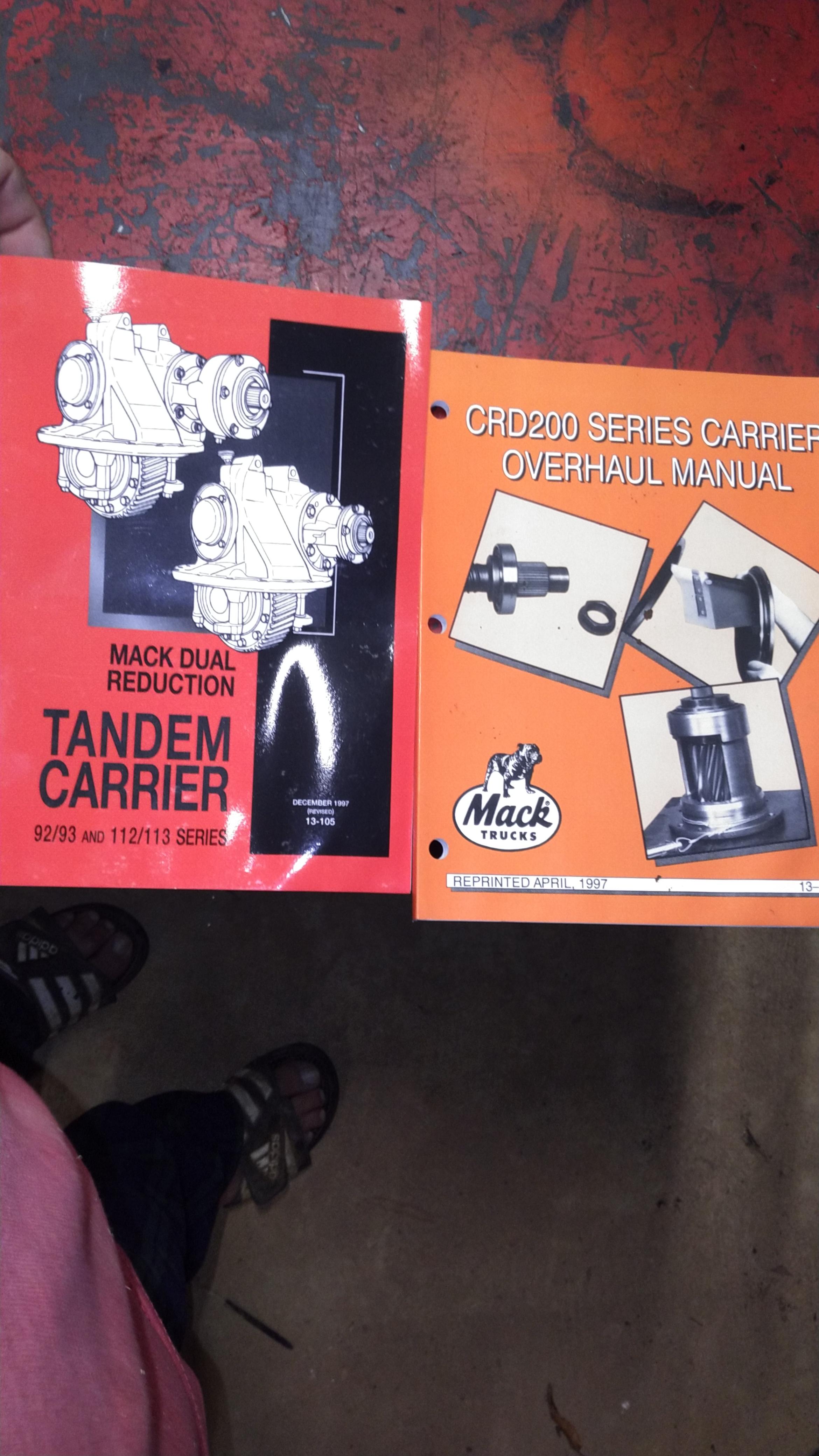

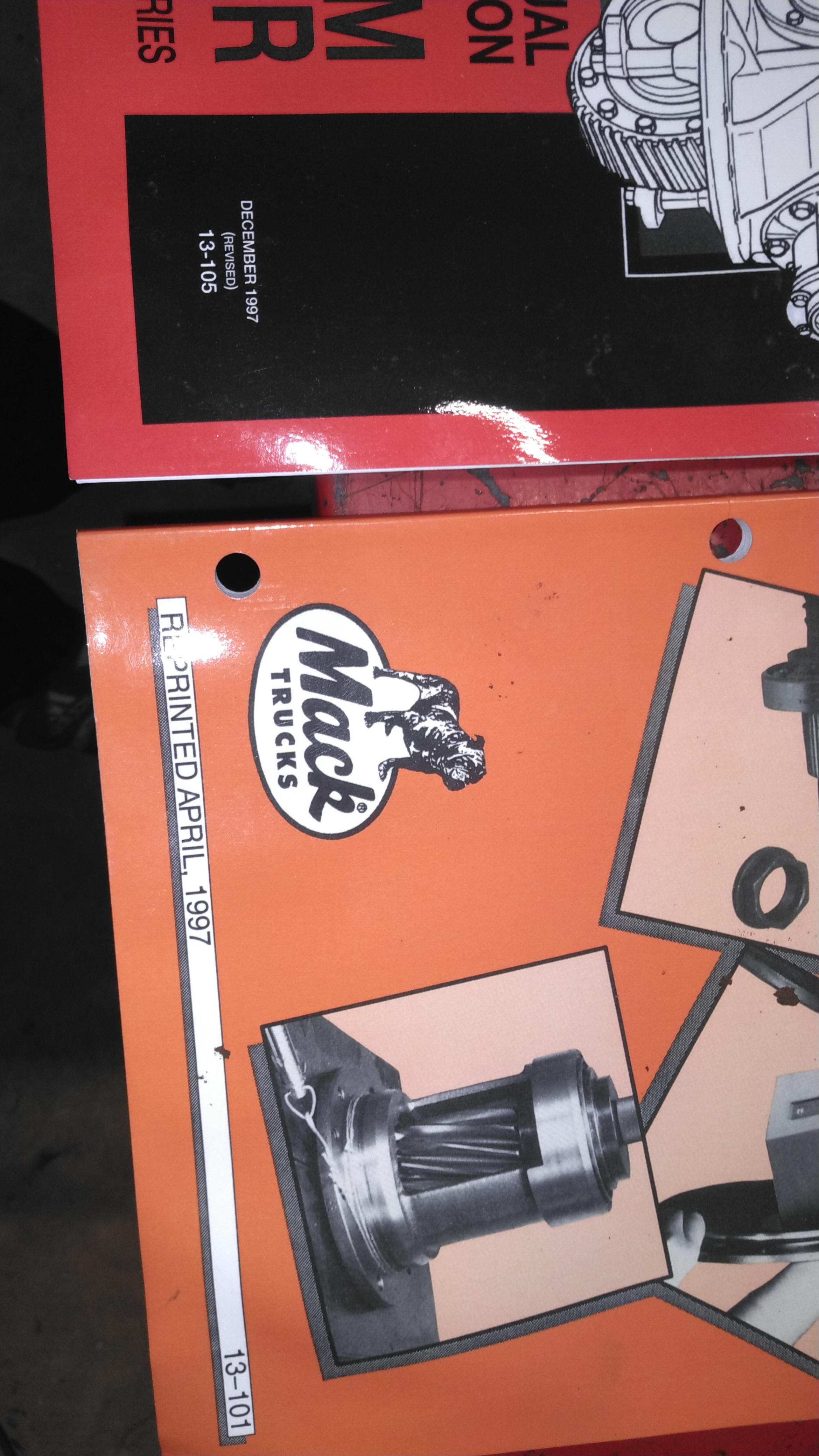

These are for Mack rears..  I expect you to have 92-93 series..  I posted the book for the 200 series anyway.  I have 2 new complete sets of svc. manuals..  P.M. me if you want to buy any of them..  You can search E-Bay for them. let me know if you cant read the book number in the bottom right corner..  Jojo
