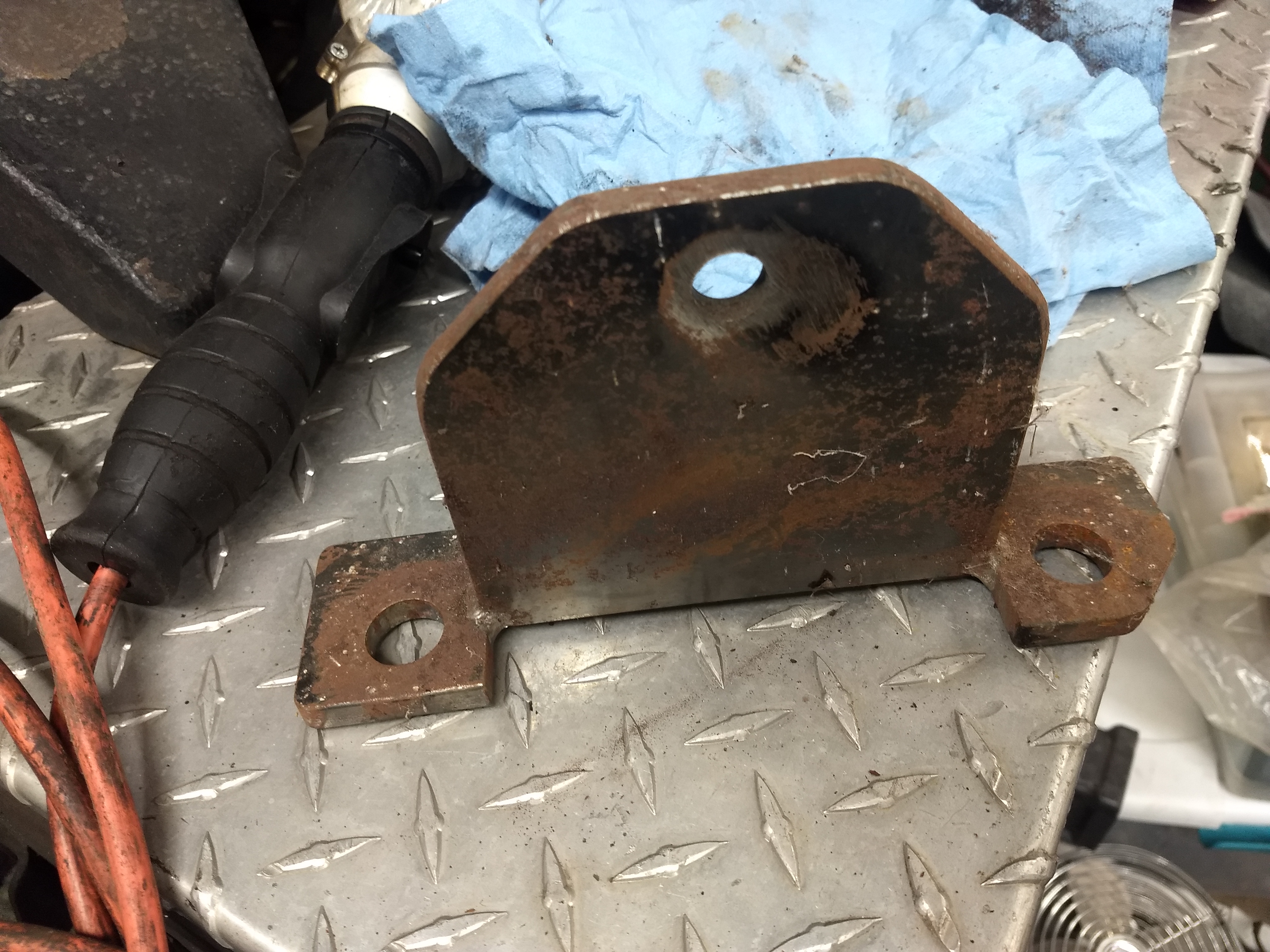

I should have a lifting bracket I made for mine.  It's been so long I don't recall what end I bolted it to.  Don't think I used headbolts either even though I pulled the heads off.
I'll see if I can find it and post a picture.

Hmmm, maybe I did use the head studs?  I just don't remember the details, or if I used this in the front or back?  It's like a 6.5" span across the holes.  It doesn't really fit well now since I put jakes on the engine.  The Jake spacers kinda block things.
Larry
