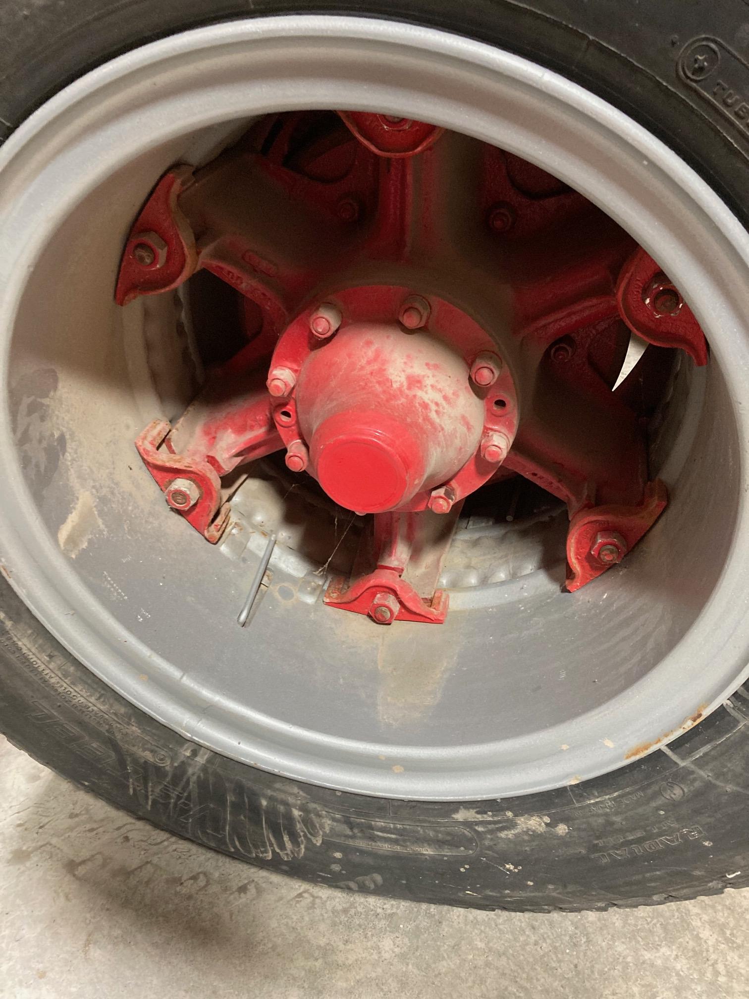

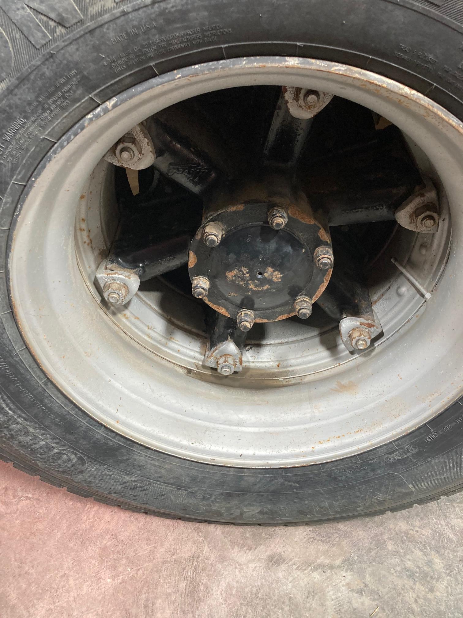

Below are two pictures. The first one is of the drive hub on my 1994 RD with 44,000lb rears. The second is of the drive hub on my 1960 B81 with what I think are 58,000lb rears. They have the infamous "cone" in the center of the hub. I am very familiar with wheel end tear down on the style of axle the 94 RD has. Unbolt flange and axle/flange assembly comes out as one piece etc. I have never messed with the B81 axles. I want to remove the wheels and hubs to get a look in there and get the brakes sorted and checked over. Is there any special process to follow with this style of hub? What will I see when I remove the cone? Is the axle shaft attached to it like my RD? Are the bearings in these axles running in an oil bath from the gear oil (like the RD) or are they packed in grease? I'm sure I have other questions but can't think of them now. Or I will have more when I start into the project. Thanks.
On the B - Model there may be a seal in the center of the inside of the hub.  I believe the back half is greased and the outer is in oil...  The last one I worked on, I removed the inner seal and put a modern seal in the inside.  So far after over a year, there's no leak.

Yup super heavy,if u decide to pull the spoke and drum this is the way to go,brake has to be fully backed off or disconnected,jack it up under the box,remove cone and outer bearings,slide a greased up smooth board under the tires,plywood works best say 16 inches by 4 ft,lower the truck just enough for the tires to contact the board,the spindle should be centered in the hub,give it a good pull and they will slide right off,reinstall the same way,u won’t believe how easy they will slide off and on, Safety First always,good luck..

Personally, when doing the board way... I have a piece of stainless 3/16 and similar to Mack's dimensions  (slicker than snot with some gear oil on it) . One thing you have to remember, years back you'd be taking wheels off like that for a brake job usually. (apart... brakes, a seal   back together)  if you get it apart and discover you need bearings or a drum, then this method gets as much work (or more) than taking it apart in the first place. The board way works, and probably way easier than comes to mind if you never did it. Trick is you only barely want the weight of the wheel end on the board. So you have to finesse it to the desired height with a good working jack.I also find if you have the other side of the axle on something like a 2 X 12 or something between the tires and the floor (or ground)  to level out the whole thing to the same height as the side jacked up helps.
