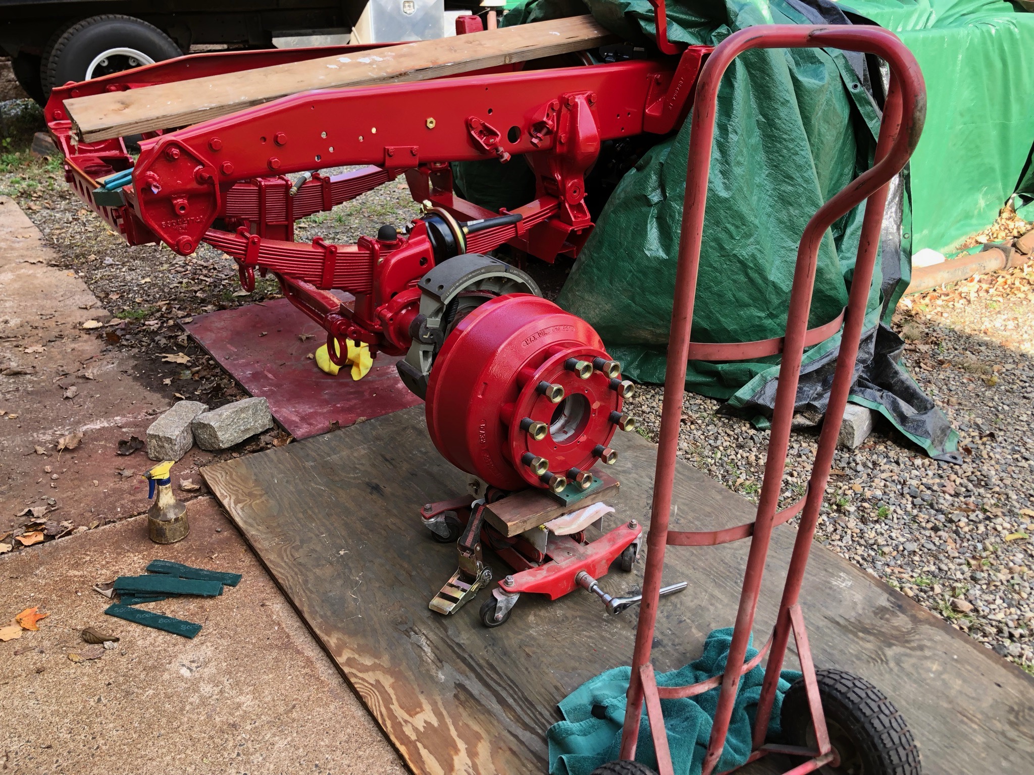

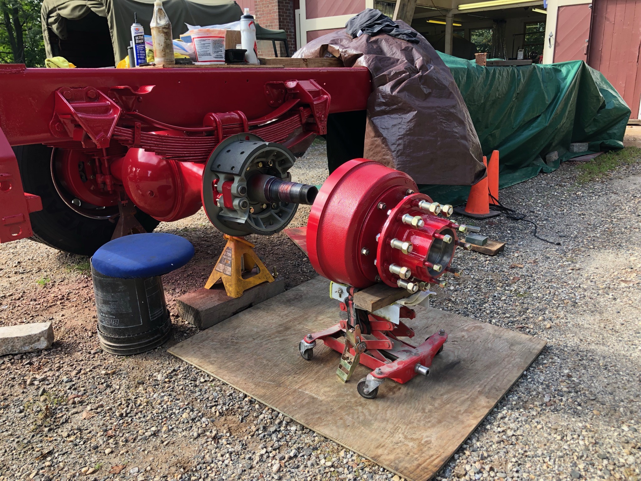

I swapped out the rear axle to one from a freight liner and for the front I got the hubs from a newer Mack (but any truck should work) and modified them to accept the bearings on the B-61 axle. I also had to put thicker lining on the brake shoes and turn down the new brake drums a bit.

To be fair, if you have to hire all the Machine work the conversion would get quite pricey. As far as wear goes, even if I was a kid still I don’t think I would live long enough to wear out a set of brake shoes and if I did I would just have them relined and same with the drums. Zero chance I could ever wear them out but if I did just do the same as I did the first time.
