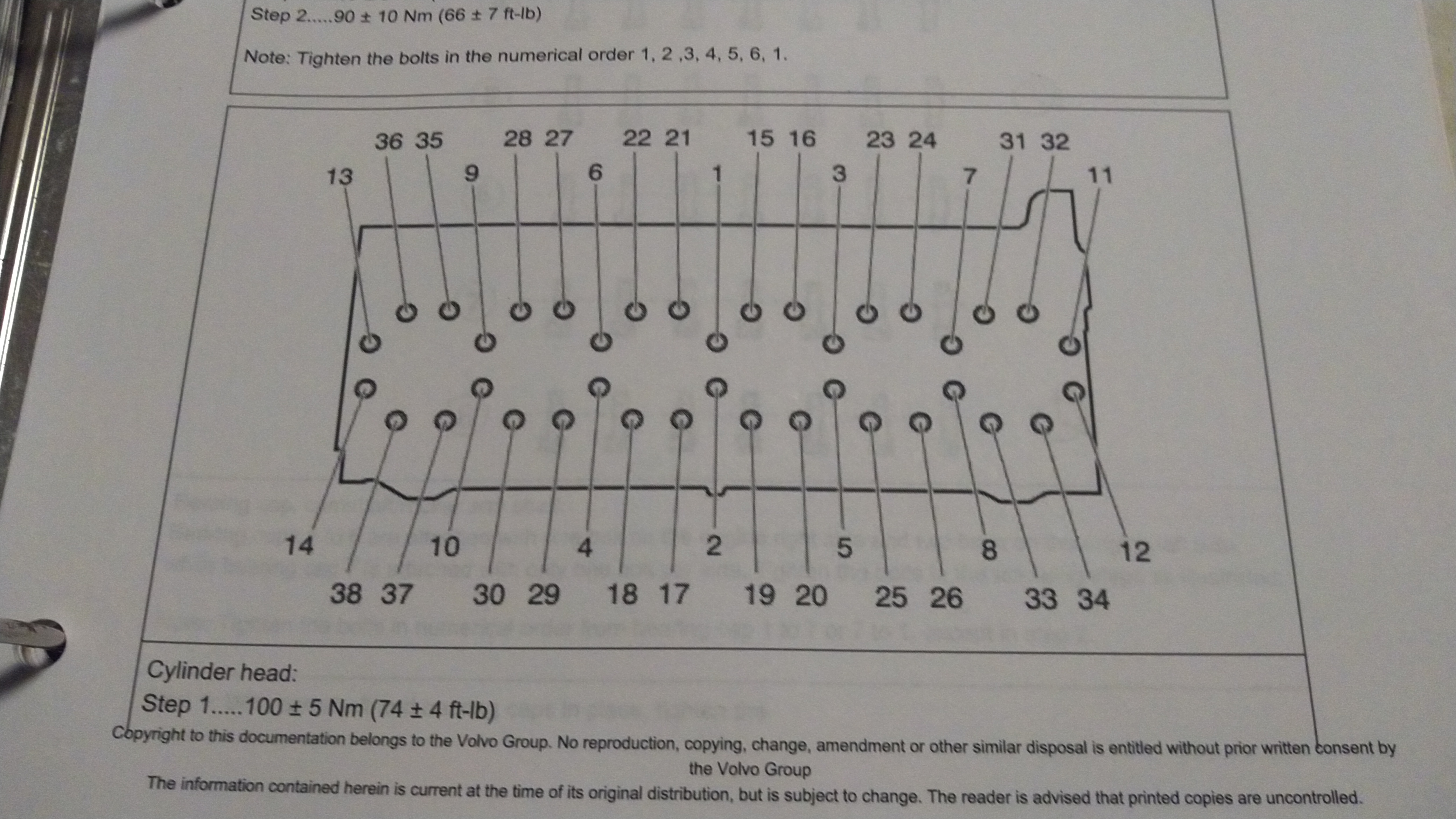

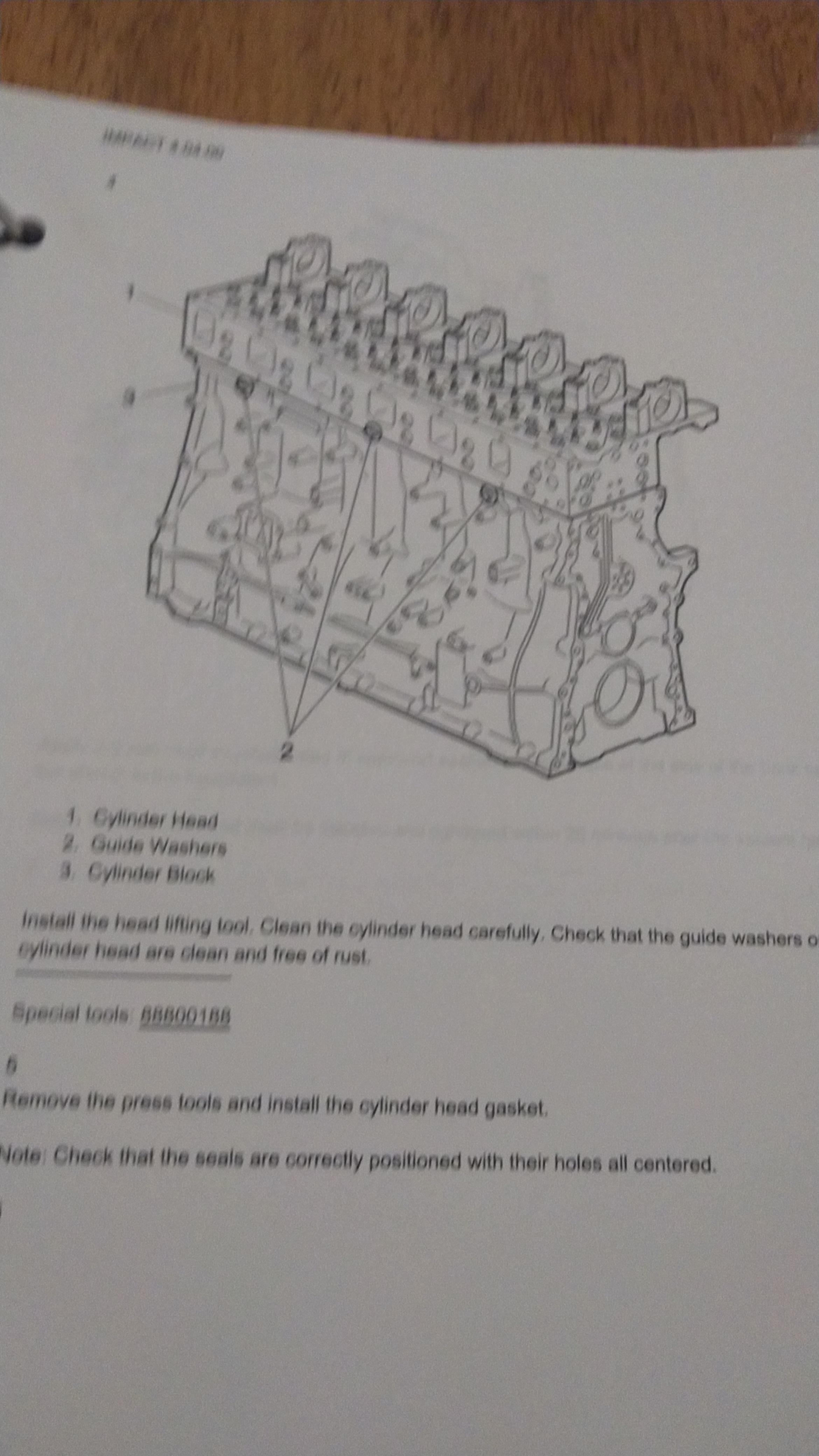

there is washers at the left front and rear corner of the block deck that is used as a stop and aligner.. It is crucial that the head is tucked into that corner..   I was looking for the book I printed, but havent found it yet..  Please dont just go puttin the head on before reading about placement..  improper placement will affect the gear train in a bad way..  I will keep looking.   jojo

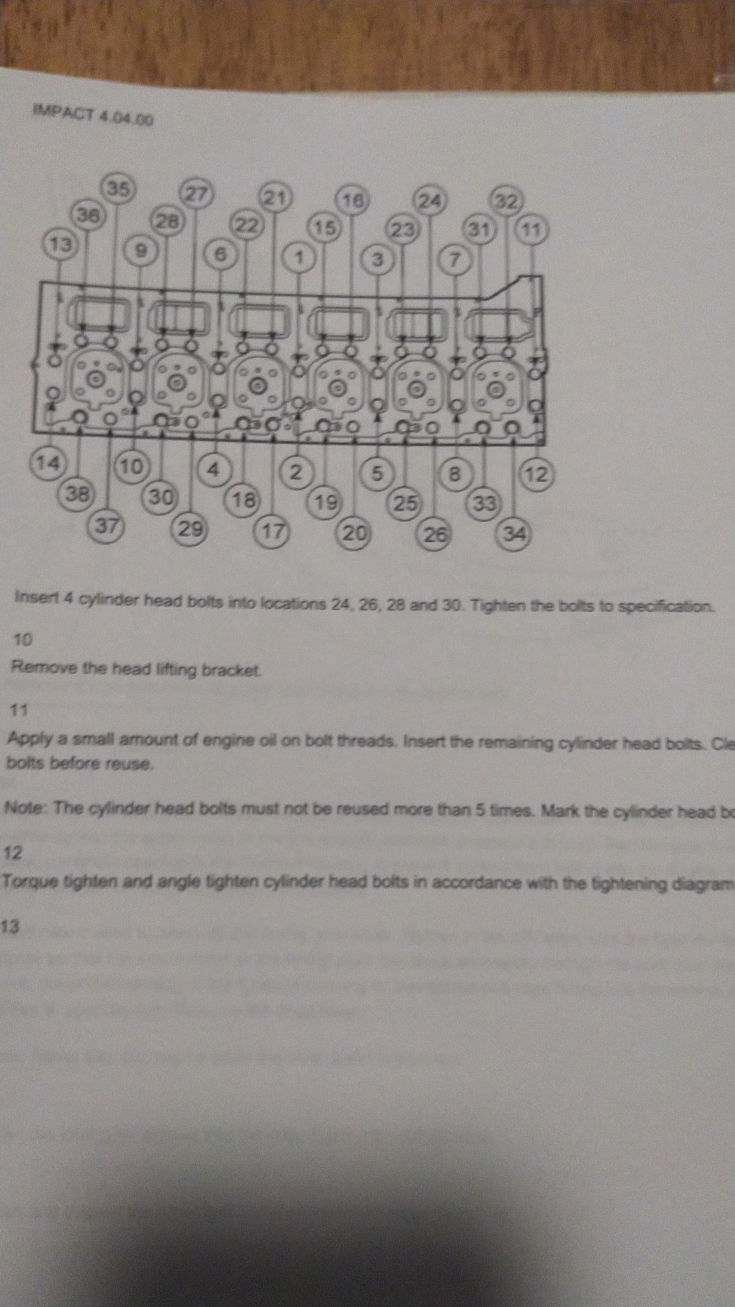

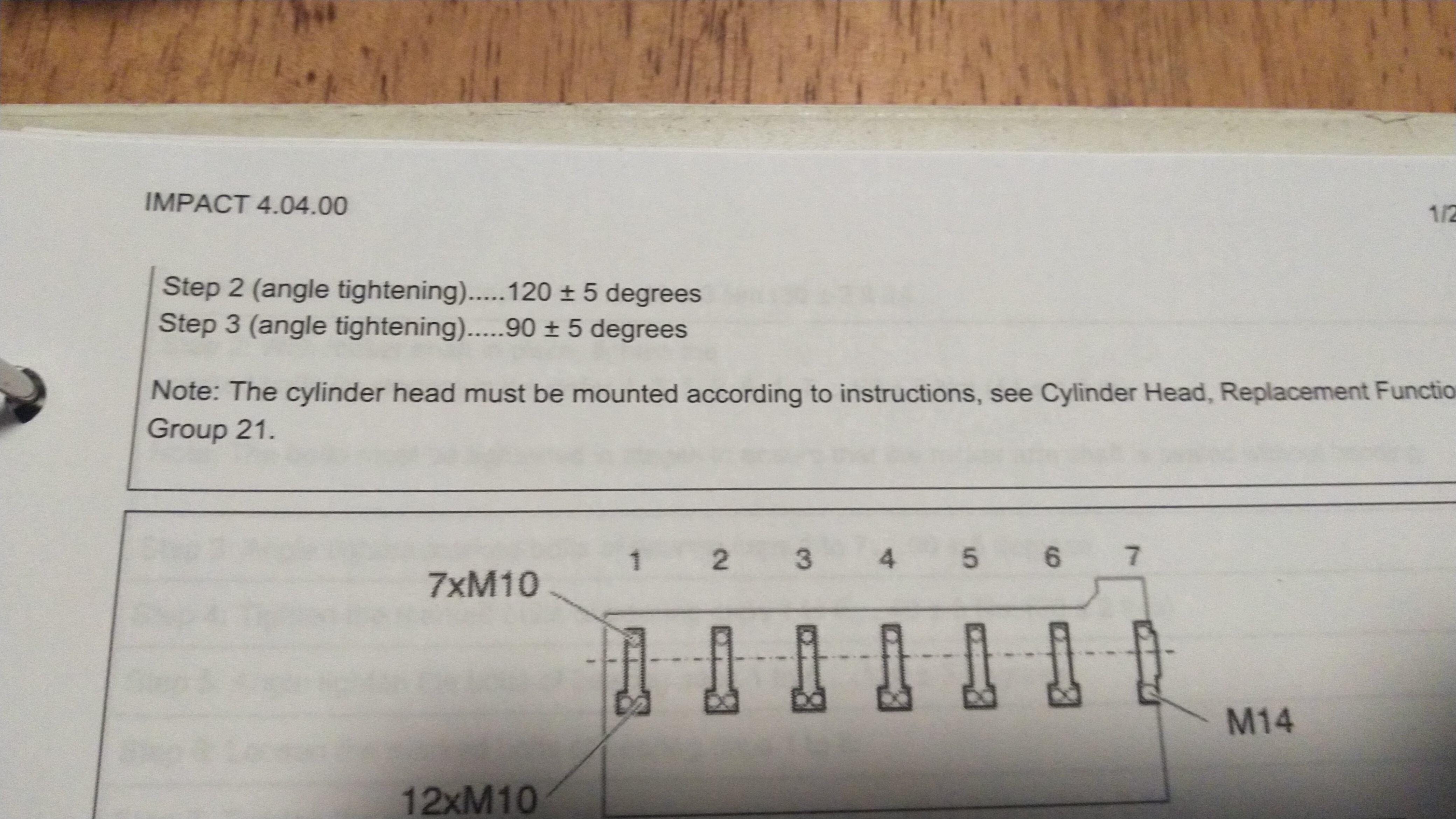

I found my book..  Here are a few important pages..  There are only 3 steps,  stick with the torque sequence on each step.. I can try to send more pics,,   jojo

Thanks Joey, I can see it. I figured the washers were to align the head, but I want to make sure I wasn't missing something. No fear with the gear train, I've done several mp7s, but they are dowel so this thru me off a little. First head I've ever seen on any engine I've rebuilt that didn't have dowels! And that's pretty much every engine under the hood of a truck for the last 25 years lol.
