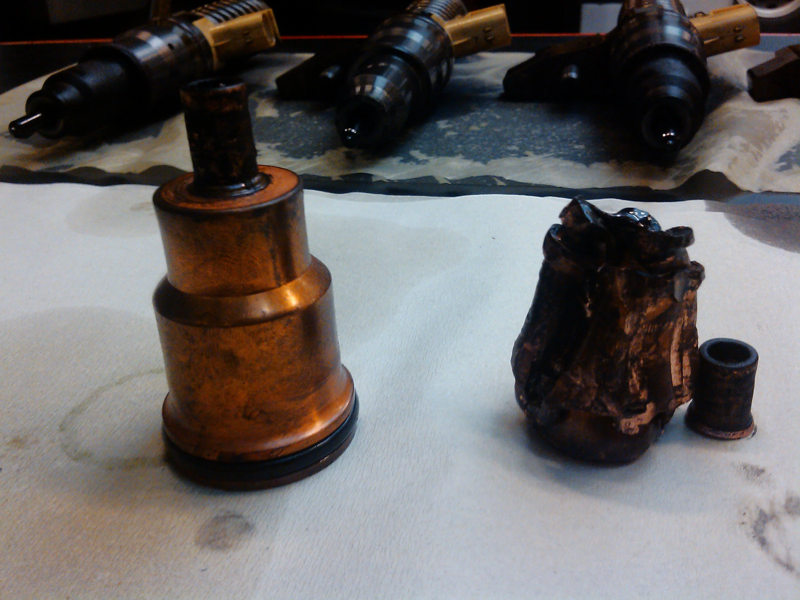

Here is the cup puller I used had issues with the Ferrum tool as well . The problem is with the Ferrum tool you cannot tighten it up much or it will lose its grip and fail . So best choice make threads nice and slow put grease while making threads so shavings stick to grease without failing on cylinder . I used that high pressure grease you are going to use to install cups . 0901F38A-53AC-42F0-89DB-C09483940FF3.thumb.jpeg.903c0295189b7e1e10579b80c4c5fe32.jpeg
