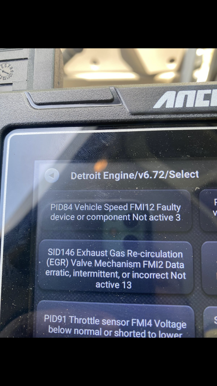

What year engine and engine size are we talking here. Get the information from the tags and stickers on the sides of valve cover. Also the make and year of the truck could help if you know for certain the engine is original to the truck. It literally says there is some type of EGR fault on your scanner so there is a good chance its not a 12.7? The information seems contradictory but I'm no DD guru.
  • 0
I was kinda thinking like you 67,,. Im no DD guru either, but I sure have worked on a lot of them from the 90's to 2007..  anyway, I will follow this one and hope to learn something..  🍻
