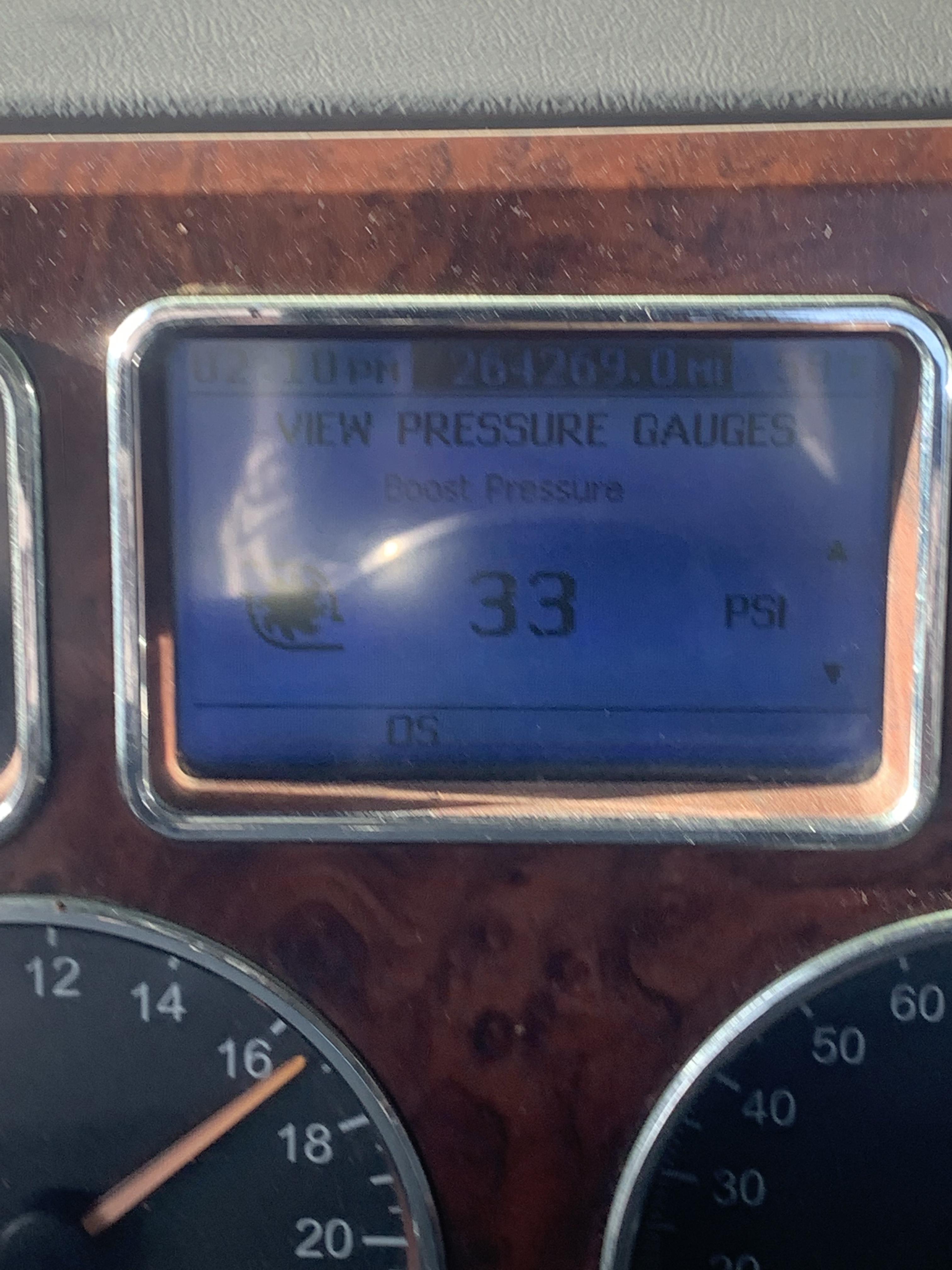

When this truck is right boost runs up to 39 to 40 and holds till it starts dropping in the toque curve at 1650 or so . If its hot out , above 85 degrees i see a lil softening of the upper boost to about 38 but almost always above 35 psi.
I'm with you on the grey hair and bald spot. nuthin better than talking to experience!
I got to test drive the truck I been working on for a couple of days before I went home today. 2012 CXU  445 Econodyne. 10 speed Fuller. New turbo , new EGR differential sensor upgrade kit installed, new EGR temp sensor, no boost leaks, clean DPF with only 1% soot . Pulling a empty but heavy feed trailer . On the interstate coming up the biggest long hill we have around here. I accelerate up the hill and took this pic at  1650 rpms at 72 mph  and max boost I got was 33 psi , I hit 75 at the top of the hill. I’m wondering if emission years and HP differences make a big difference in actual max Boost pressure. My buddy who had the 2016 505 Plus program can’t remember his boost numbers in a hard pull. I road with him once to the grainery and we we’re pulling same hill loaded  easier that I pulled it with my empty trailer. Gross weight was 101,000 when we weighed at the grain bins. Best pulling Mack I ever road in.
Good possibility the boost sensor could change the Game! We accidently installed a MP 8 boost sensor in an MP10 once ! That truck turned from mild mannered Clark Kent to Super man in an instant ! It was a low bed tractor that you could pull stumps with! Truck was still under warranty so we didn't leave it  like that but it was and Eye opener!
