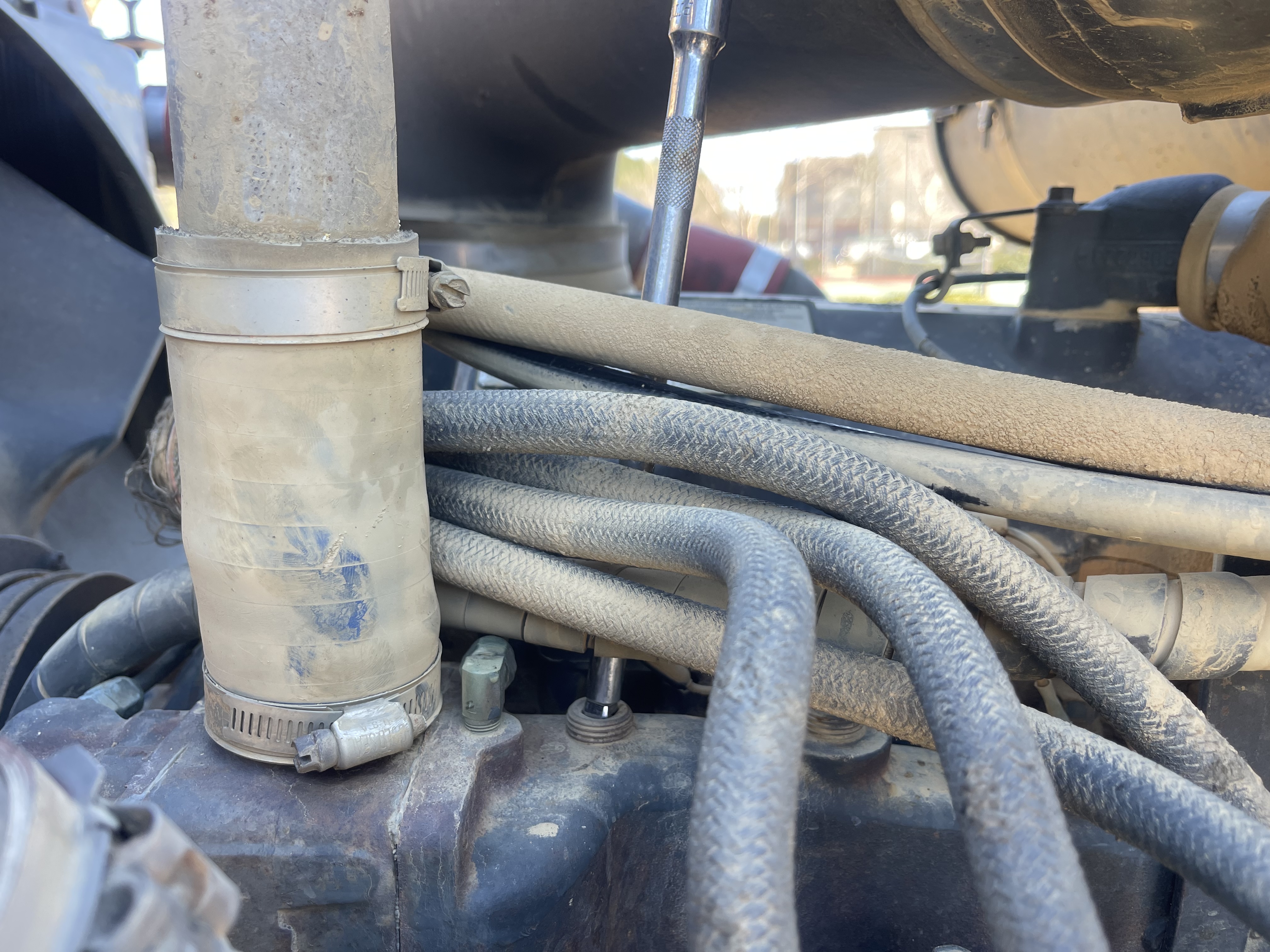

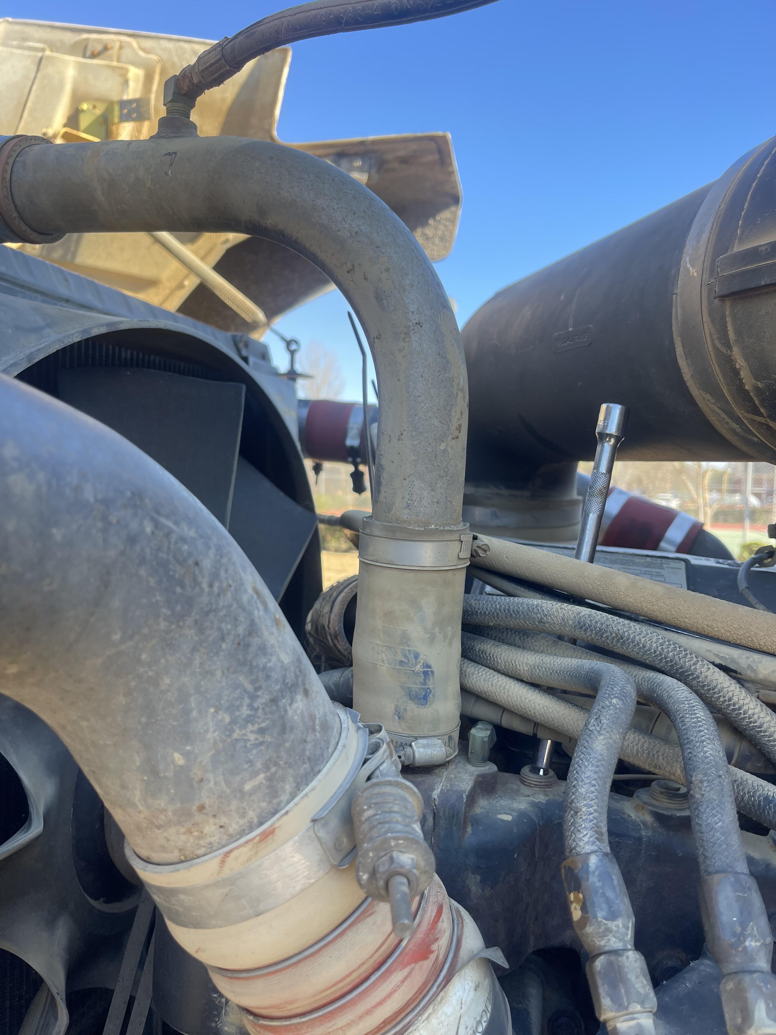

Is this the correct plug (see pictures) just want to be sure? Also crack it open with the engine off to burp like normal? Would you drain everything back out then do this process over or is it okay to see will it work with coolant in the system?

@Joey Mack he think it worked for me I drained the system started to pour coolant back in the reservoir until it was full cracked open the plug I did hear our waited until coolant started coming out tighten it back down filled the reservoir all the way back up turn truck on got the temp up drove it up the road temp gauge did go past 180 like it was doing so should be good now. I did end up pulling the plug all the way out the first time although you said leave it in just a bit. Thanks for all the help.
