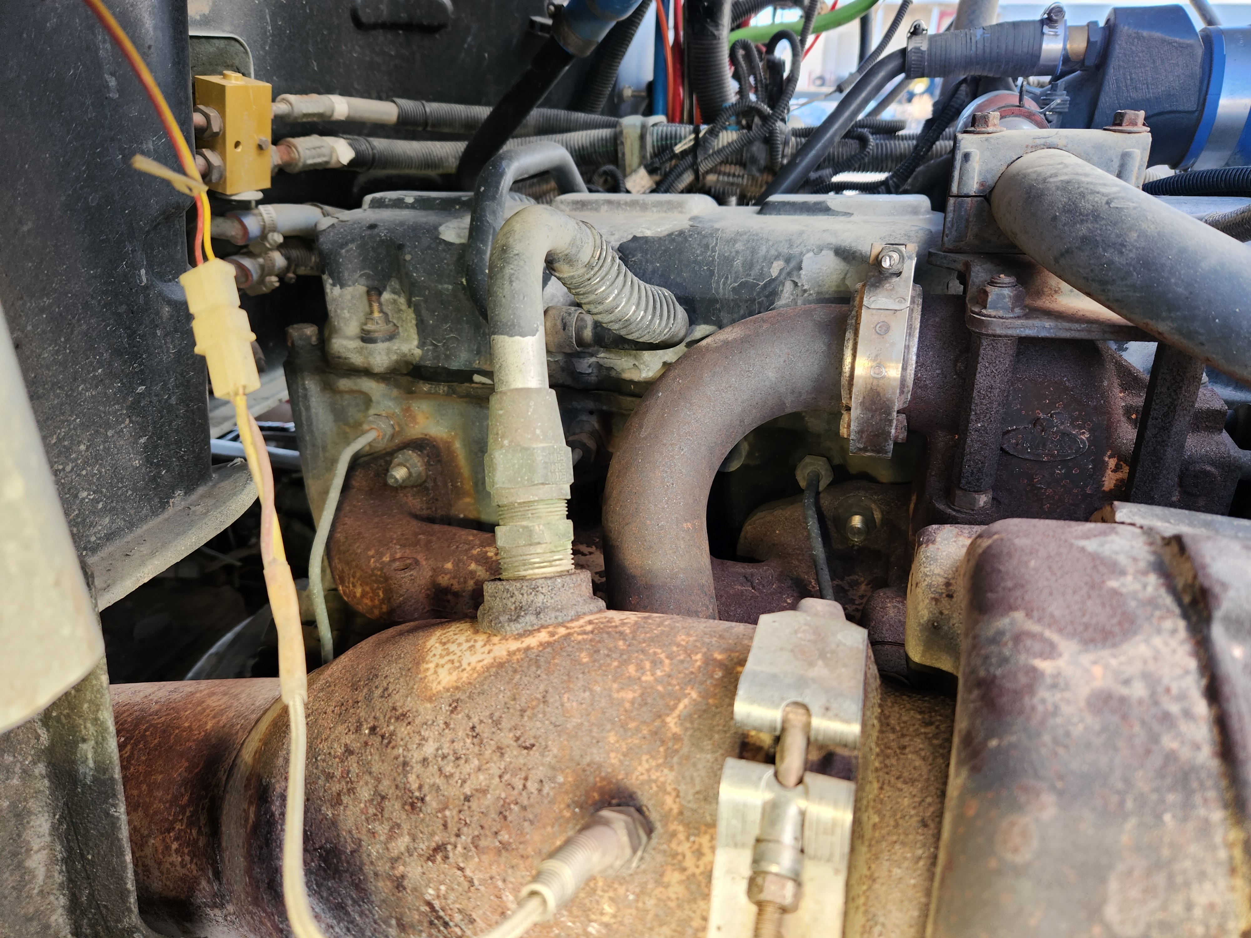

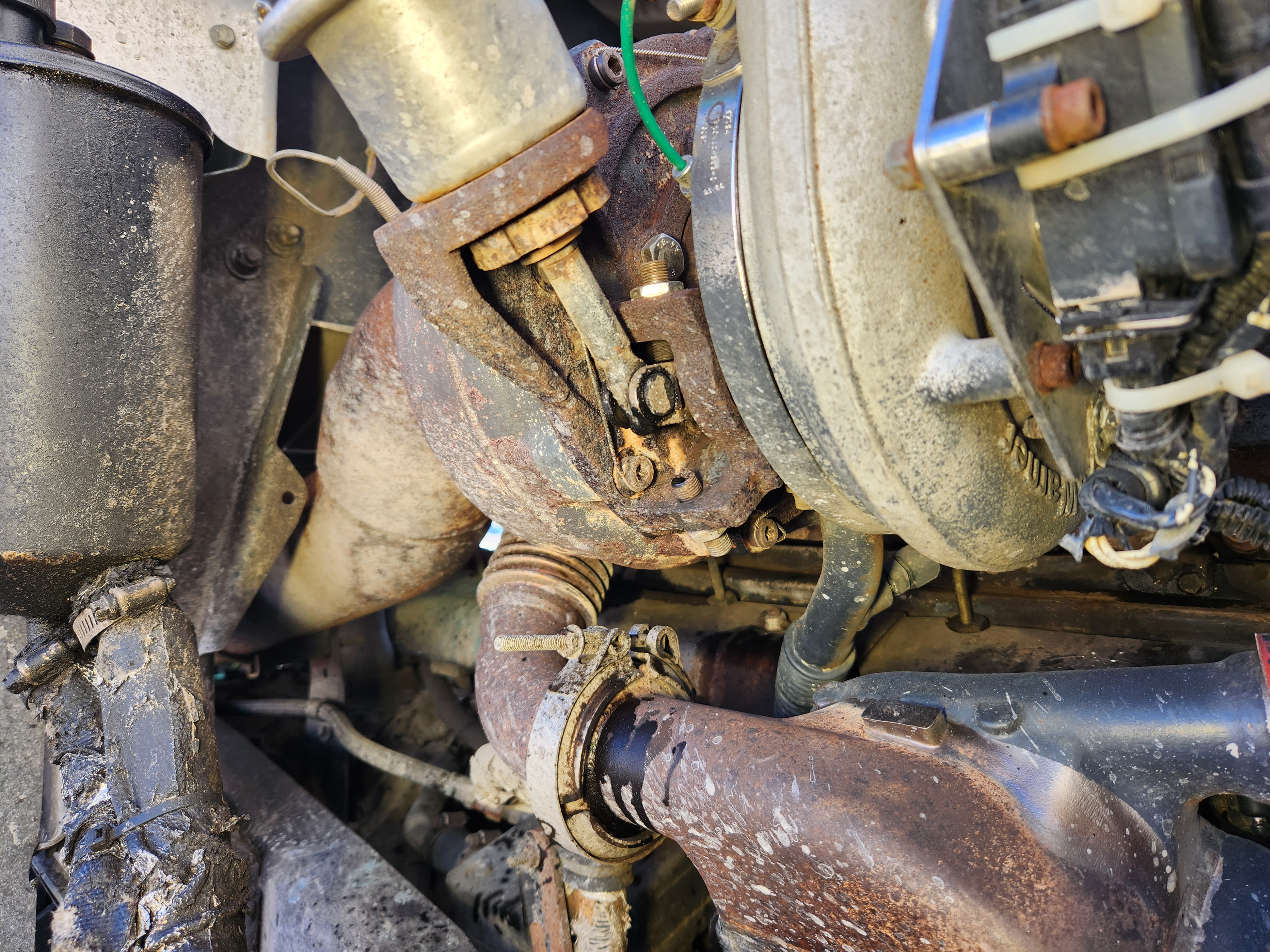

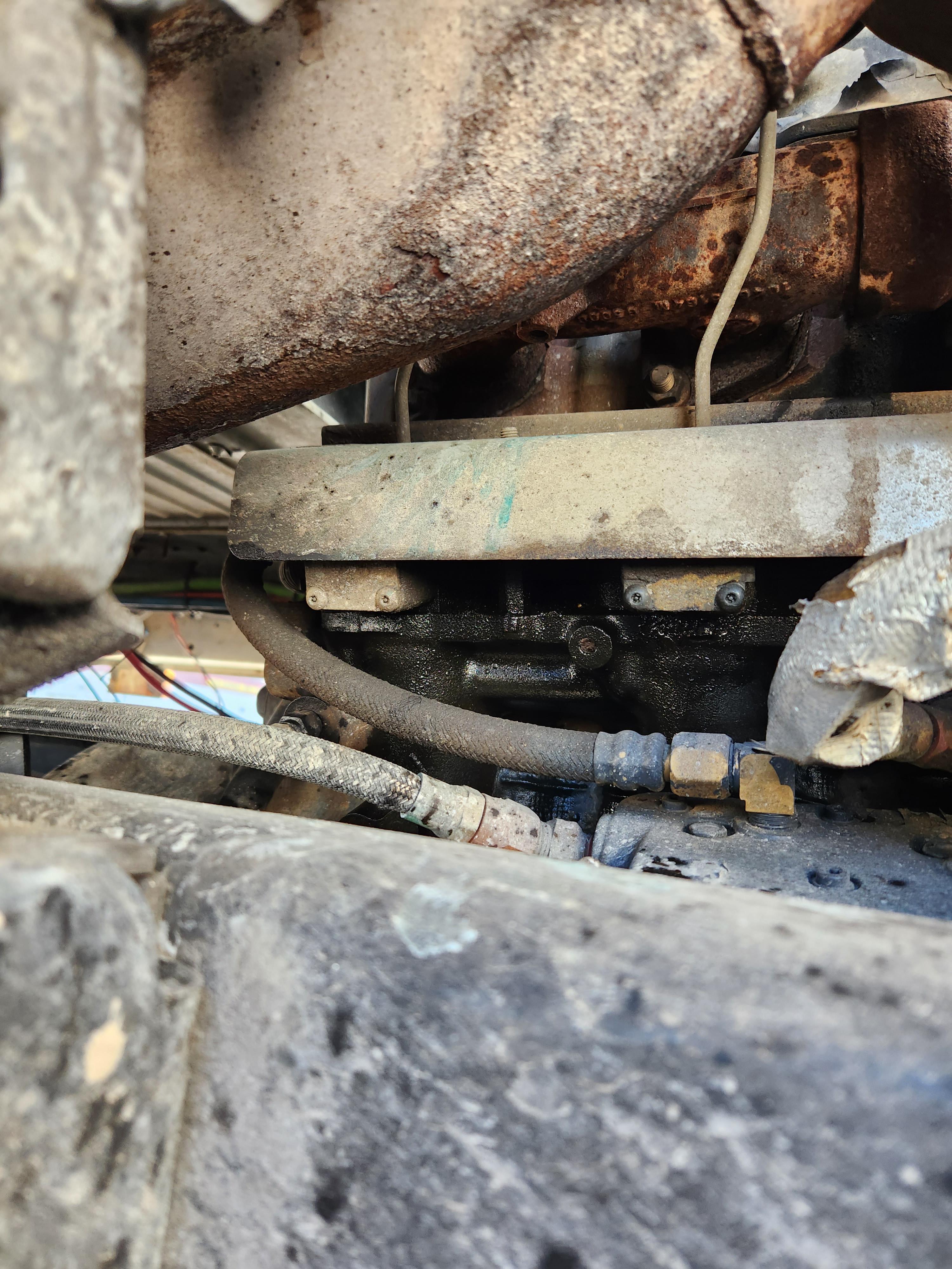

Quick update and a few pictures..
The cylinder head is dry below the valve cover, and all wet with oil below the exhaust manifold. And all of this appears to only be on the rear bank.
There is oil in the exhaust and I am wondering if that oil coming from the turbo is just a result of the oil going through the entire exhaust system, presumably from the combustion chamber. Just speculation at this point from what I am seeing. Rough running, over pressurizing of the cooling system, oil in the exhaust.

Want to pull the pipe between the cooler and the intake and check like FJH recommended, Thinking about pulling the turbo off and confirming that the inside of the exhaust manifold is oil soaked as well. If it were the turbo leaking the oil, the manifold should be dry, no?

The oil is on the outside, wouldn't that mean it isnt coming from in the exhaust ? Unless the exhaust had a bad leak, but if it did the soot from the exhaust would be evident, and I can't see any
Reckon the motor has a oil leak some were and thats were the oil is dripping or getting blown to

Looks like she pushing oil into the cylinders..  Not good..  Pull the exh. manifold off, and I bet you have some wet ports..
It shouldnt be a head gasket, because of the fire rings. If a fire ring was left out it would have blown out the gasket on that cylinder. It can be, worn valve guides, bad piston ring(s), a cracked head, possibly..  I just looked at the pics again..I dont mean any disrepect, but it looks awfully dirty and rusty to have the heads off of it, and if the manifolds were left on the heads and pulled as a whole unit. I would expect the mechanic to break it down on the bench to clean and re-gasket it..  The ASET-C is not an engne to cut time and corners on...I am also concerned about proper valve adjustment..  That is also VERY specific...  Sorry sir.. With respect, Jojo

Bro the oil/ coolant will be coming from the exhaust or the turbo!  the other check is the turbo its self remove the inlet elbow and look inside! In my mind we can't ignore the coolant push totally! EGR cooler! We asume it is oil we see How ever is it?
