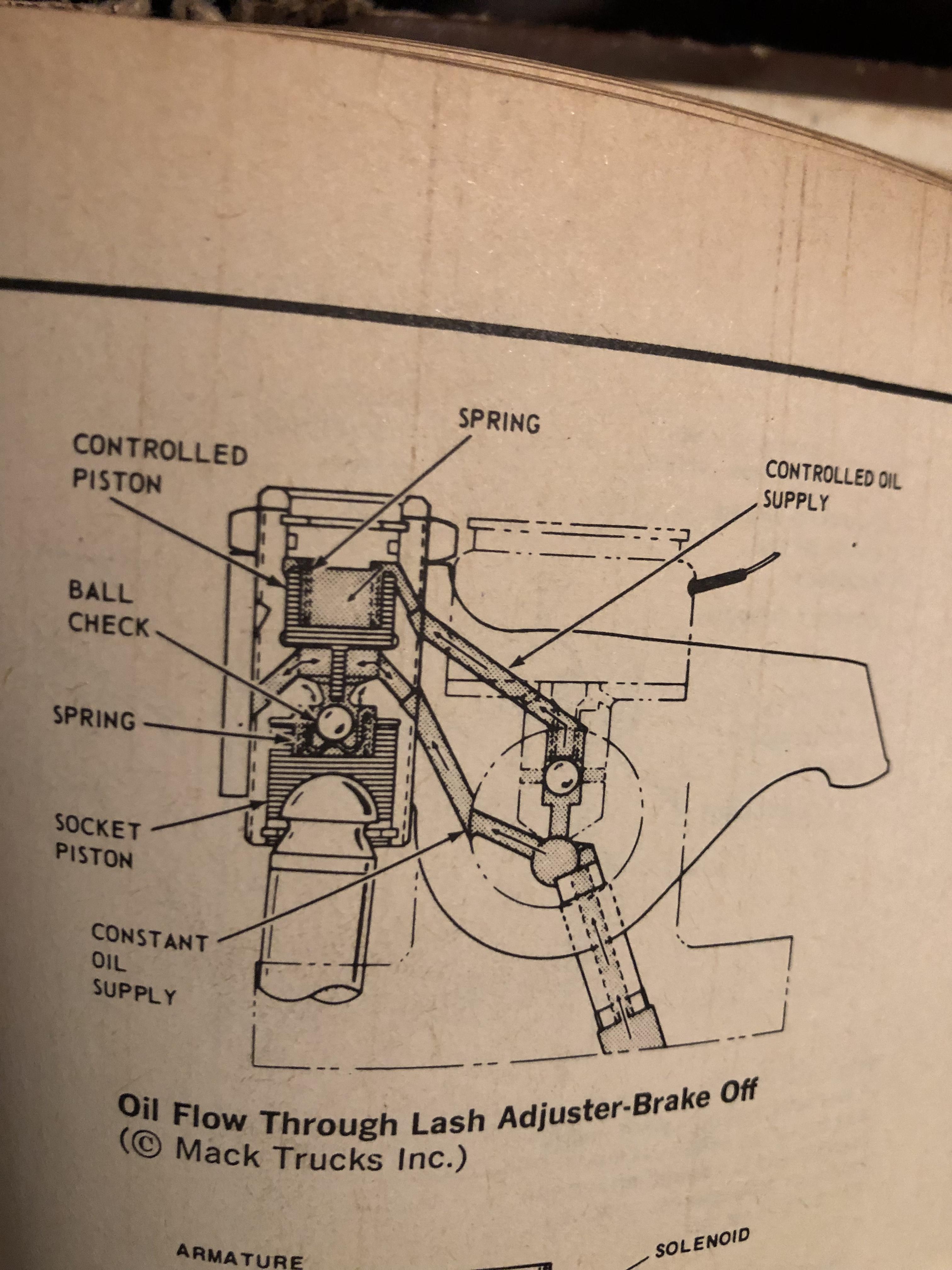

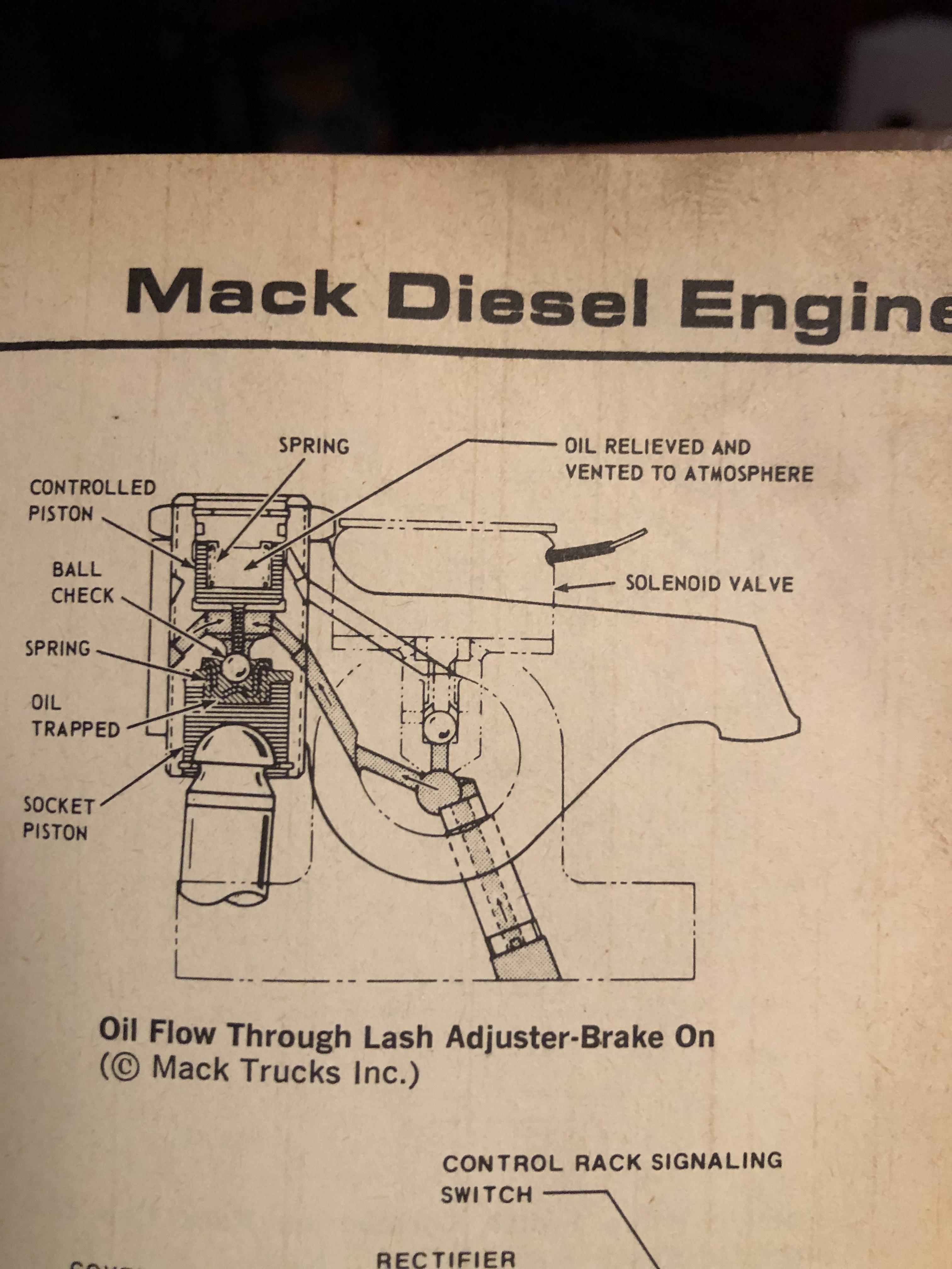

This is where the magic happens the rocker arm adjusters have 2 oil reservoirs and pistons that apply the retarding action by opening the valve on the longer profile at the rocker arm not the cam lobe when the small parts inside the rocker arm adjuster get worn that is where the problem starts with dynatard

So by looking at those two pictures above
It looks like none of the small bits have O rings to seal them up, is this correct ?
If so I  gather this means once they are worn they go in the rubbish bin
Or is there rebuild kits and how would someone check these are or are not working as they should
I think I might have to get my workshop manual out for these, I  have looked before many years ago but I seam to recall it was pretty vague, mind the way my head has been of late it could be I just dont remember

Well I ordered and paid for book about these today from fleabay
Hopefully I will have some added information to lead me to a positive understanding of these

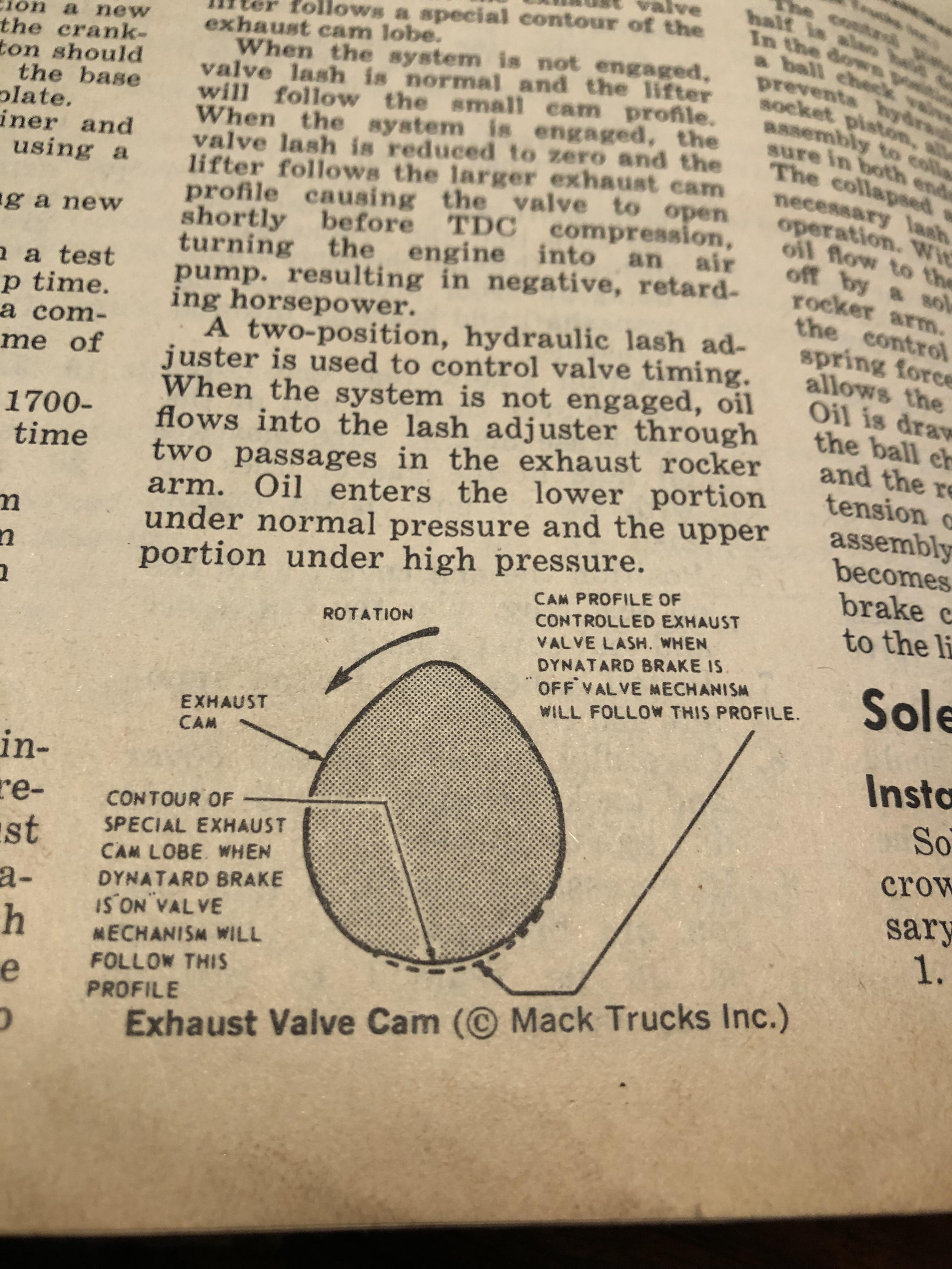

Hello,  I bought this service manual on ebay , and according to this it looks like all engines have the dynatard cam in the E6's, just giving an update,  thanks to everyone for posting and helping.IMG_20230225_115948.thumb.jpg.189b73c8bbf46a89e49646c7b4dfd8d7.jpg
