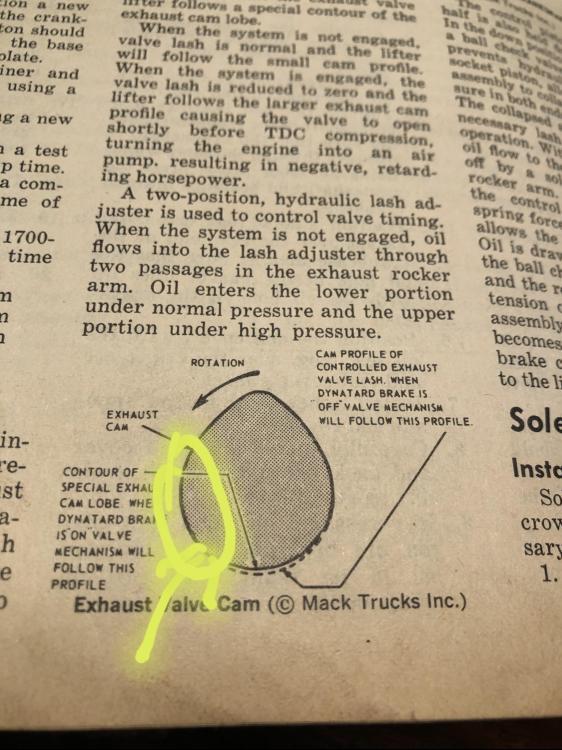

2 hours ago, Geoff Weeks said:
Mack solved that by the Dynatard system, where the cam profile for the exhaust is customized with a "two lump" profile, the normal exhaust and a 2nd small one that could open the exhaust a bit at TDC compression with the hyd lash cyl at the rocker.
There is no second hump on a dynatard cam
They look almost the same as a non dynatard cam
When dynatard is off the exhaust doesn't follow the cam because it can't
The exhaust valve is shut and as such it can't travel any further
When dynatard is on, the effective push rod length has increased and as such the valve must follow the cam and the exhaust opens just before TDC
If we think about the dynatard and all the bits that need to work and be reasonably oil tight and in good working order it is little wonder that there are lots of issues with them as they age
Reducing the valve clearance would help as the effective travel needed is reduced to achieve a good result
Having said all of the above I feel timing is also critical, as is good mechanical clearances on the rockers gear
The little piston in the lash adjuster can't extend fully if it can't be supplied with oil under pressure
There's a lot to getting dynatard working fully, more than most of us understand
Paul

the 2nd "lump is at the side in your picture and only comes into play when the lash in the system is reduced.   It is still the same operating principle where the exh is opened on compression near TDC.
the lash adjust is similar to Cummins STC injector. The effective length of the push rod is changed and that changes the timing and/or travel of the rod.

Just now, mrsmackpaul said:
That's hardly what I call a lump, but for the sake of keeping the peace you can call it a lump 😆
Paul
Don't want you coming over and giving me a lump upside the head!
