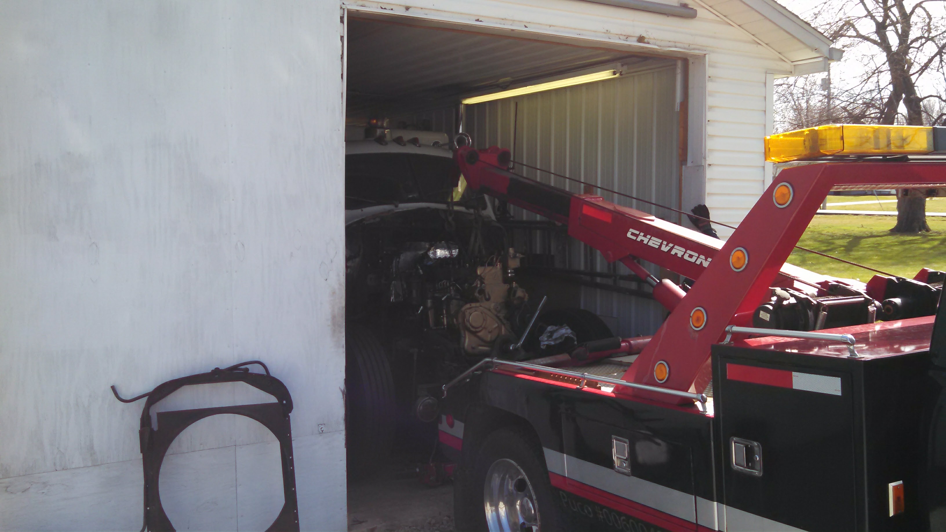

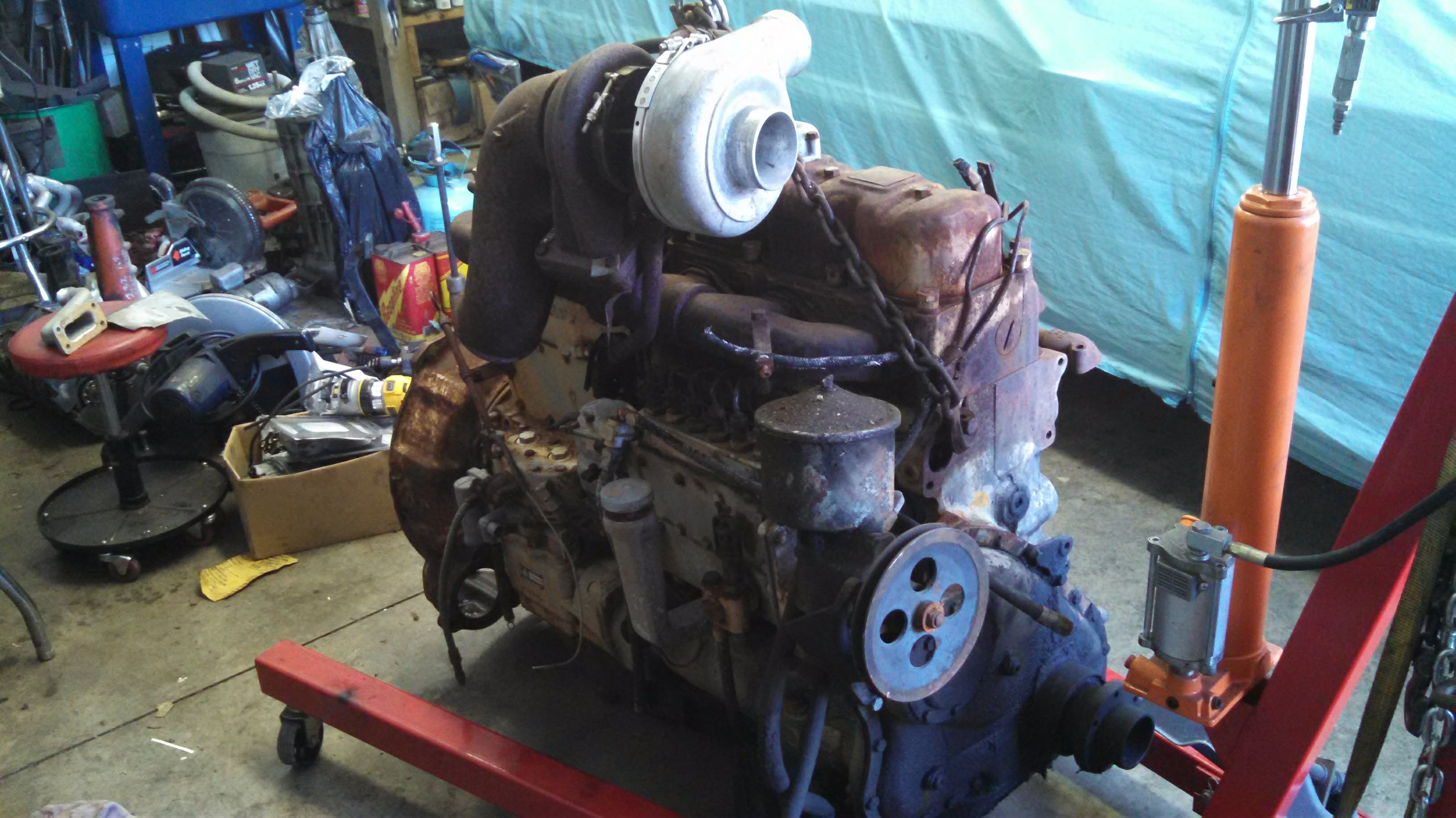

I know my folding engine crane would just pick it up with the boom all the way in.  I unloaded my 237 from a small trailer with it.
Larry

Engine didn't have a flywheel on it, so that saved it from being even heavier.   The crane wasn't happy about it, but did lift it.
100# here, 100# there adds up quickly.
Larry
