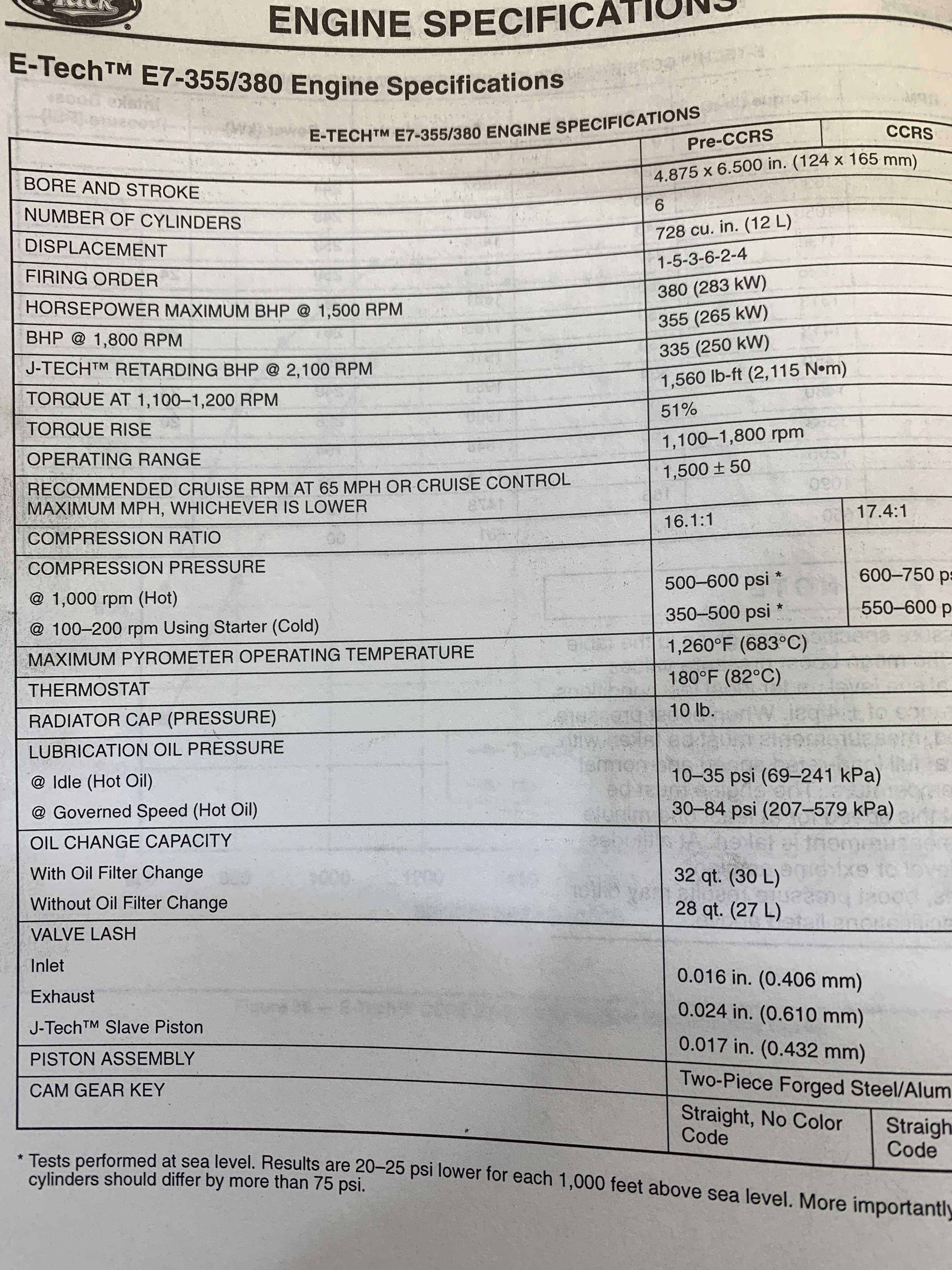

With your truck being a 2000 it's most likely a pre ccrs engine and would require cam key change to go to the 427 file. If it was me I would just do turbo and injectors and leave the 355/380 program in it they have the same amount of torque 1550lbs. I myself like the 355/380 better over the 427
What the model and last 6 of the VIn? I can look the actual specs up of your truck/engine. The 355/380 has the same torque as a 427. On some year models of the 355/380 just adding the 427/460 injectors ( possibly turbo as well) will boost the Hp over 500. The 355/380 usually have smaller injectors but the software/data file manipulates the  EUP’s for a larger fuel charge to get the 427 like torque readings. Bumping up to the larger 427/460 injectors really improve things. I have to find my notes on this when I get to work.

Yes . The 99-2001 Etech ( not 2002 CCRS) 355/380 has 1560 foot pounds of torque like the 427 of the same year. The 427 and 460 and 460XT use the same turbo and 850cc injectors and have the offset cam keyway, the only difference between the 427 and 460 and 460XT  is the software. The 350,400 and 355/380 all use the same smaller 700cc injectors and smaller turbo and all have the straight cam key way. So in theory putting the bigger injectors and turbo there should be a big increase in power. My notes I found when I got to work were for the 2004-2007 ASET AC 355/380 . 50 pounds of boost and over 500 HP on the Dyno  by upgrading to the bigger injectors and turbo . The CCRS and ASET engines are different in HP levels/ parts combos. The cam keyway on the ETECH 1999-2001 would concern me. I did a 400 to 460 update on a RD without doing the cam key way. It was fine till summertime then it ran hot . The keyway retards the timing on the 427/460. The straight keyway is for most 300 to 400 including 355/380. Flip the keyway the other way and it advances it for the 275 and some 300 engines. The CCRS and ASET engines all use the straight keyway regardless of HP

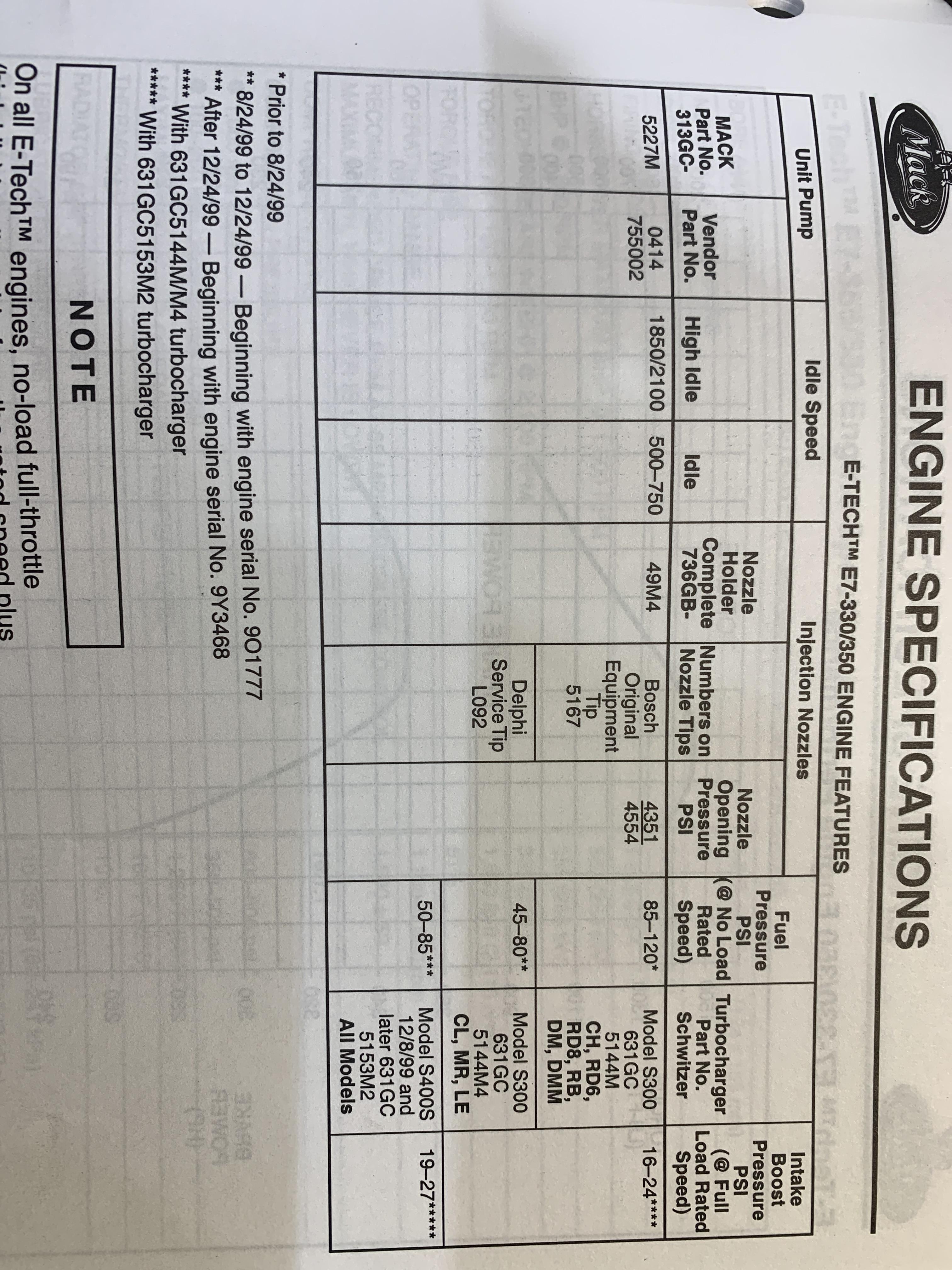

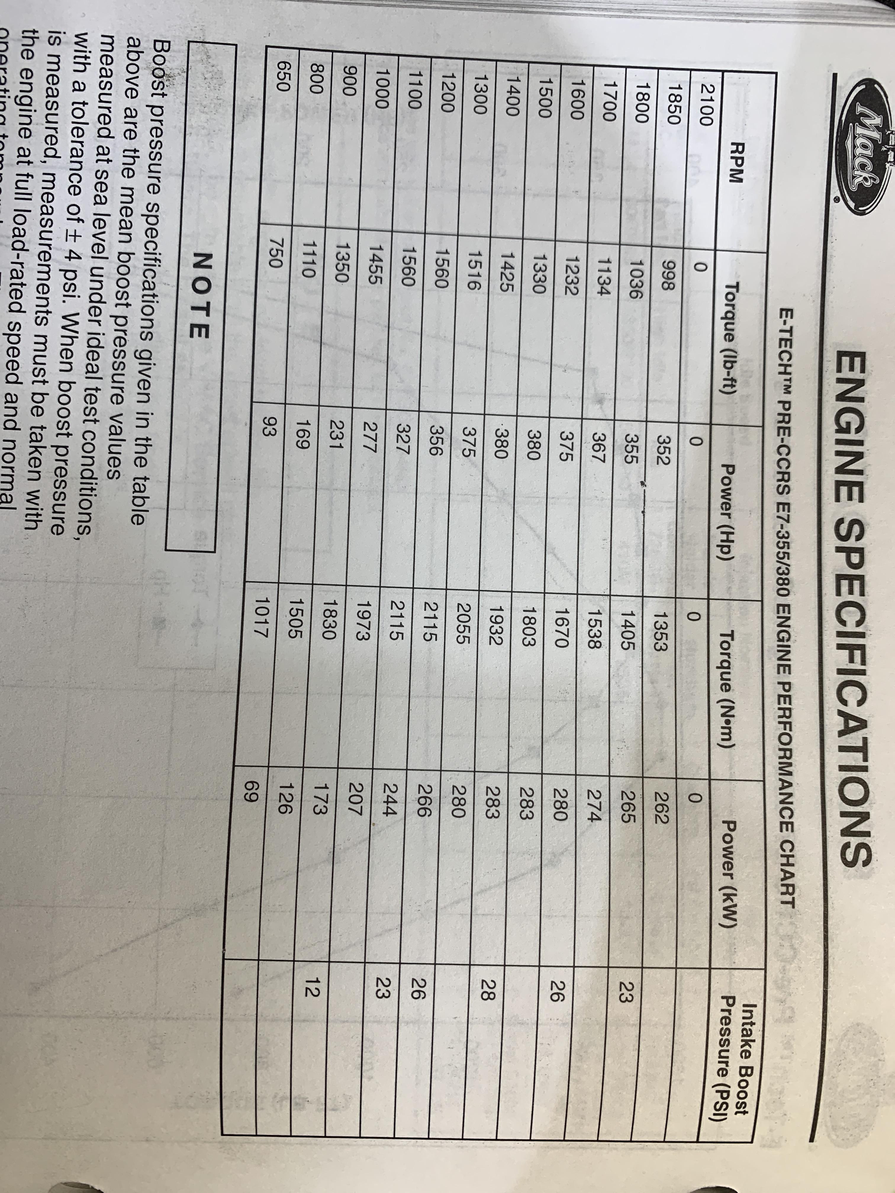

Put a gauge on the intake.  Under load it’s right in that 20psi are.  See get little better at the right load an rpm.   Part of what makes it a little slow is the ratio it’s like 1275 rpm at 55mph.  I know that’s probably close to peak torque though for these engines??
I looked at this this morning I have the 400s turbo so 19-27.  I’m going to say we are in that range.  Couldn’t find a low pressure oil filled gauge and it wouldn’t stay very steady to read.   That data shows 1200 degrees on pyro as a high this thing is doing good to get them to 900.  Which I would think would be higher if we didn’t get enough air to it.
