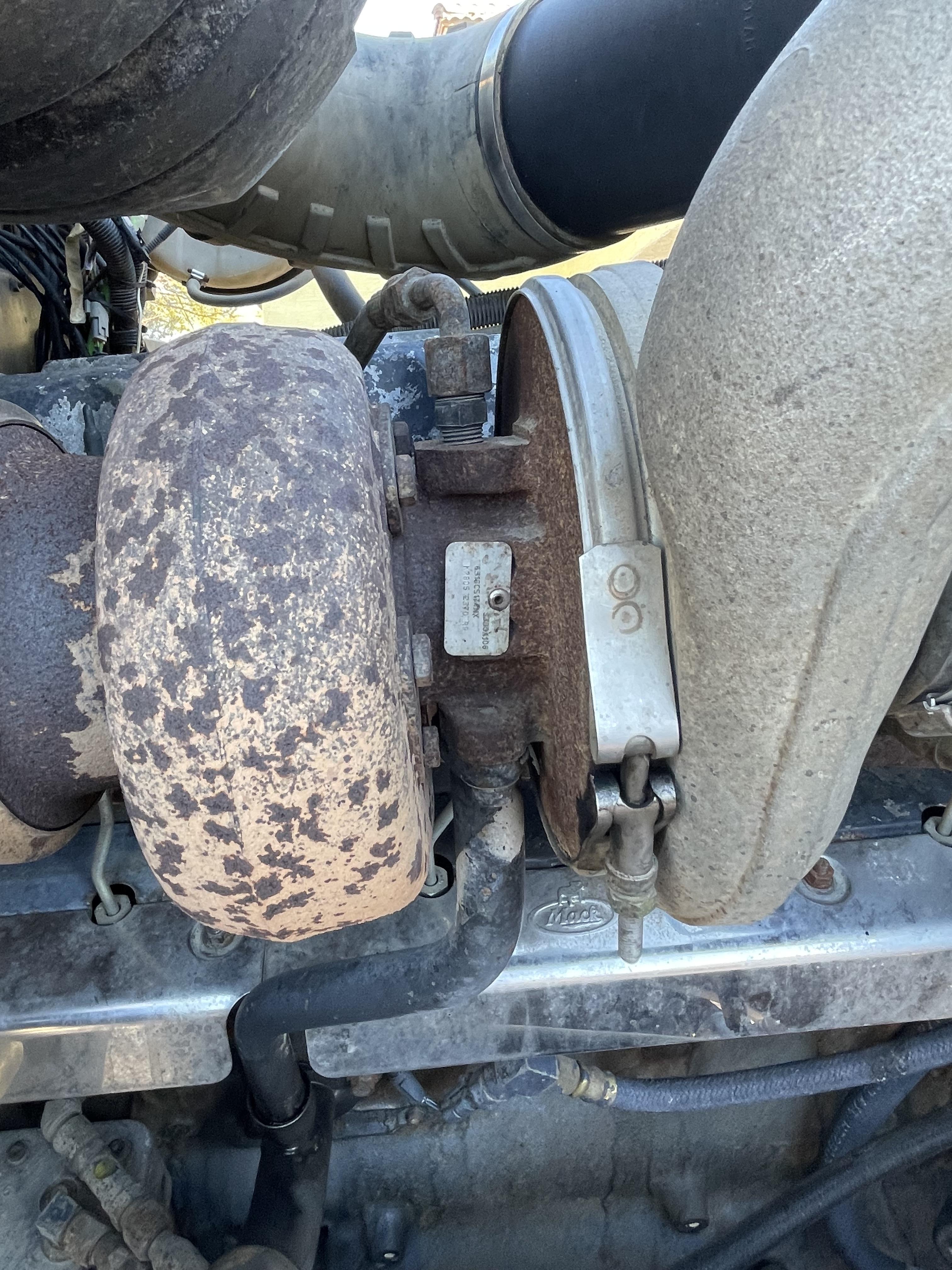

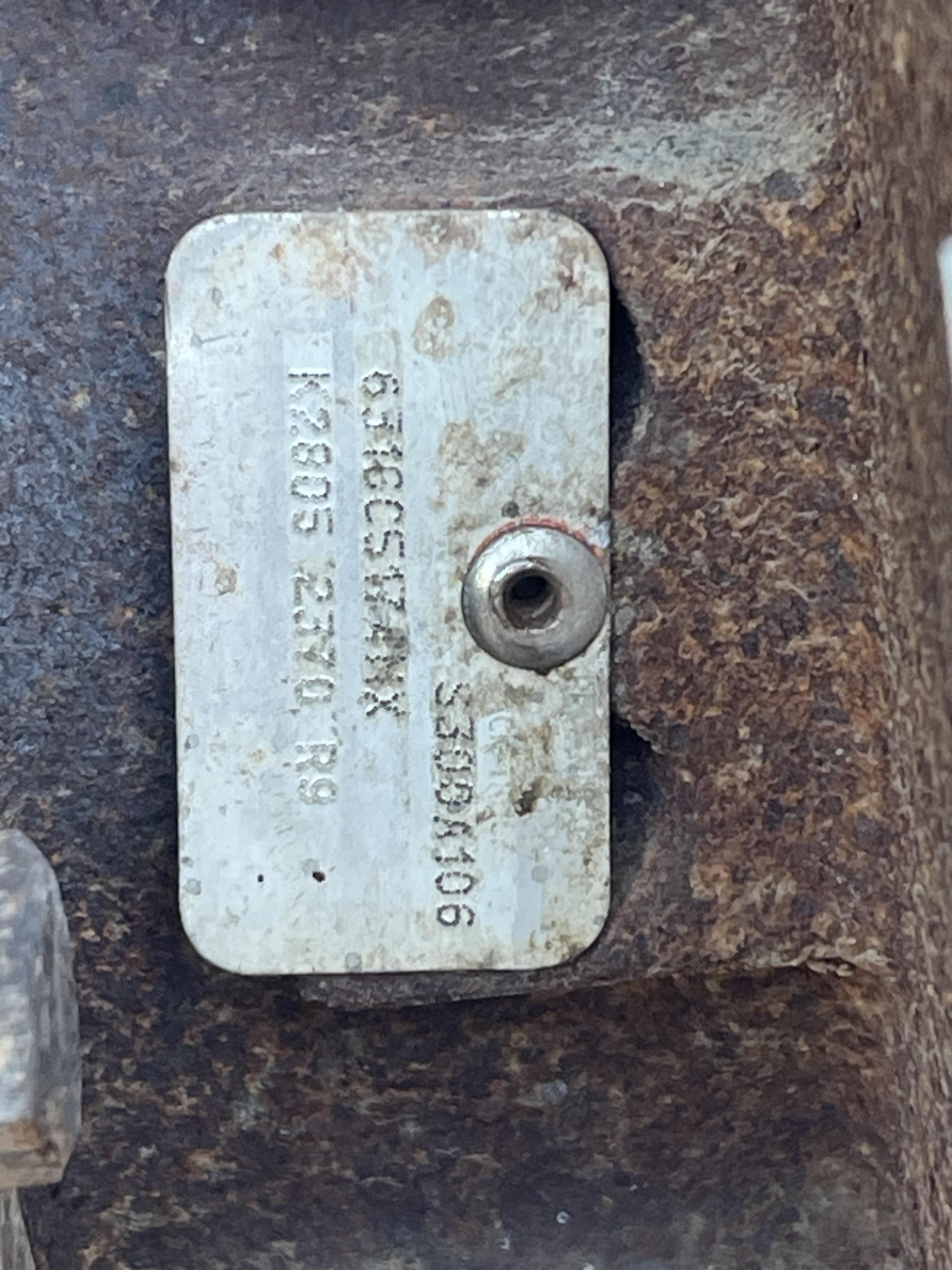

The boys at my Mack dealer here in Phoenix want me to switch the turbo to a #631GC5153M4 but Mack Corp will not get back to them with the horse power increase file. I know I am playing with old toys but still.

My plan as of today is to increase the horsepower file to a 380/410 with a slightly larger injector, maybe something in between the 700cc it has now and the 850cc of the E7 460 if possible. I am not even sure if a 380/ 410 file is available for this year of truck at the moment because Mack Corporate has not gotten back on this as of yet. I am relying heavily on the information that I am getting on this forum in my decisions and I appreciate your assistance. I am also toying with the idea of installing the Power Leash engine brake but I am being told that it will not work on this engine, not sure or understand why though.
If there was a way to check the camshaft part number in yours against an ASET-I engine, that would be some useful info, also is yours a CCRS engine, if it early E-Tech the cam key may be wrong.ibwish i knew more on this
