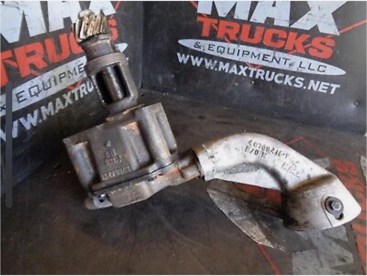

On 2/24/2023 at 11:02 AM, br549 said:
Pickup tube is same on the small and big oil pan,  the 51 qt is just deeper.
Adding to my response/quote here I’m attaching a photo of complete oil pump, pickup tube and strainer. It looks like your info was dead on. Was asking questions before I dropped pan just to know what I might need beforehand  and not go through process twice. Short thick pickup and unique strainer
