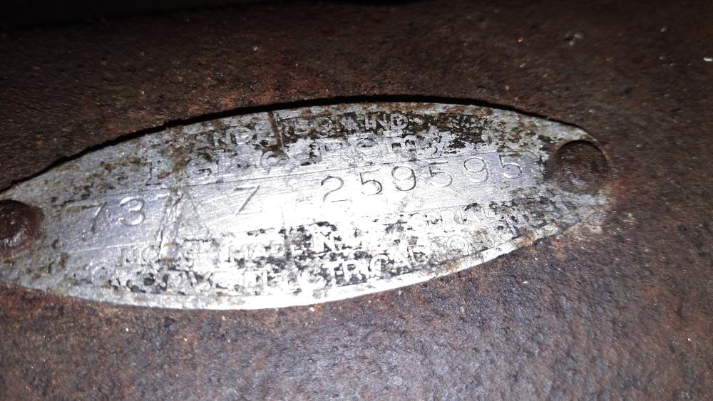

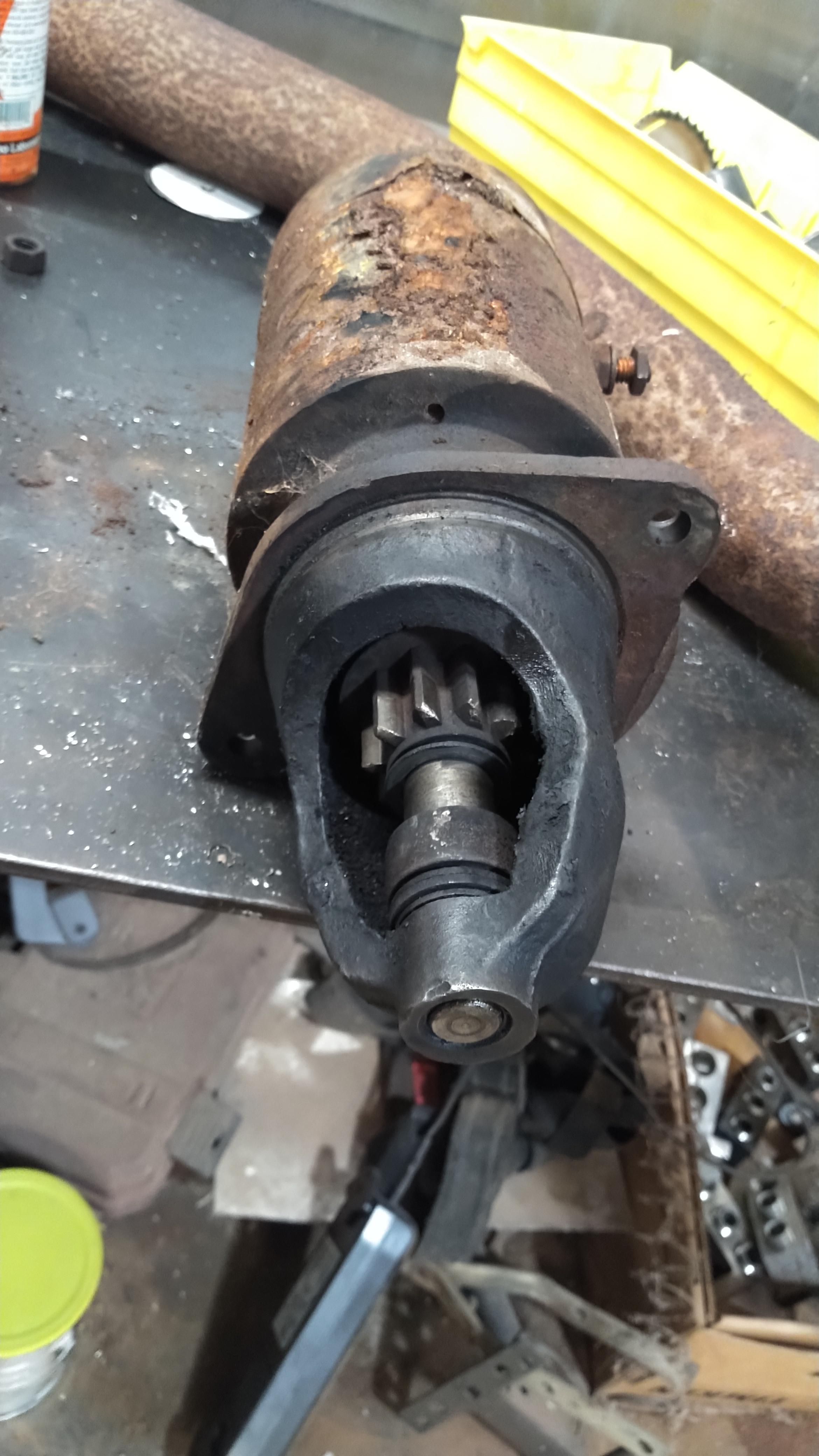

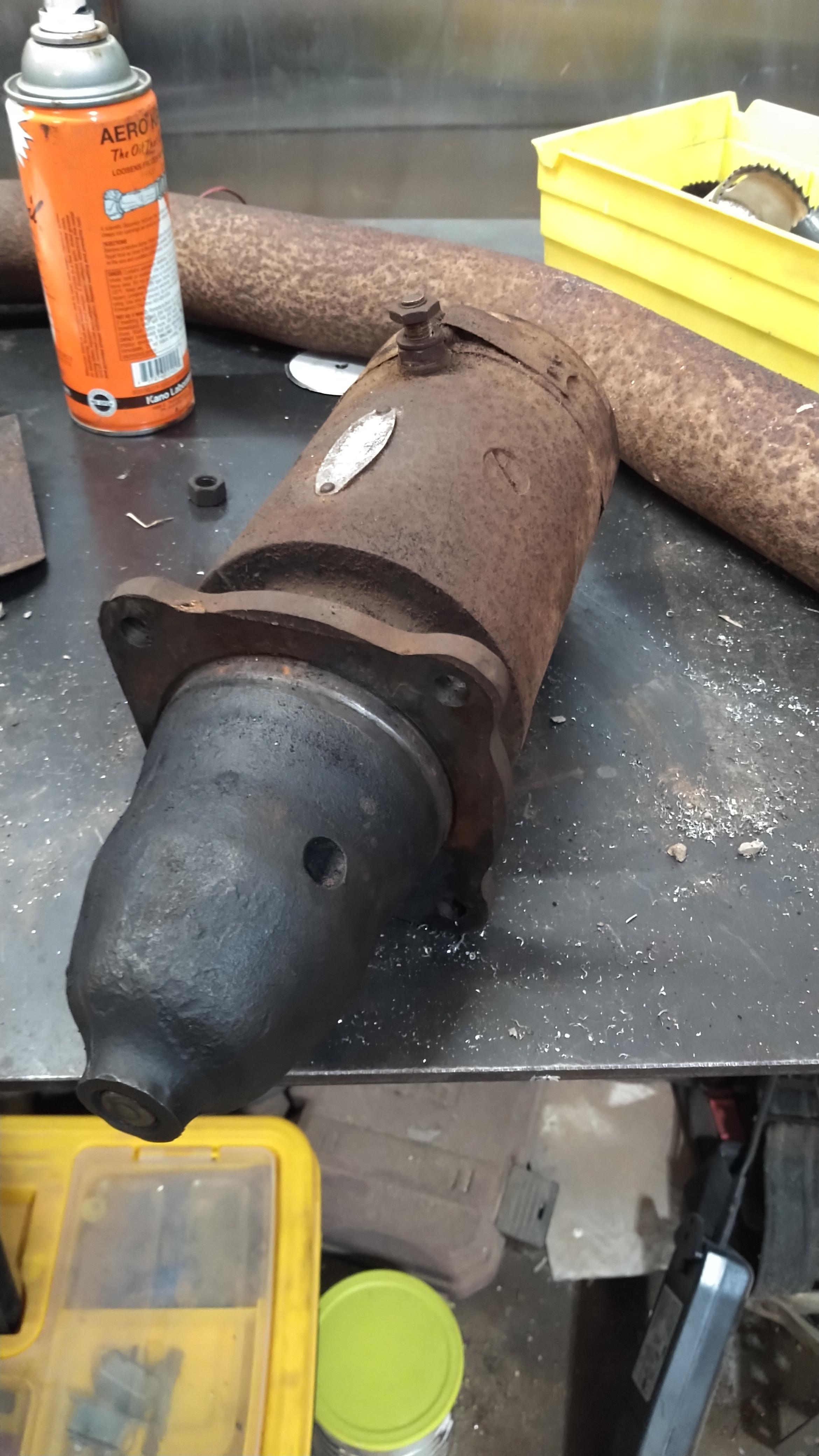

Hi guy's...  I need a starter for my '48 Int. KB-7.  It is a 6 volt, positive ground truck, but I am changing it to 12 volt neg. ground..  The current starter is a Delco 737 Z / 259595..   I have been on-line for over 2 hours, with no luck..  Does anyone know of a company that can cross reference this starter, and possibly know if there is a 12 volt version.
 Part 2..   When I got this truck I used a 12 volt battery, not knowing it was 6 volt.  it actually started just fine.  Is it possible, that a 6 volt starter is capable of handeling 12 volts, just like some truck starters that are 12/24 volt? I dont beleive the 12 volts is what causes my starter to click, I think it is because it is really rusty and has some rot.  Pics are on the way..Jojo

I am converting to 12 volt neg. ground.  I already have some of it done.  The starter is in rough shape, take another look at the pictures.  I had to switch gears..   My Toyota, threw an exh. code and I found a leaking cat. joint and manifold.  I just removed the exhuast from the manifold to the muffler..  My manifold is cracked in several places.  So the KB-7 money is making a U-Turn..  :( I will keep in touch if I get good news on the KB-7 starter. Thanks guys..   jojo
