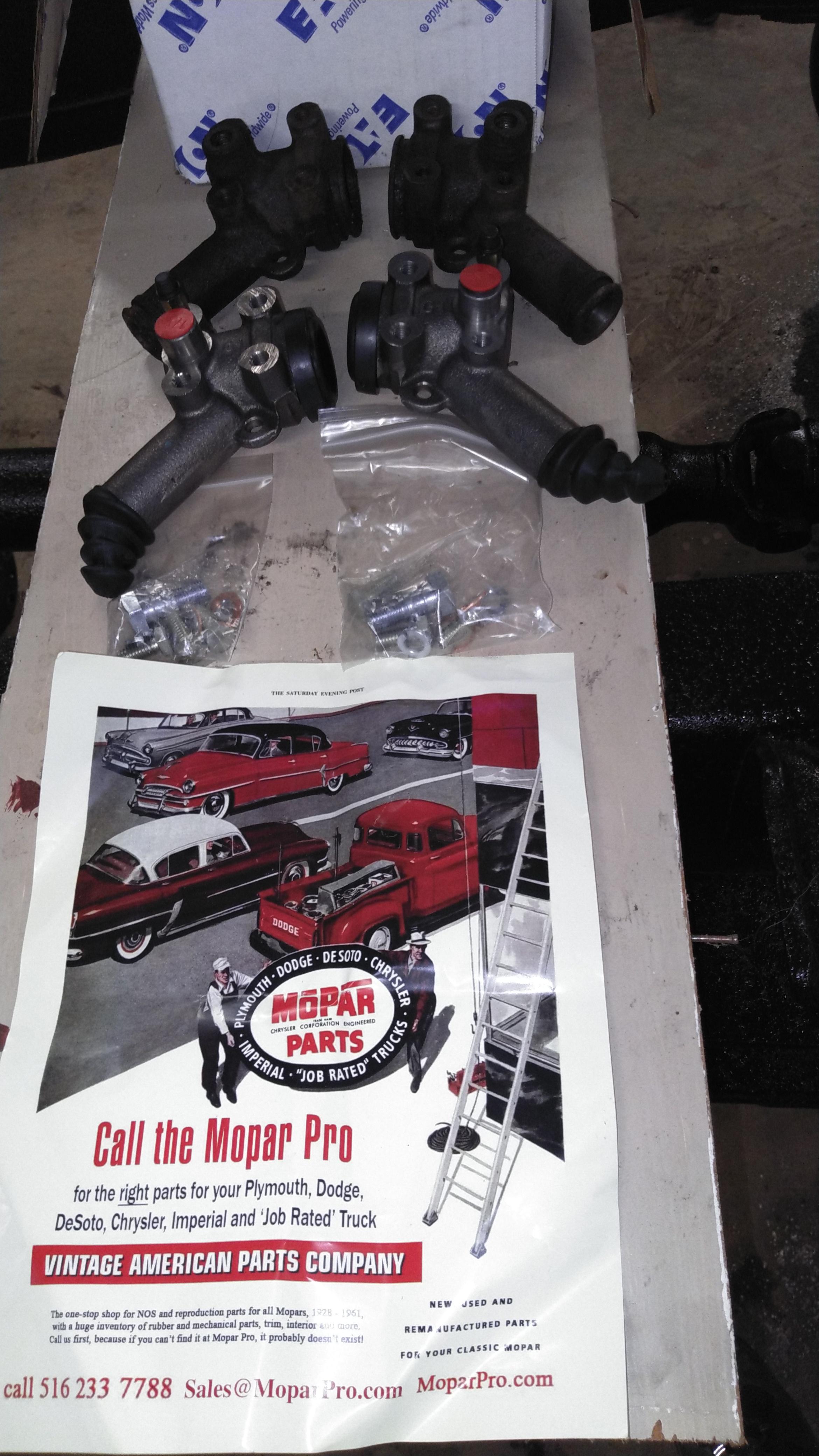

I aint goin' nowhere...  :)  I would miss you guy's...   :)  air start isnt in the budget.  this truck does not have an air compressor.  Hyd. brakes, which I just fixed with new lines and wheel cylinders and shoes. It will be fine..  I just have to take care of the trucks that cart my wife and I around first..  thanks bud... jojo
Where did you find the wheel cylinders?. My '44 KB needs them and I was told that no cylinders or kits are available so I was just planing on modifying mine to accept the cups etc from a newer available cylinder (if I ever get around to it).

LTK..  I can't post the picture of the place where I got the wheel cylinders right now, but I did post them on a thread I started about the wheel cylinders for my '48.. can you search it out?
Ok....  I figured out how to do this with my phone.. LTK... This one's for you..  this is where I got the wheelcyls.  Jojo
There is common practice of sleeving brake cylinders and making them to closest size of avalible seals. A friend of mine used to make brass liners. My guess was they wouldn't work really long because of wear but he stated that's fine for hobby use. And no chances they rot.
Probably you knew that and too possibly you know it better than me :)
