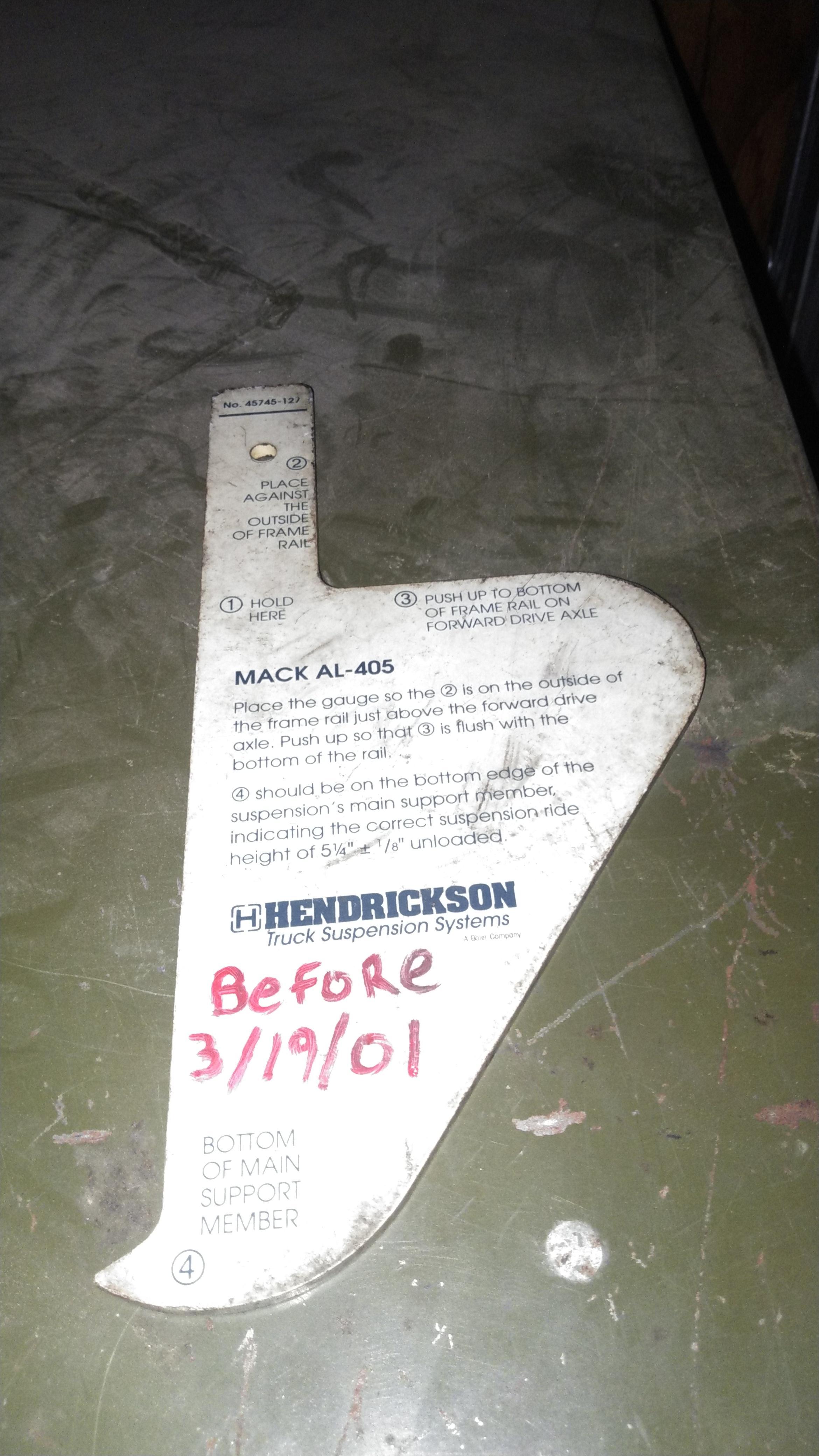

I wonder if the ride height is too high and causing the rear axle to have a light load on it.  He did say "Bobtailing".

You can use a tool like this one.  you need to know the brand of suspesion, Mack dealer should be able to tell you, buy just for the heck of it you can use thie measurement on this tool. you can use a tape measure to get close.  also if you use the measurement on the tool and find the frame rail is much higher, its a good chance you are too high..
your truck is a 2011.. So it has a Volvo frame.  behind/below the fifth wheel on the left side is a larger hole with a screwdriver slot in the middle. the bolt next to the hole is the bolt that holds the suspensiion adjuster in place. that is where you make the adjustment.  Let us know if you are going to make an adjustment.  I dont want to type all the info yet.   jojo
