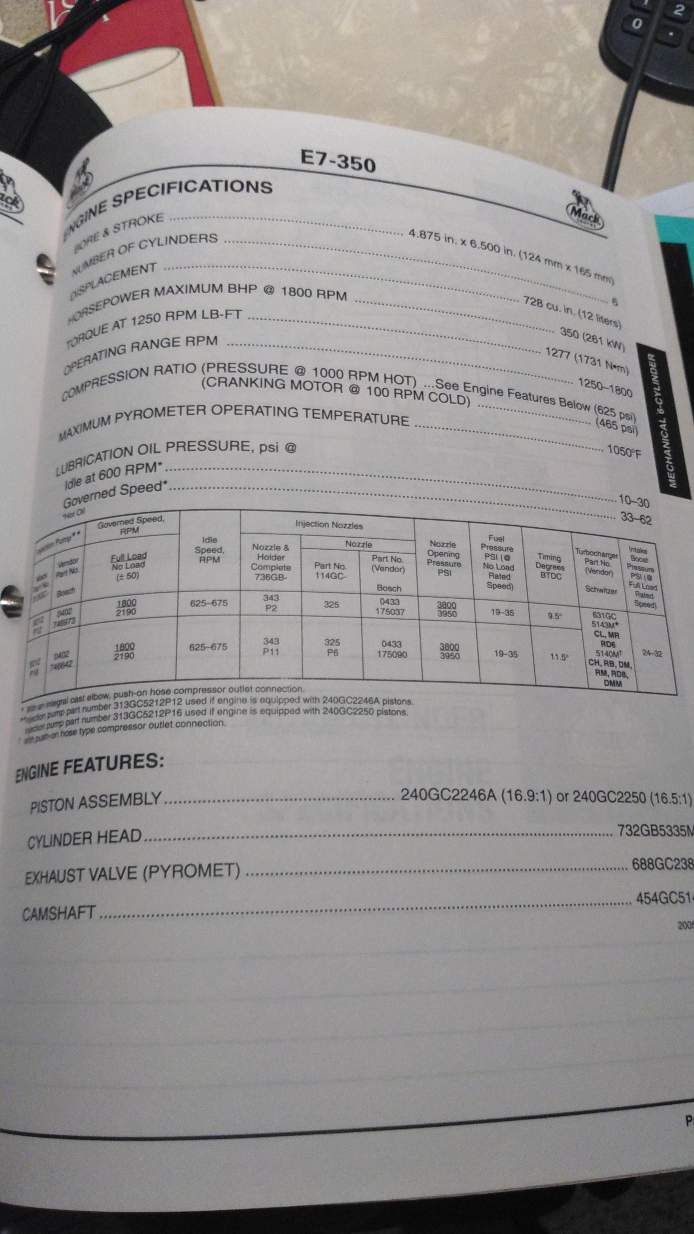

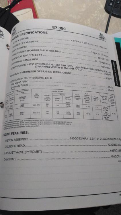

I'm looking for the initial injection timing. A follow up question: does the 1994 manual have information only for 1994 model year engines or does it go back a a couple years?
Edited by Calvin
https://www.bigmacktrucks.com/topic/72622-turn-up-e7/page/2/#findComment-540438
I have seen those set around 19 degrees..  I suggest you use the serch feature and try to read some older posts.  I cant tell you the answer with confidence..  Jojo
https://www.bigmacktrucks.com/topic/72622-turn-up-e7/page/2/#findComment-540441
I think 19 is a little high for a V-Mac from my reading. 19 is fine for a fixed timing mechanical E7 , mine is an electronic E7 with the econo-vance, everything I've seen has been said between 5-11, but I have yet to find the timing for my pump, my hp rating on a V-Mac 1

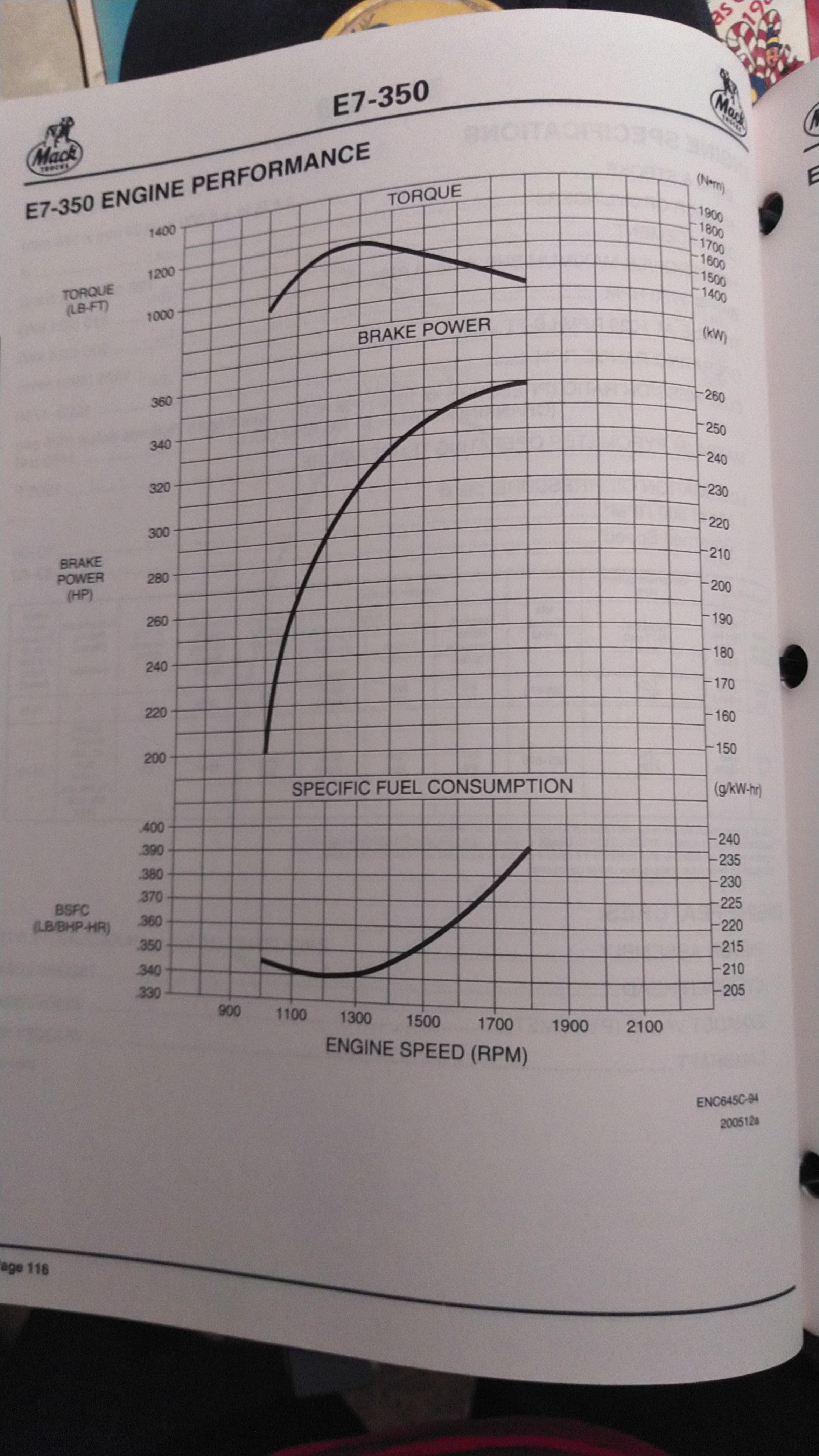

Hey Joey,  I've been digging around looking for that book. I have them from 1990 to 1994 and 2001 to 2006.
I can't find the spec books for 1995 thru 1999. Would you be able to show the pages with the 427 and 454 specs for the 1995 to 1997 engines?
https://www.bigmacktrucks.com/topic/72622-turn-up-e7/page/2/#findComment-562793
https://photos.app.goo.gl/fQ2CEdmL1LXxmWYU6
OK. I hope this works. It took me a bit..  the first 2 are from the '95 book....  the second 2 are from the '96/97 book
https://www.bigmacktrucks.com/topic/72622-turn-up-e7/page/2/#findComment-562799
I thank you for that Joey, and I appreciate your wealth of information.
Happy Thanksgiving guys.
https://www.bigmacktrucks.com/topic/72622-turn-up-e7/page/2/#findComment-562891
