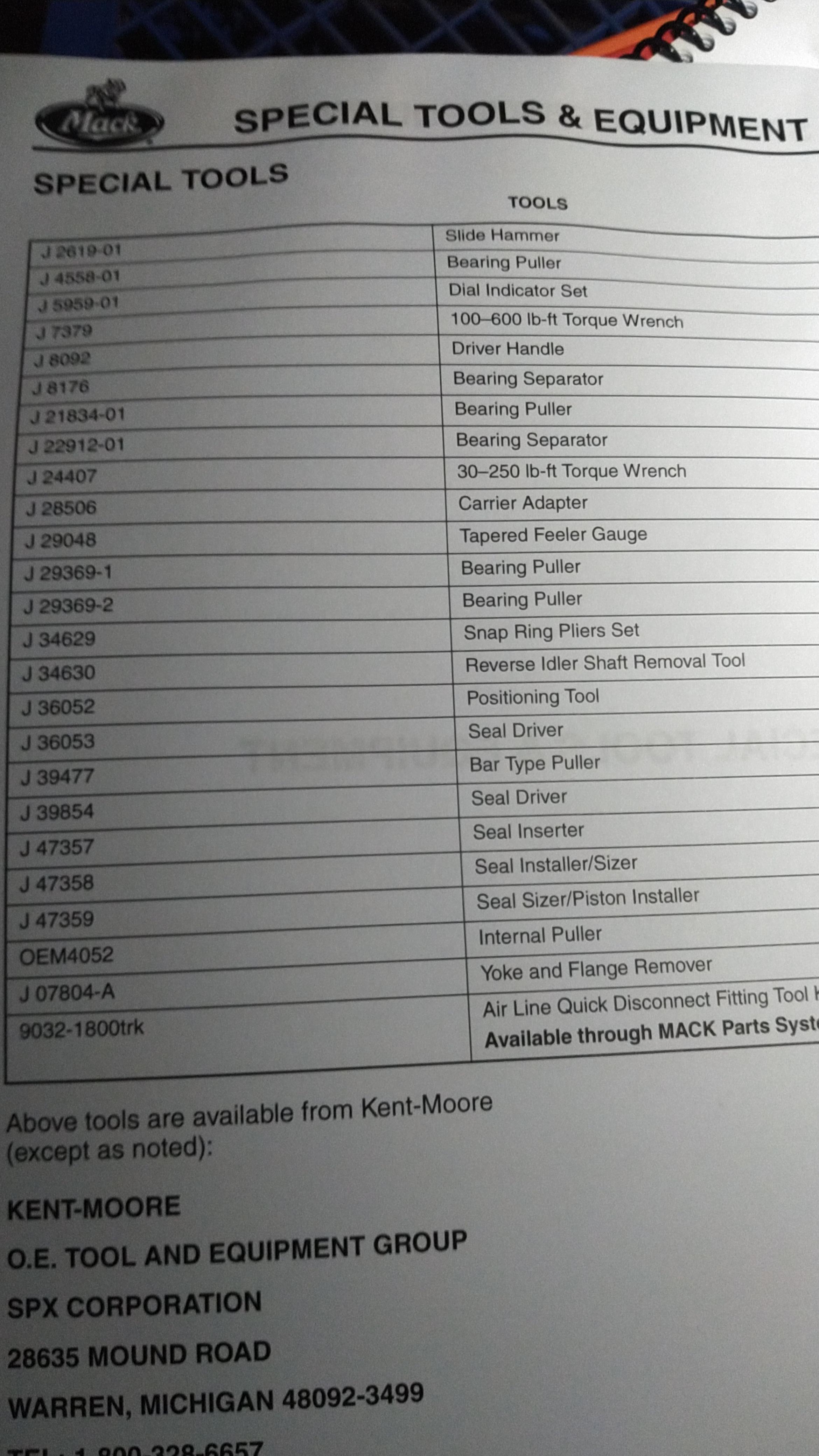

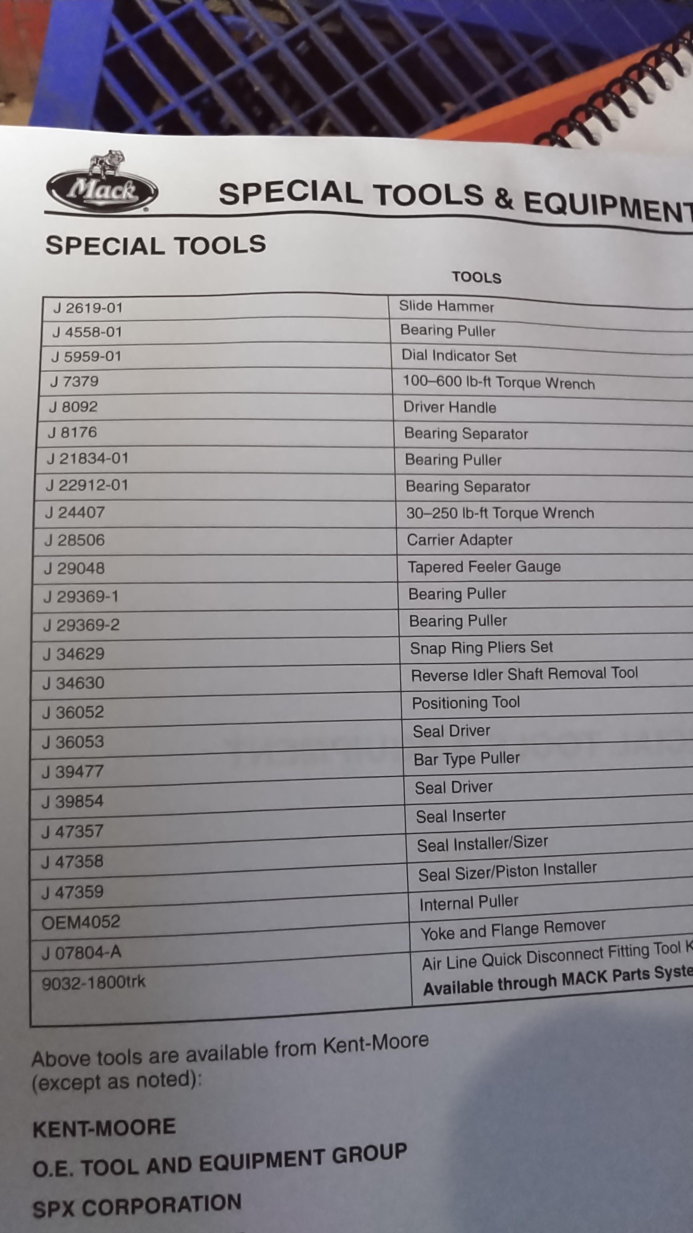

Here is the tool list right from the horses mouth..  2 copies to be sure you can read it..  T-300 tool list. you dont need all of them.. but if you plan to buy all of them....  a new tranny is cheaper..  :)

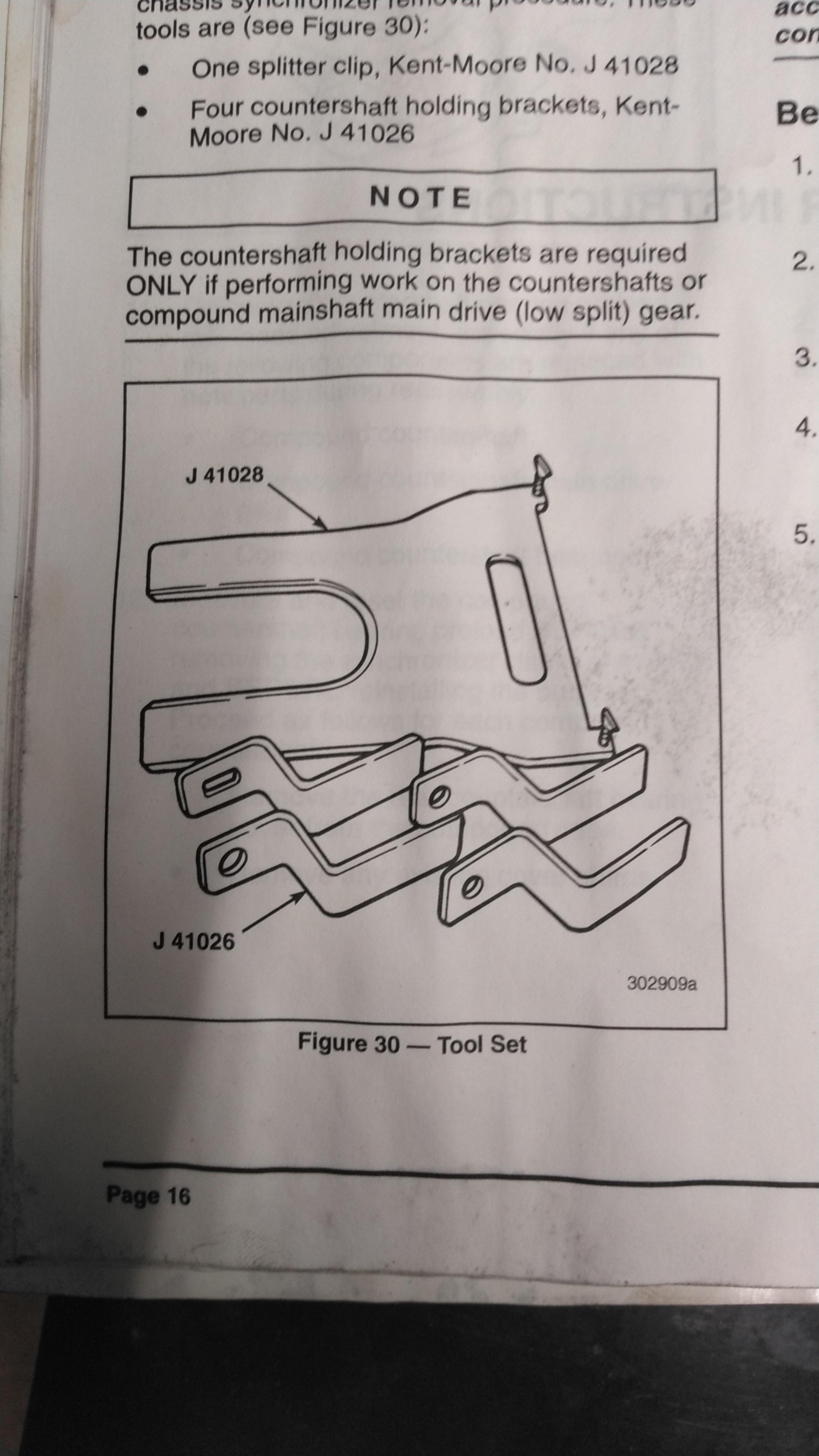

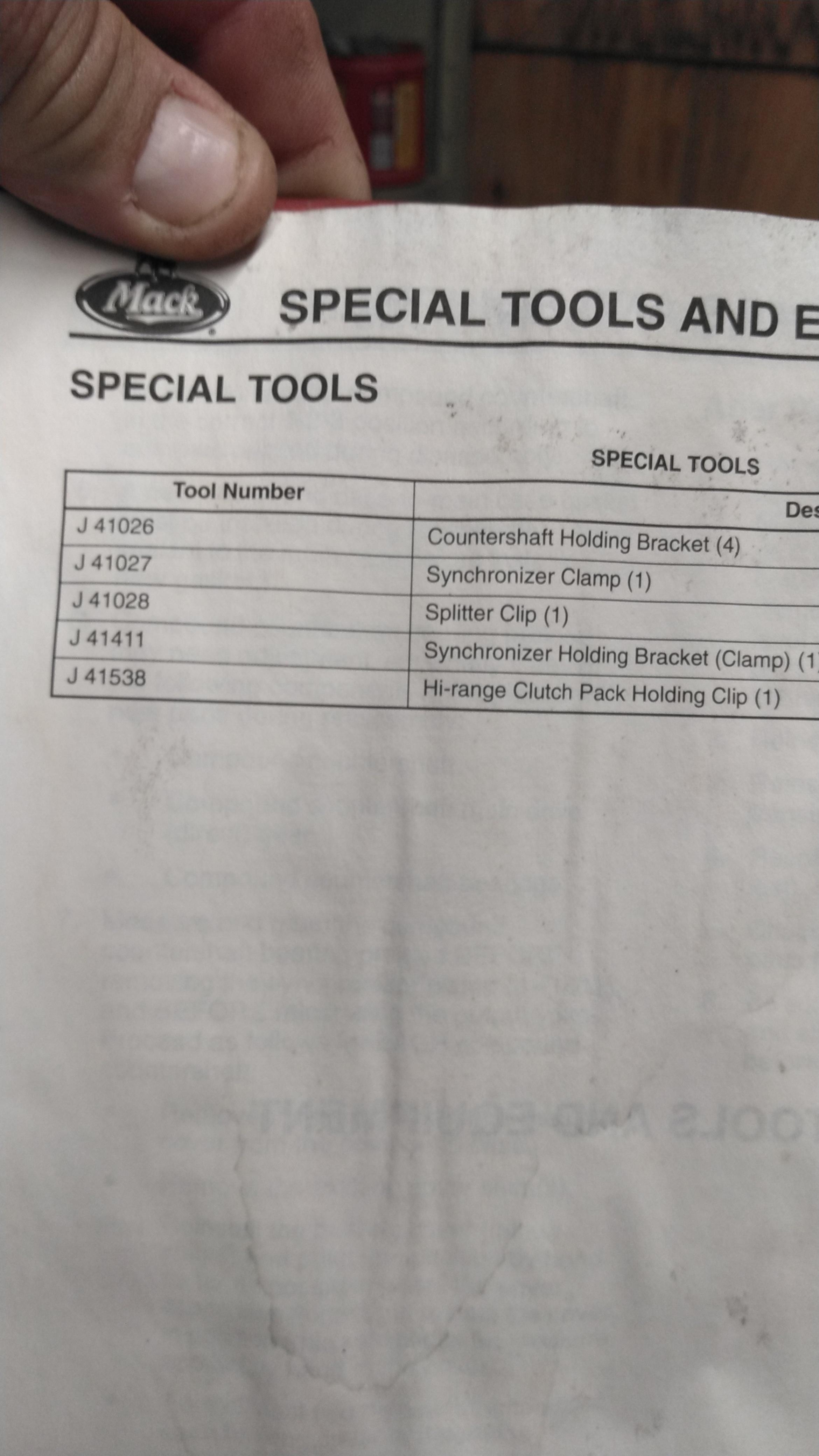

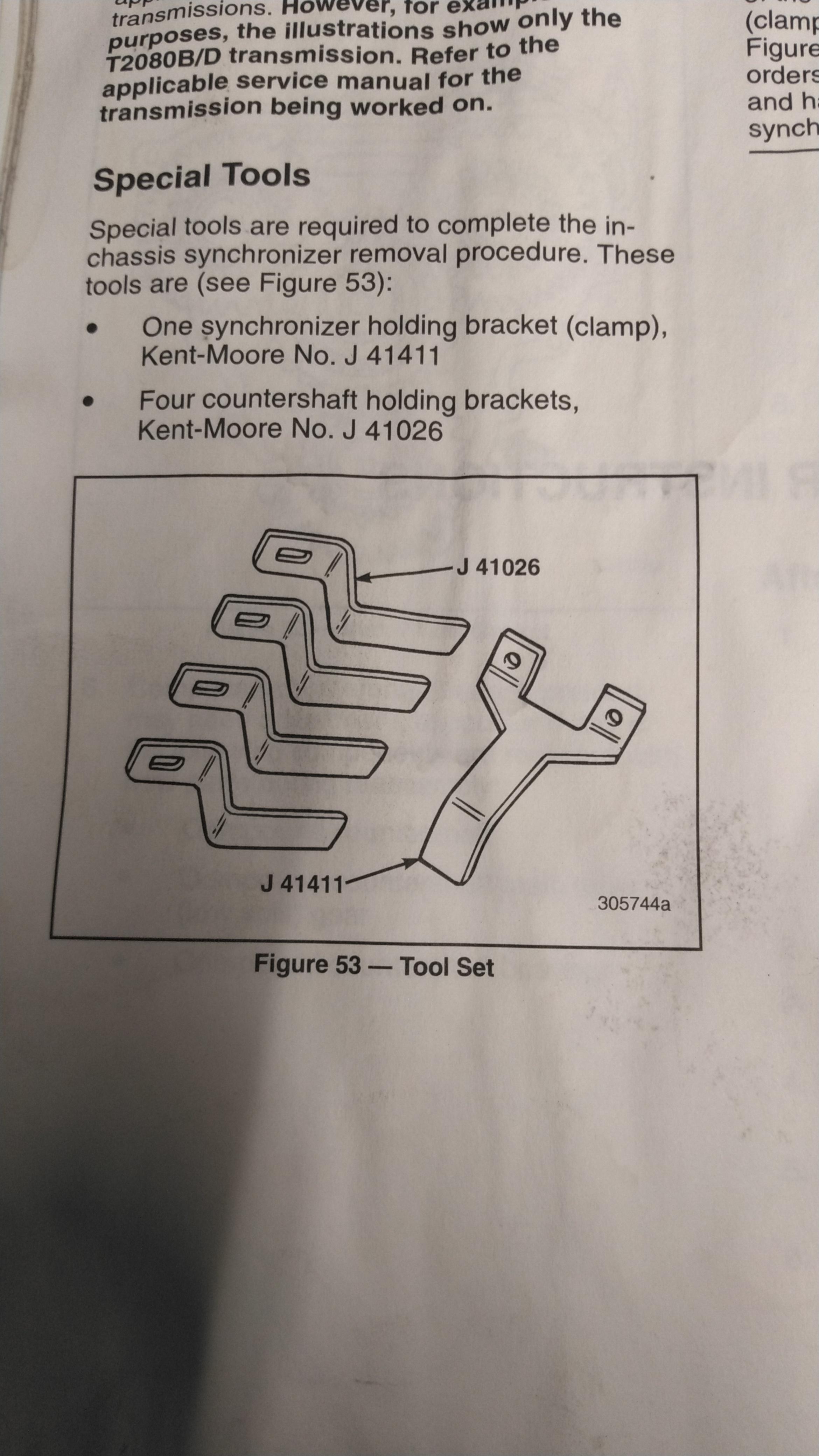

I know he needs the part number for the plate that holds the counter shafts, so you can pull the rear cover in chassis.. he will also need 4,,.  'Z' brackets to hold the counter shafts so he can remove the main shaft and synchro assembly..  I will try to get pictures when I get home later..
I knew I had the Mack in-chassis synchro book..  Here are the special tools to do the job.  the ''Z'' brackets can be home made, the holding plate costs more for a machine shop to make than it is to buy one..  Good luck,,  Jojo
