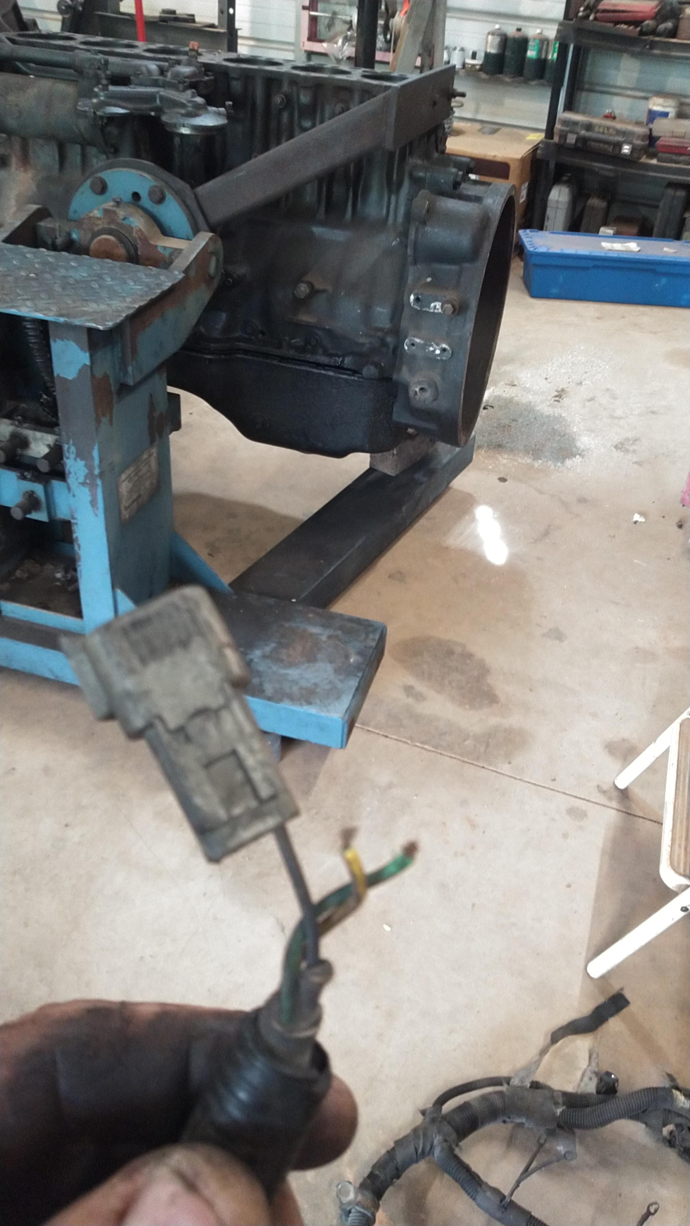

on the fire wall, by the steering column, is a gray wire with 2 or more wires.  it has a triangular weatherpack plug on it...  are the contacts and wires in good condition?  that is the 1939 line under the hood..  it is part of the engine harness..  here is an example from the engine I currently have in my shop.
Thanks Joey. Those wires I connected to 2 new temporary wires to the ecu as a test. No difference.. So I put everything back like it was. I'm thinking to buy the nexio usb link 2 with the 6 pin cable. What I saw is that the v-mac software is free Version 2.9.2. Only problem would be to get the proper config files for my vin#?

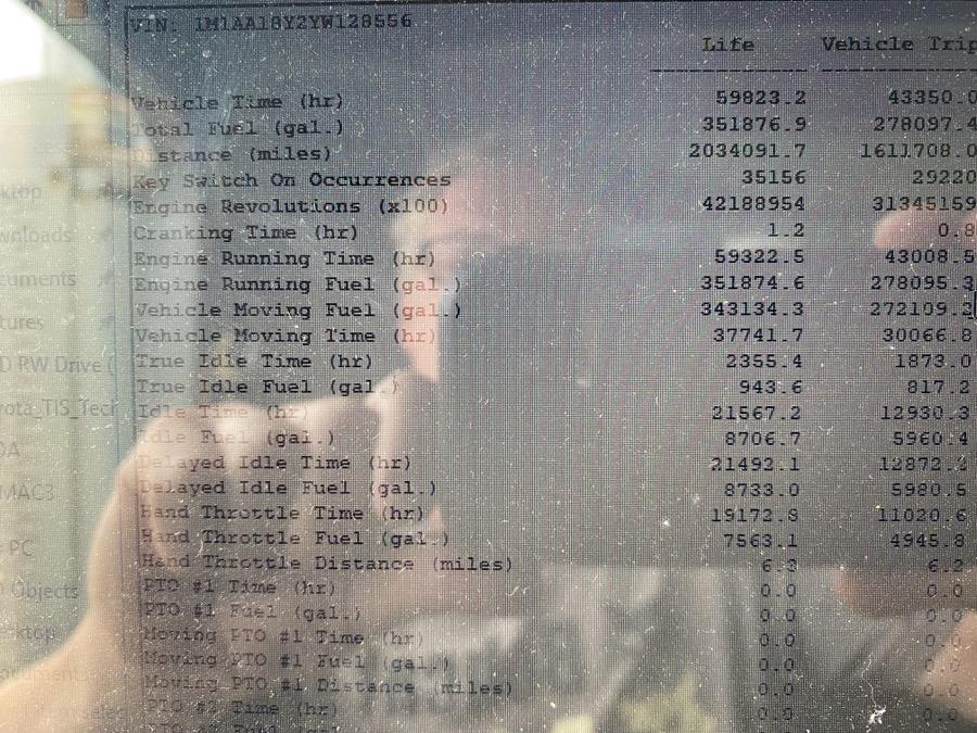

Thanks😃 some progress finally. got the scantool and it works! the vin in the ecu is not from my truck but it's for a e7 350. now im looking for someone with access to the mack dealer portal to get the proper files to program the ecu and vcu to my vin#.

Thanks! Meantime I disabled the limp mode by removing the mark on idle shutdown.... in V-macIII dealer programming. It runs awesome now :-) Except the error light is still on. I think and buy the M6 version of the vecu just to check. I can't see that there are many differences. And yes the vecu has nothing to do with HP etc.
