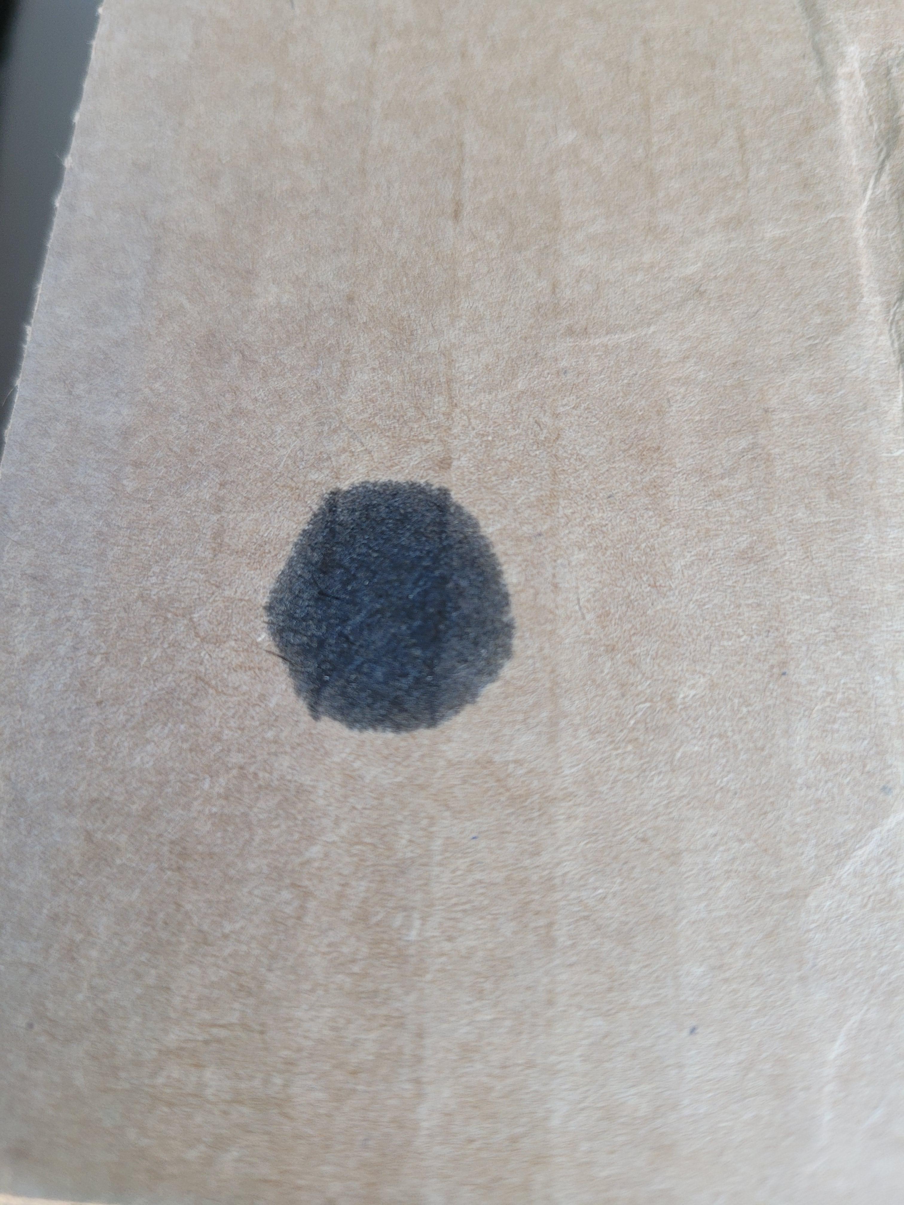

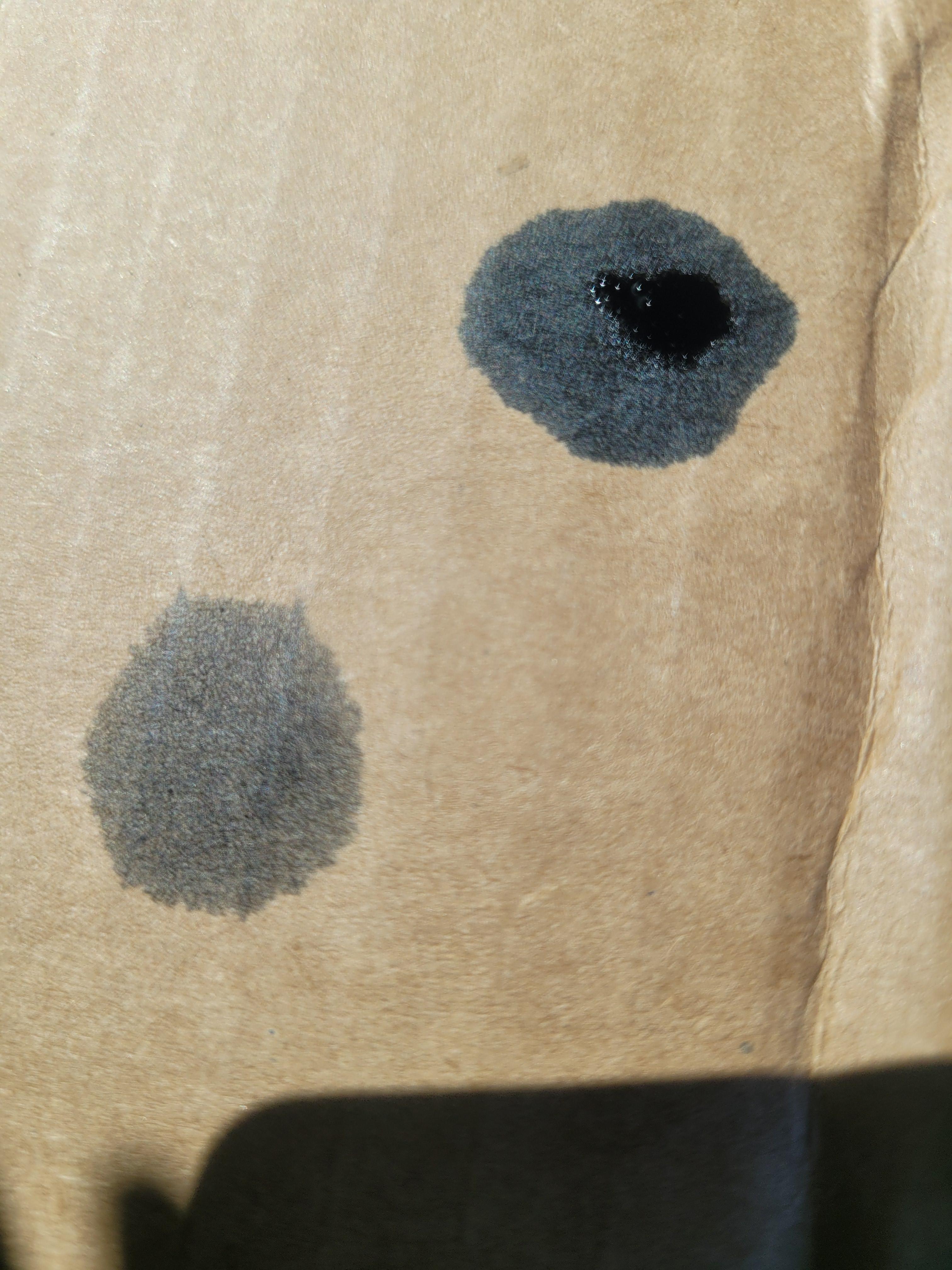

Yes too the oil analysis...  when you pull the dipstick does the oil run off like water?  You can do a halo test on a clean piece of card board to see if there is fuel in the oil.  I have posted this test before.. It is not better than an oil analysis, but it will tell you right now if there is a fluid other than oil in the crank case..

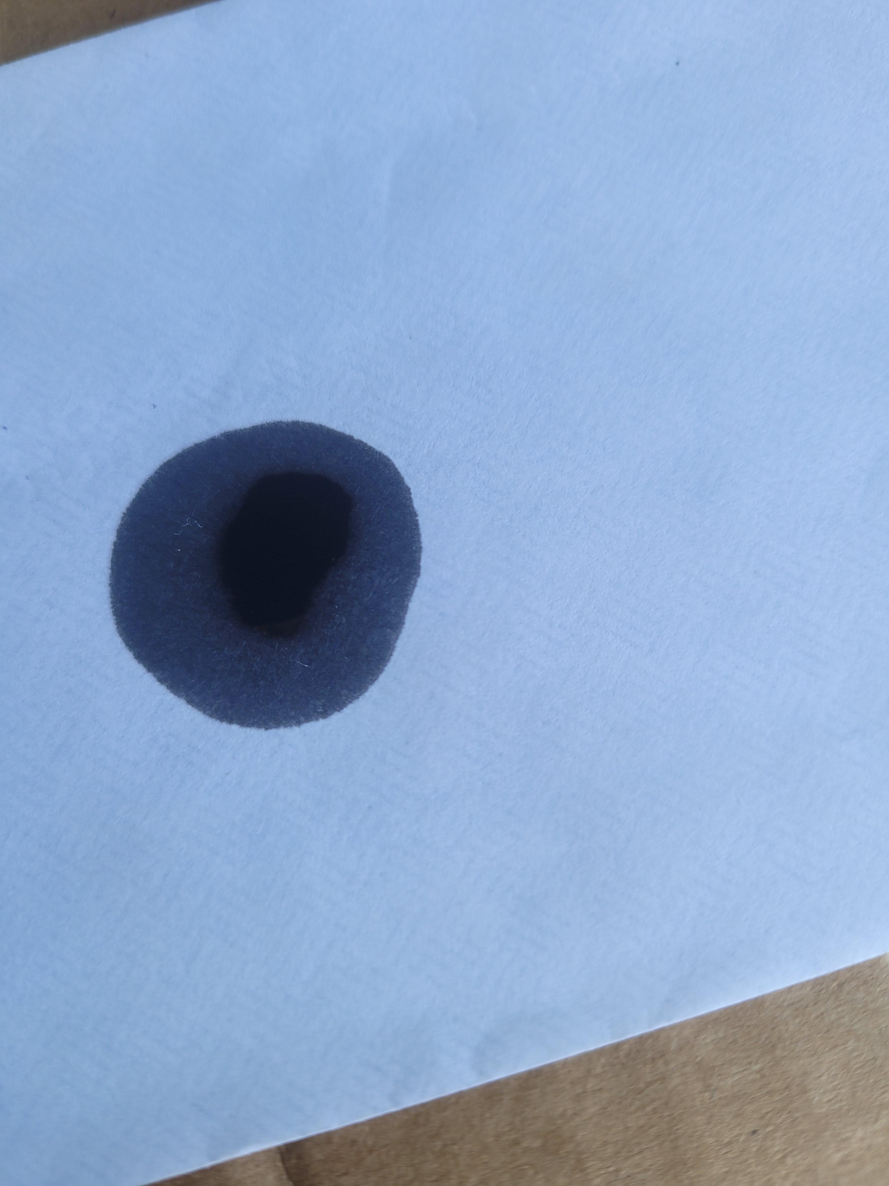

picture #2 looks like fuel dilution to me..  I prefer card board because it slowly absorbs oil and quickly absorbs fuel or water..  but you did good..   what does the back side smell like?
https://www.bigmacktrucks.com/topic/72701-oil-pressure/#findComment-528862
I see the difference..  nice illustration..  you have something in the oil..  likely its fuel..  an oil analysis is in order, as was stated earlier..
